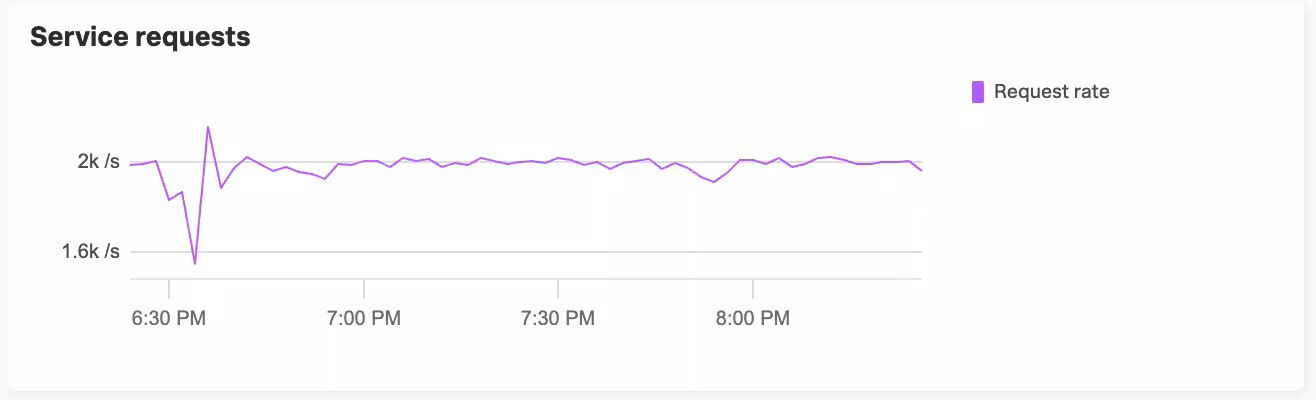

Again, things like service level views or tag views will show you the detail you need and distributions over varying timeframes.
The request rate is (mostly) stable.

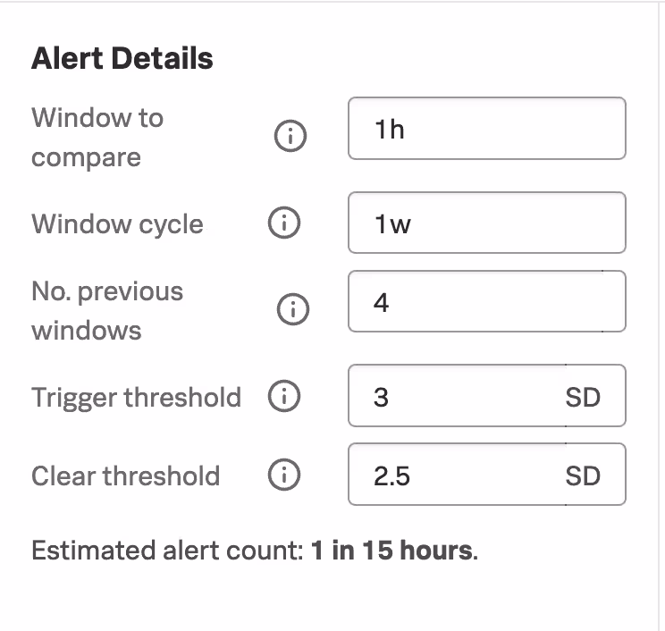

As an example, you could configure an Application Performance Monitoring (APM) detector that triggers when the request rate for the login endpoint goes three standard deviations outside the “normal”. Splunk Observability Cloud already builds the baselines for these metrics, allowing you to leverage simple thresholds to start with.
Configuration options for the APM detector.
In this case, we’re telling the APM detector to look at every hour and compare it to the same time over the last four weeks; if the results are more than three times the standard deviation, tell us. Three times the standard deviation is a fairly standard starting point for an “outlier” test, as it catches far-outliers in a normal distribution. As with all alerts, this needs periodic review and tuning, but it is a good starting point.
