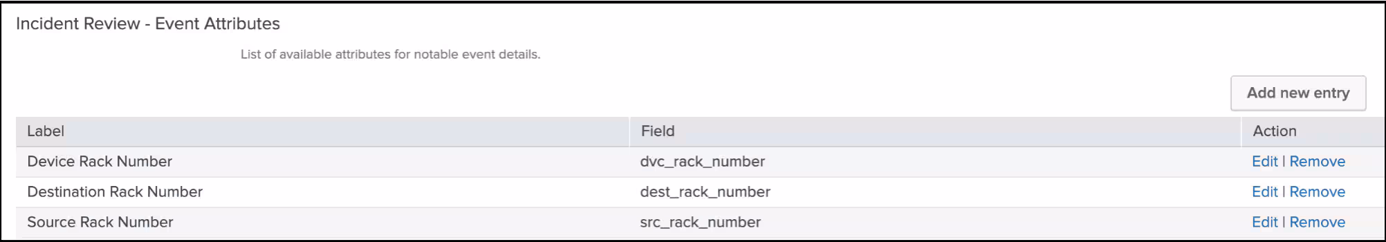

At this point, Steven, you are probably thinking you’ve got everything now, but alas that is not the case. There is one thing we will need to do to ensure the new asset fields are displayed in the notable events on the Incident Review page. If you are a regular reader of this blog, you may recall our post titled Modifying the Incident Review Page. If you don’t, no worries, we will wait for you. It will take less time than listening to “How Soon Is Now?
You’re back? Fantastic. Modifying the Incident Review Settings is very straightforward and can be found within Configure on the ES navigation bar. We have talked about assets being represented as the source (src), destination (dest) or as device (dvc) and the automatic lookups facilitate this. However, because the asset field could be any of those, we will need to create three entries in the Event Attributes list, as you can see below. The automatic lookup does the heavy lifting to automatically prepend dvc, dest or src to our asset fields. Once we have added the new fields to Event Attributes, we can click save at the bottom of the settings page.
Because the automatic lookup is accessing this data whenever a notable event is being viewed, we do not need to wait until new notable events are created and we can immediately see the rack number has been added to our notable! The analyst can see that the device 10.1.4.99, also called portal.thirstyberner.com is in rack 40-001 and if necessary could dispatch someone to that physical location. Obviously, there are many additional attributes that could be used with assets and identities but this is a fine place to start.
