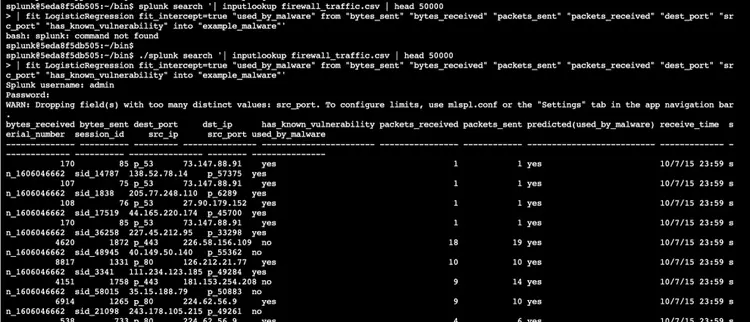

Using Splunk & the Splunk MLTK via CLI
Splunk Enterprise’s CLI supports app contexts and most search commands that have been installed by apps. An example of this is the fit command which can be used to build a model based the results of a Splunk search.
$ bin/splunk search '| inputlookup firewall_traffic.csv | head 50000
| fit LogisticRegression fit_intercept=true "used_by_malware" from "bytes_sent" "bytes_received" "packets_sent" "packets_received" "dest_port" "src_port" "has_known_vulnerability" into "example_malware"'
We hope you enjoyed this blog on how to integrate Jupyter Notebook with Splunk Enterprise. In part two, we'll cover some hands-on examples of how to leverage this configuration for machine learning and analytics.
