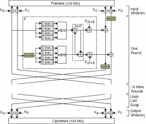

Twofish structure: how it works
The structure of the Twofish algorithm is as follows:
- A 16-round Feistel network is used. The key-dependent substitution box is generated and two functions G1 and G2 are defined. A 32-bit data input is divided into corresponding 16-bit data input to each block.
- Four subkeys are generated for the pre-whitening phase. An additional two subkeys for each round and finally, four subkeys for the post-whitening phase are generated.
- A plaintext undergoes a pre-whitening phase, where the Feistel round function is applied and the transformed data blocks are swapped.
- The MDS matrix combines the transformed output bytes at each S-box output and the final output of the round function block is combined using the PHT transform.
- The final Feistel round is applied without swapping and the post-whitening function is performed.
This algorithm structure is illustrated in the image below:
