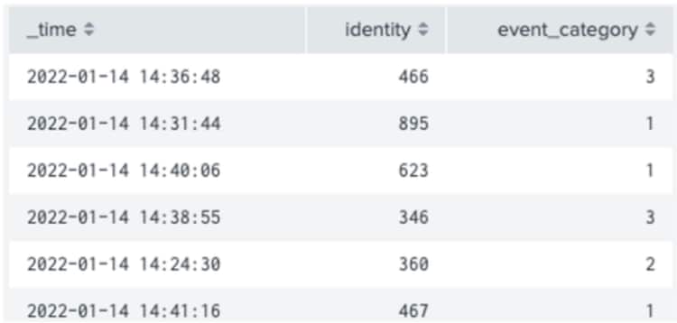

Input Data Table - Events with identity (hostname) and event_category (could be anything that we want to assess the likelihood of).

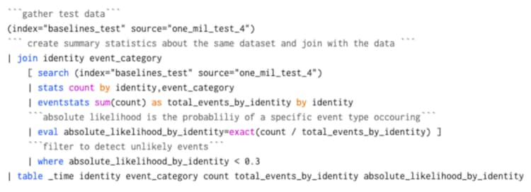

Search - Assesses statistics of dataset and joins back against initial dataset

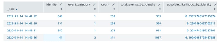

Output Data Table - A set of data with associated event likelihoods for each event category on each identity (host).
In this approach, we count up the occurrence of an event in our dataset by identity, using the "stats" and "eventstats" commands. We then "join" it against our search to work out how likely each event is for each identity. You'll get similar results using the "anomalydetection" command, and it's an equivalent level of computational effort as well. This seems to be a perfectly reasonable solution, and it is for small numbers of identities or categories and small datasets!

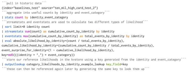

Above, you can see the search used to create our reference statistics by identity and event category. These are stored in a KVStore collection, using a custom _key field. This might be executed daily over several days/weeks/months worth of data in off-peak hours. You’ll need to create a KVStore collection and lookup definition to let you do this.

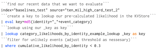

This second search then allows us to look up our pre-computed statistics for a given event and apply a threshold to find only the most unlikely ones. It can be scheduled to run very frequently, as all it does is look up a specific identity-event_category pair in the KVStore lookup we created above. We can then filter based on one of our calculated likelihood values. You could potentially even turn something like this into an automatic lookup, folding in relevant statistics about whenever your data is queried. Where we have no match on our lookup, we can surmise that we've never seen that particular identity-category combination before.
In this particular example, I've gone a bit further than the initial search and included a couple of different likelihood calculations, which can be helpful in a variety of use cases. I'll be breaking this down in more detail in some upcoming content. I've seen these kinds of likelihoods used for detecting anomalies in user behaviours (has this person done this before?), system behaviours (does this machine usually send traffic like this at this time of day?) and transactional analysis (do we typically ship this many units to these addresses?). A common approach to building out this kind of anomaly detection is to use these methods to define several different behavioural detections, which can then be aggregated to identify clusters of abnormal usage that might indicate a significant threat. This is similar to the approach taken by Splunk's RBA and UBA and, indeed, can be used in conjunction to build effective detections.
