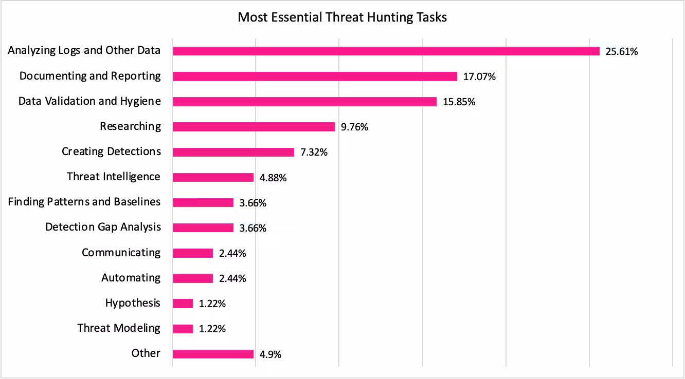

To start, we asked these threat hunters about their most essential tasks.
Figure 1: Most Essential Threat Hunting Tasks
Data analysis, validation & hygiene
Two of the top five essential tasks encompass data. As shown in Figure 1, we see:
- Data analysis ranked highest (25.6%), which is no surprise since this task is at the heart of threat hunting.
- Validation and hygiene — e.g., “cleaning” the data to make sure it’s correct, consistent, and in a state to be easily analyzed — came in third (15.9%).
Most data scientists would consider these tasks to be two halves of the same whole; taken together, they blow all of the other responses out of the water (41.5%).
For teams that align their operations with the PEAK threat hunting framework, these two actions fall solidly inside the Execute phase of the hunt.
Documentation & reporting
Coming in second on this list is documentation and reporting. This placement also makes sense because our hunts have the biggest impact only when we can:
- Write down how we did and what we found.
- Then share that information with other stakeholders.
In PEAK, these activities fall under the Act phase, and are key to generating the Knowledge that is not only crucial to good security decision-making, but also informs subsequent hunts.
Research
Next on the list is research (9.8%). This is slightly surprising, not because it’s on the list, but because of its position. Most hunts begin with researching a topic or tactic (it’s part of PEAK’s first phase, Prepare); jumping directly to data analysis is usually not recommended.
For this essential step to be ranked so low implies that many threat hunters may be skimping on the research, or even skipping it entirely.
Detection creation
Rounding out the top five is detection creation, another part of PEAK’s Act phase. While the hunt team may not always develop detections themselves, detections are one of the most common outputs of a hunt. One respondent put it this way:

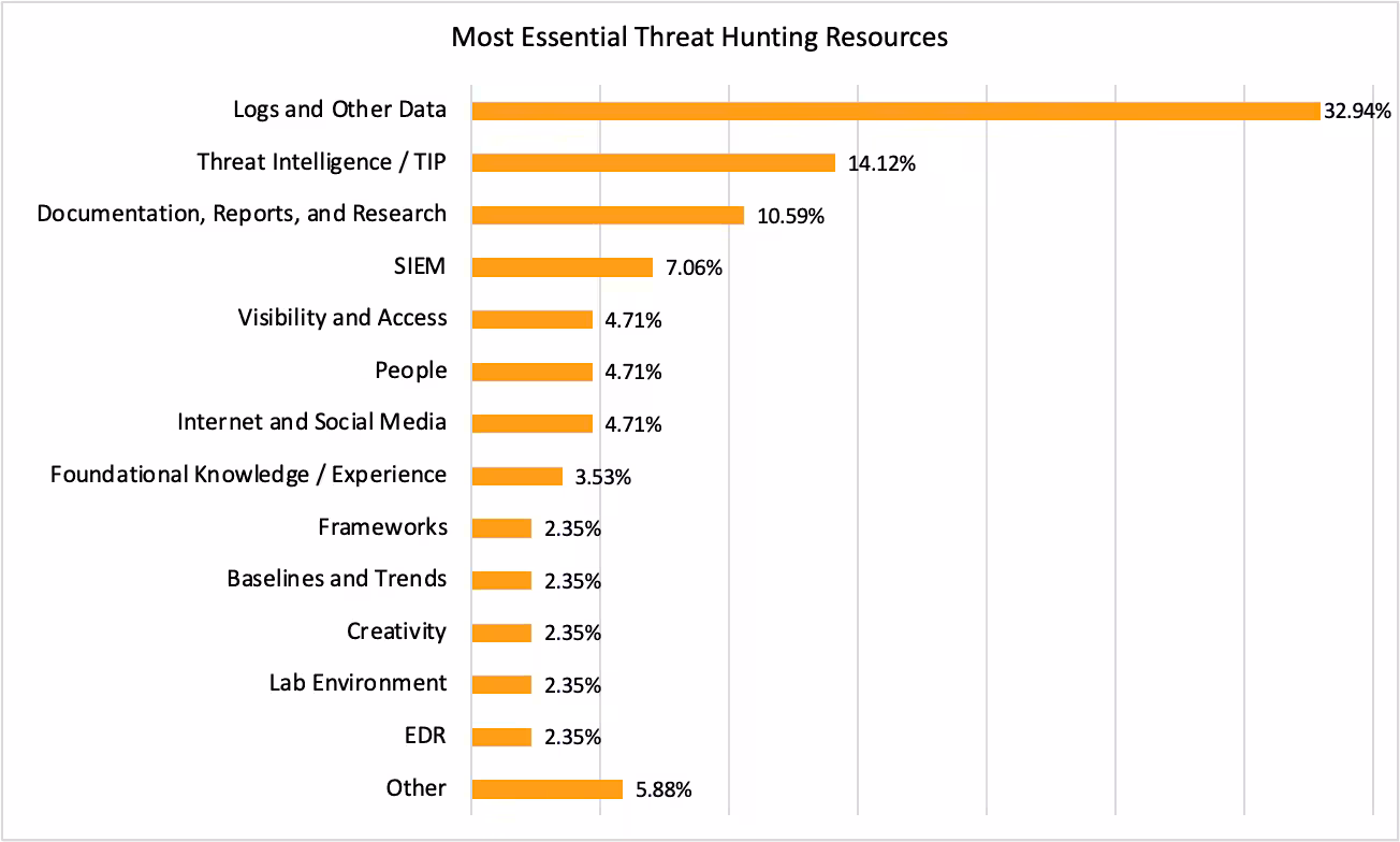

With our survey, we also wanted to find out what tools and resources threat hunters felt were the most essential.
Figure 2: Most Essential Threat Hunting Resources
Logs & other data
Logs and other data was ranked the most important resource by nearly a third of respondents (32.9%). Again, this is unsurprising given the nature of threat hunting, and we know that logs and other data are resource #1 for hunting.
The next two answers are perhaps more interesting.
Threat intelligence
Our respondents ranked threat intelligence as their second most essential resource. This implies that most threat hunts are informed, if not actually driven, by real-world knowledge of threat actors and their activities.
Although we did not specifically ask about it, this result is compatible with MITRE Engenuity’s concept of Threat-Informed Defense, which is good news for the cybersecurity community at large.
Documentation, reports & research
The next most essential resource was Documentation, Reports, and Research, a category that includes such items as:
- Gap analyses or other hunting recommendations from various internal sources.
- Custom dashboards or alerts from detection rules that aren’t quite reliable enough to send directly to the SOC (some organizations refer to these as “hunting alerts”).
Taken together, these serve as a complement to threat intelligence, sometimes referred to as friendly intelligence. This supports the idea that knowing your adversary is not enough — for the best security outcomes, you also need a detailed understanding of your own environment.

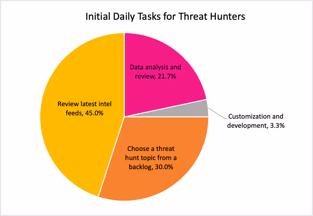

The beginning of a workflow often provides momentum for later tasks. Though we recognize that threat hunting is, by nature, flexible and may not have a well-defined daily structure, we were interested in what the first task would likely be.
Figure 3: Initial Daily Task for Threat Hunters
Almost half of respondents (45%) indicated that most days, their first hunting-related task is to review external sources such as:
- Blogs
- Intel reports
- News articles
This aligns with results from the 2024 SANS Threat Hunting Survey, in which well over half of respondents indicated that they leverage similar external sources to keep up-to-date on the latest threats. Although the SANS survey did not specifically ask about when respondents did this review, doing this as the first (or one of the first) tasks of the day makes the most sense from a workflow standpoint.

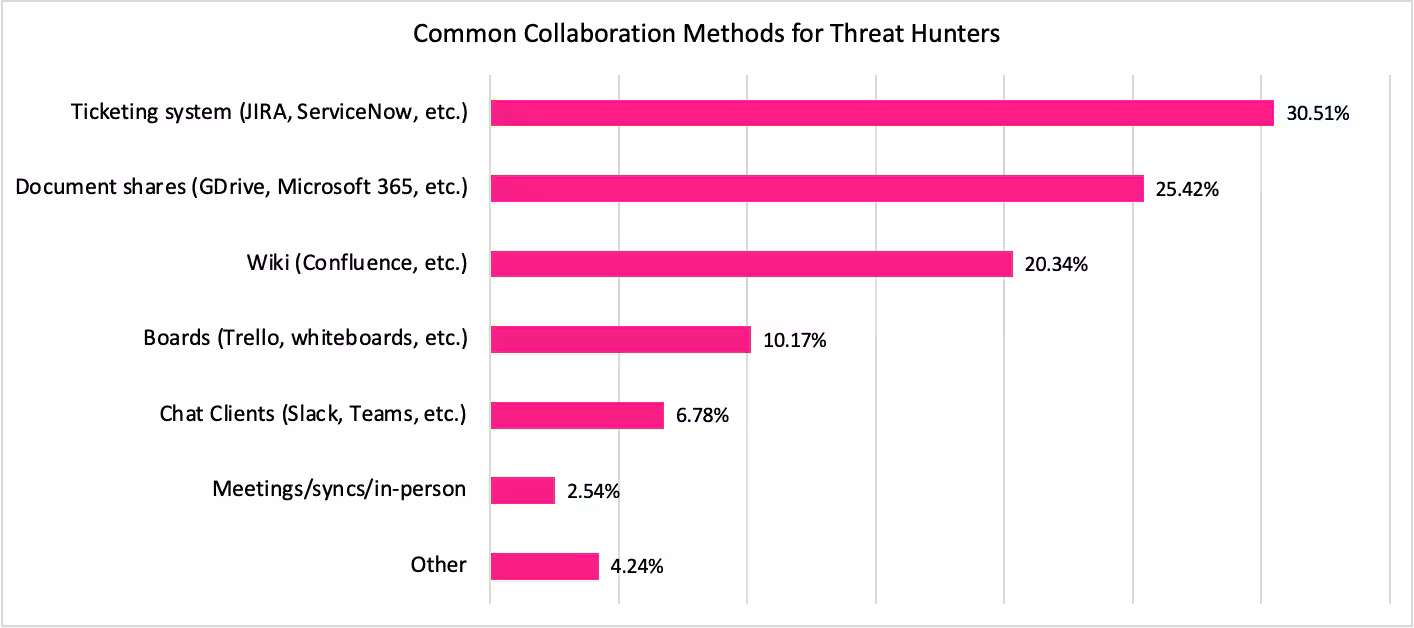

In our survey, we asked about the most common methods for collaboration with stakeholders during the hunt.
Figure 4: Common Collaboration Methods for Threat Hunters
Figure 4 shows that many respondents (30.5%) indicated that some form of ticketing system is their primary method of collaboration with other team members. This makes sense as ticketing systems make it easy to assign tasks and follow workstreams attached to tickets.
The second highest ranked method was Document shares (25.4%), with wiki platforms coming in third (20.3%). In fact, it seems as though these are often utilized as a set; many of our respondents (42.6%) indicated that they use some combination of two or three of these mechanisms.

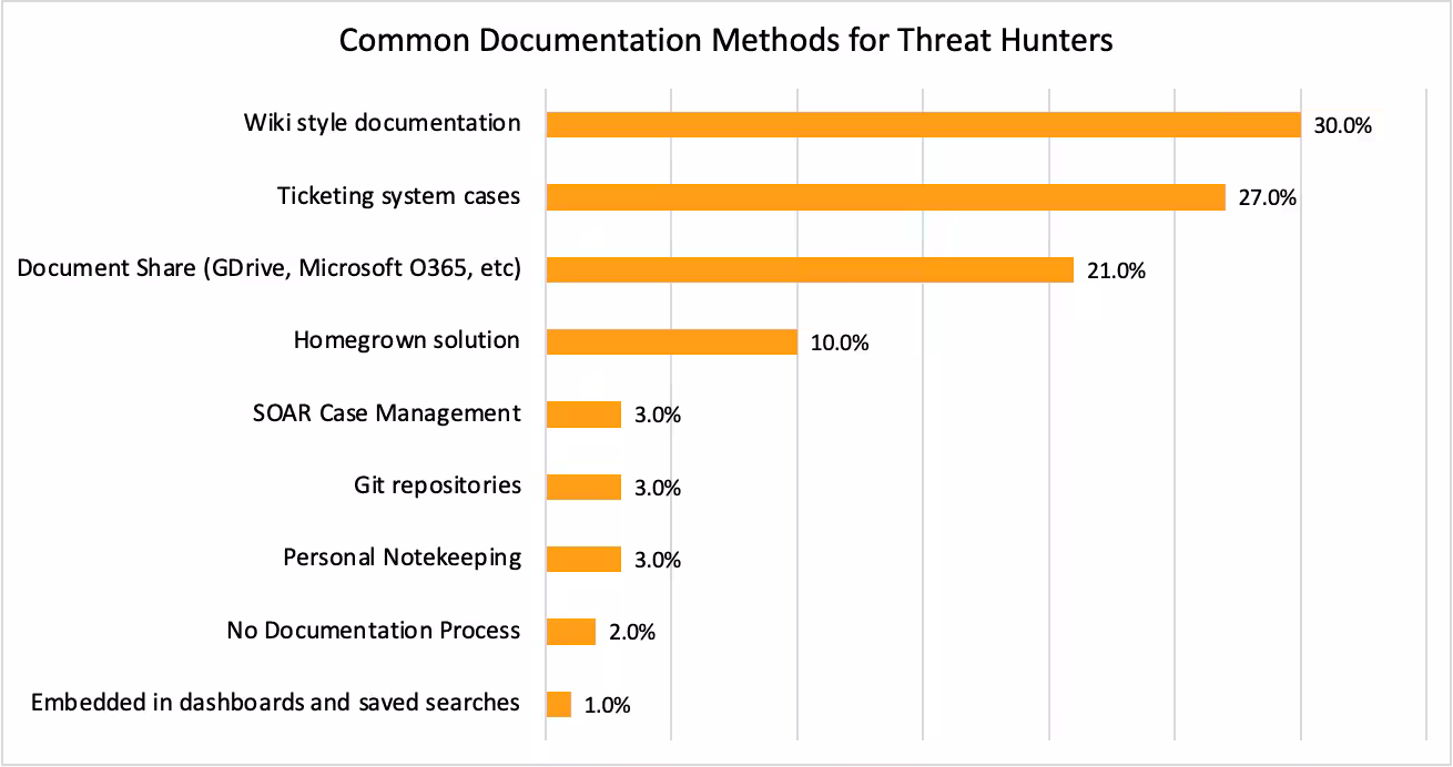

Collaboration is just as important after the hunt as it is during, and the most common form of post-hunt collaboration is hunt documentation — that is, recording what you did, why you did it, and what you found.
Figure 5: Common Documentation Methods for Threat Hunters
In Figure 5, we see that respondents indicated their most common platforms for post-hunt documentation:
- A wiki (30%)
- Ticketing systems (27%)
- Document shares (21%)
Interestingly, these were also the top collaboration tools used during the hunt, though in a slightly different order. Wikis come out on top in post-hunt collaboration but are only ranked third during the hunt. This probably reflects the tendency for documentation to be expressed in long-form text rather than task-based updates, and because the longer articles stored in wikis can’t be written until the hunt is finished (or nearly so).

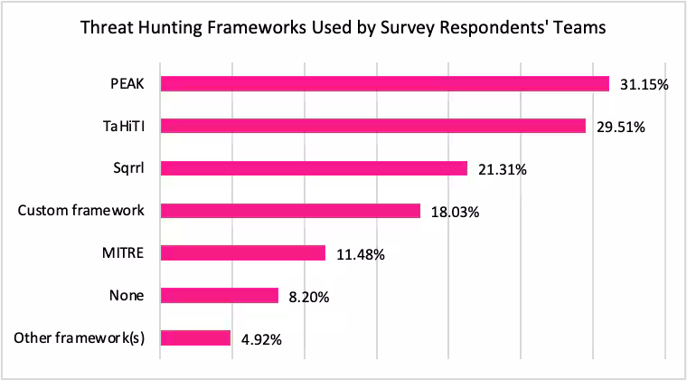

Creating or adopting a well-defined framework for threat hunting is important to help streamline your process. This is underscored by the fact that the vast majority of our respondents (77.0%) followed one or more of the published threat hunting frameworks (e.g., Sqrrl, TaHiTi, PEAK) or developed their own.
Figure 6: Threat Hunting Frameworks Used by Survey Respondents’ Teams
Summary of key findings
The results of our survey show that data is king. Analysis, validation, and hygiene are not just everyday tasks — this tasks are the heart and soul of threat hunting. Even so, research may not be getting the attention it deserves. As one of the central activities in hunt planning, organizations would do well to emphasize the importance of research when prepping a hunt.
It's also clear that threat hunting doesn't happen in a vacuum. Threat intelligence and internal documentation are the two largest parts of PEAK’s Knowledge component for good reason: they are the foundation of a threat-informed defense that's grounded in a deep understanding of one's own environment. Collaboration, both during and after the hunt, is also crucial to success, with ticketing systems, document shares, and wikis emerging as the tools of choice.
Perhaps most importantly, our survey highlights the value of structure and process. The widespread adoption of threat hunting frameworks, whether off-the-shelf (e.g., PEAK, Sqrrl, or TaHiTi), custom-built, or a combination of these, shows that organizations are actively looking for repeatable processes and trusted standards in this area.
