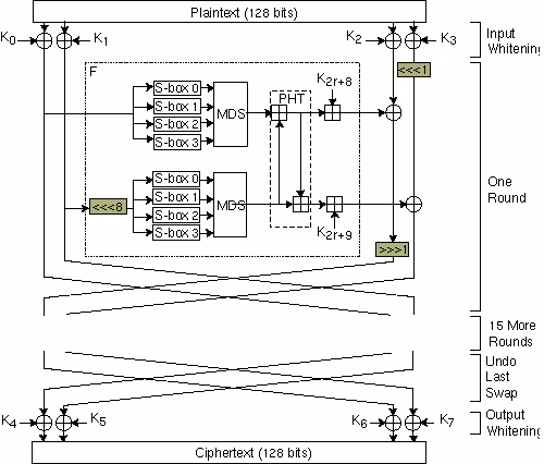

Twofish structure: how it works
The structure of the Twofish algorithm is as follows:
This algorithm structure is illustrated in the image below:
(Image source)
