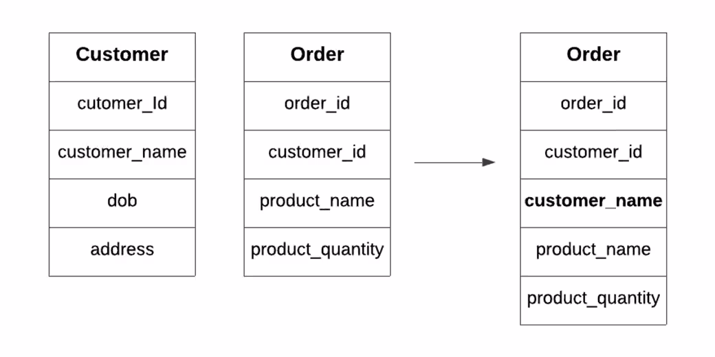

For example, pretend that you run an online shop where customers can order products. Such an e-commerce platform typically contains customer data in one table and order data in another. The order data table contains a foreign key to the customer data table to relate to customer information.
Suppose the website needs to display all orders placed by a customer. A normalized data store would require a join between the orders and customer tables to achieve that. Imagine the online shop got a high volume of orders and customers. In that case, this join operation could be computationally intensive and slow down the performance of the website.
In this instance, we can introduce data denormalization to improve performance in such circumstances. You can either:
- Add a customer name column to the orders table.
- Introduce a separate table and merge the data from two tables.

Technique 1. Introducing a redundant column/Pre-joining tables
This technique can be used when there are expensive join operations and data from multiple tables are frequently used. Here, that frequently used data will be added to one table.
For example, let’s say there are two tables called customer and order. If you want to display customer orders along with their names, adding the customer name to the order table will reduce the expensive join operation. However, it will introduce massive redundancies. Here's an illustration:

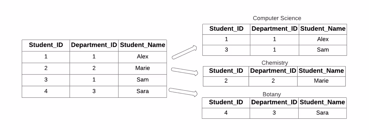

Horizontal table splitting
Splitting table rows into smaller tables. Each table will have the same columns. This approach is useful when data tables can be separated based on regions, physical locations, tasks and many more scenarios.
For example, imagine a table containing student information for all departments in the science faculty of a university. As the diagram illustrates, this table can be split according to each department, such as computer science, chemistry, maths and biology.
Here, only a smaller data set will have to be queried compared with the original table. Thus, this technique enables faster query performance for department-based queries.

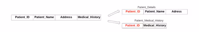

Vertical table splitting
Vertical splitting is splitting a table based on columns, applying the primary key to each partition.
For example, think that a hospital maintains a ‘Patients’ Table with patient ID, name, address and medical history columns. We can create two new tables from it using vertical partitioning: ‘Patient_details’ and ‘Patient_medical_history,’ as shown in the below figure.
This approach is best suited when some table columns are frequently accessed more than others. It will allow getting only the required attributes, eliminating unnecessary data.
