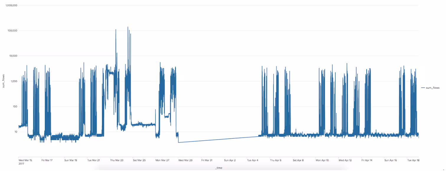

Starting with a time chart we can view the total number of flows to and from this IP address with the following search:
| tstats sum(Flows) as sum_flows WHERE (index=cidds "Src IP Addr"=192.168.220.15) BY _time span=5m
Time Chart
It is important to note that this chart has been plotted against a log scale - there is a high degree of variance in the number of flows, and the baseline behaviour is much easier to see on this scale. Please see this great link to brush up on your knowledge of logarithms. We can see from the visual that there is a pattern of activity during weekdays and weekends, with increases during the daytime for a weekday and limited activity over weekends. There is also a period of complete inactivity, which suggests a maintenance window for this server or network device. In reality this is a gap in the CIDDS data caused by a power cut at Coburg University over a few days when they were generating the data!

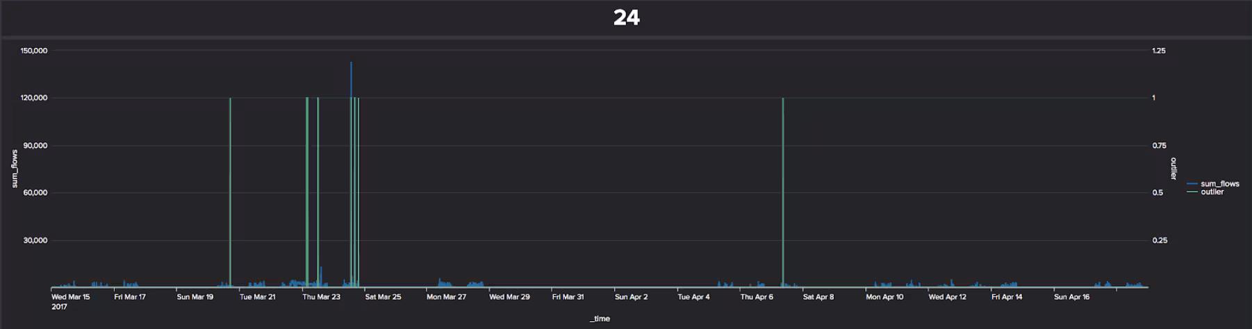

Baseline 2: Using Probability Density
Another method for determining a baseline for your data is using the Density Function. This is similar to the search using averages and standard deviations above, but can model more complex data. The search below demonstrates how to apply this technique:
| eval HourOfDay=strftime(_time, "%H"), DayOfWeek=strftime(_time, "%A")
| eval Weekday=if(DayOfWeek="Saturday" OR DayOfWeek="Sunday","No","Yes")
| fit DensityFunction sum_flows by "Weekday,HourOfDay" as outlier into df_192_168_220_15 threshold=0.003
Density function
In the results here - with a threshold of 0.003, which is equivalent to three standard deviations if the data is normally distributed - we have significantly less anomalies than from the previous technique. Note that the majority of the anomalies occur in the second week of the chart, as for the first approach.

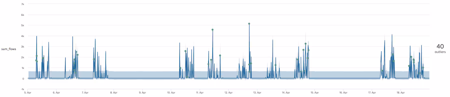

In the visual below you can see the results of the fit command on the training set, which is the later two weeks of data in the CIDDS data set - i.e. the data from the 5th April onward.
CIDDS data set chart
When applying our trained model to the first two weeks of data we produce the chart below - where there are significantly more outliers (as seen when applying both of the previous two techniques).
Chart
Although we are generating many more alerts than our previous methods we are also modelling much more complex data with this model. For this example we may have produced an overly complex model, where the simpler techniques outlined above are more appropriate in this instance.

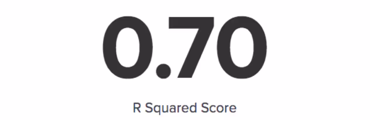

It is not just the count of outliers that is of interest here. We also need the accuracy metrics from our second stage where we apply the data. We can see that we are getting an R2 or R-squared score of around 0.7, this suggests our predictive model is 70% accurate. R-squared is a statistical measure of how close the data are to the fitted regression line.

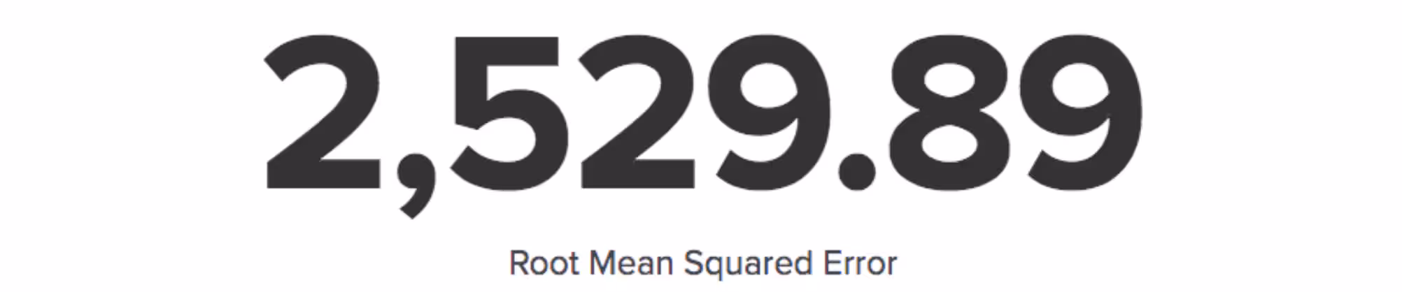

We are also getting a root mean squared error of around 2.5k, which tells us that our predictions are usually within 2.5k out from the actual values. Since our data goes to almost 150k in some places this isn’t too bad!
