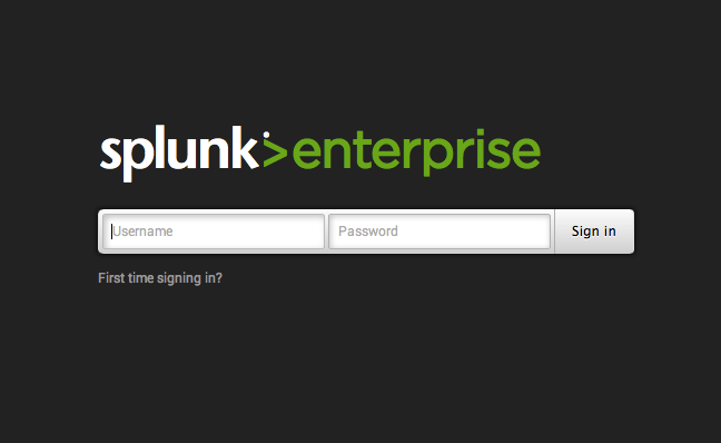

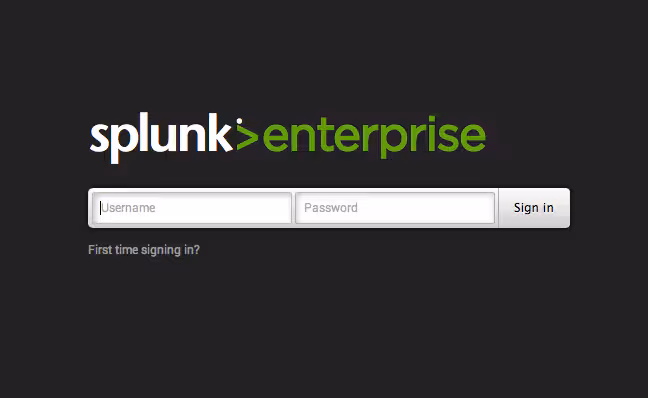

First, download Splunk 6 from our download site. Install using the documentation and default settings. Once Splunk is installed, you should open a browser and go to http://localhost:8000. You will be presented with a login page. For the first login use the username “admin” and password “changeme”.

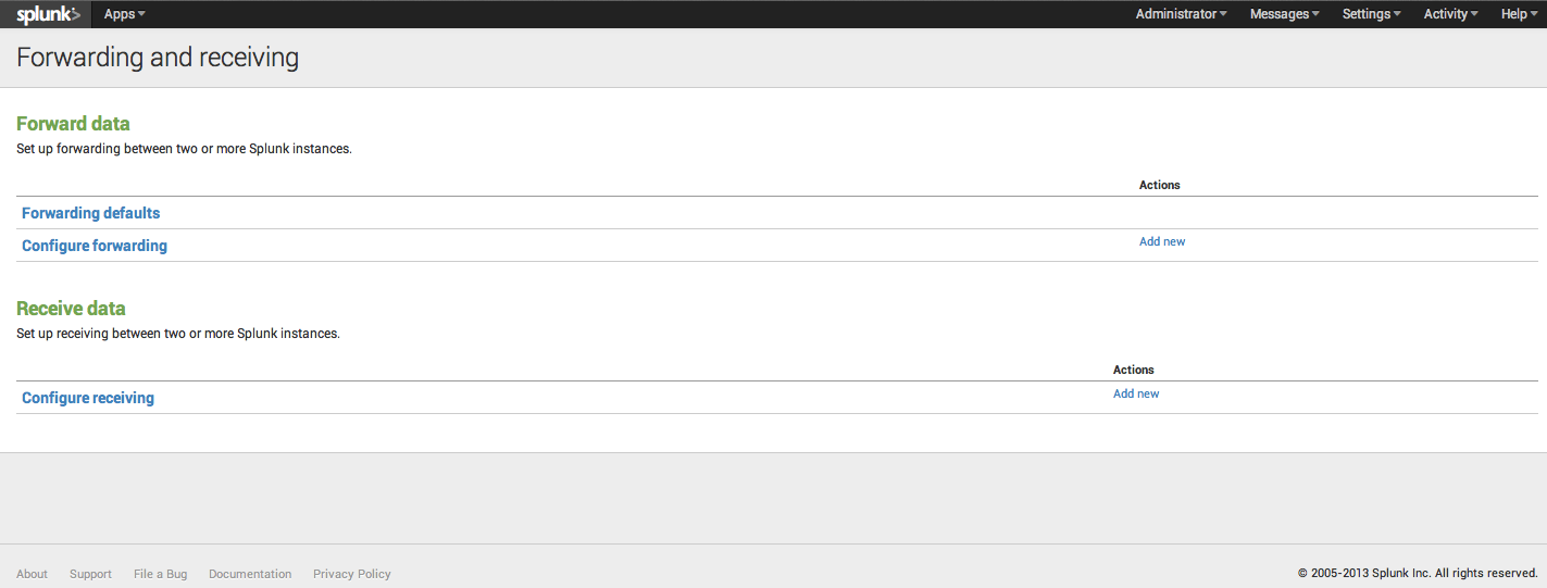

In the upper right, click the dropdown for “Settings”. Under Data, click Forwarding and receiving, and you will be taken to the configuration page where you can set Splunk to listen for data from your Pi.

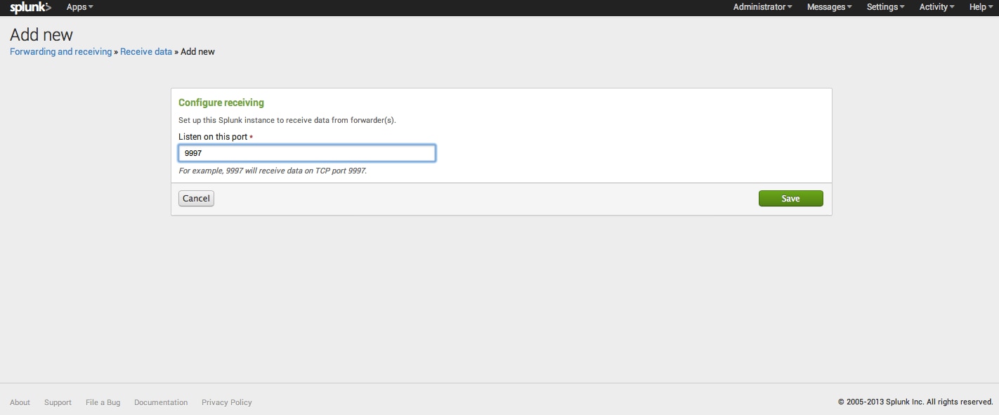

Click “configure receiving”, and you will be taken to the receive data configuration page. Assuming this is a brand new installation of Splunk, you will have no configurations. Click “New” and you will be taken to the new configuration wizard. For now, we will just add a new listener at port 9997, and click Save.
Splunk is now listening for data from a Splunk Universal Forwarder on port 9997. You will need to make sure that the machine your Splunk instance is running on has the appropriate firewall ports open. Congratulations, your Splunk instance is ready to receive data from your Pi!
