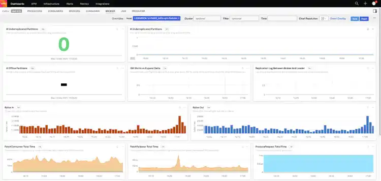

Fig 1: Performance metrics for a specific broker

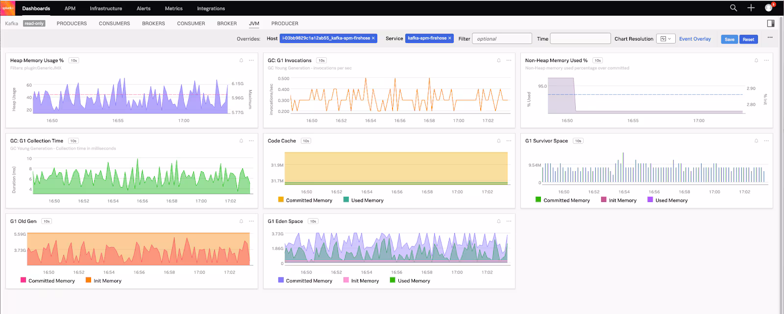

Java Virtual Machine metrics are collected using MBeans via Java Management Extensions (JMX)
Fig 2: Java Virtual Machine performance metrics

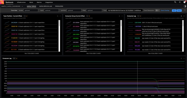

You can instantly start monitoring consumer lag metrics within Splunk Infrastructure Monitoring:
