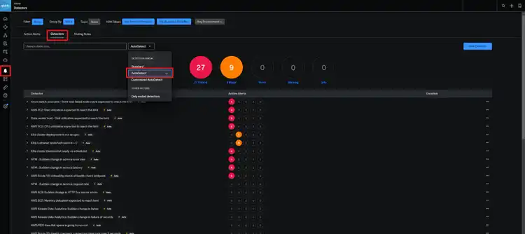

Depending on the datasets you’ve integrated, a list of detectors will automatically be available once you start sending data into Observability Cloud. While you’ll only see AutoDetect detectors for the active supported integrations in your environment, there’s an exhaustive list of available detectors. You can always check which AutoDetect detectors are available to you by navigating to the Detectors page, then to the Detectors list and use the filter to show only AutoDetect.
Some AutoDetect detectors will use dynamic Machine Learning (ML) based thresholds to help ensure the accuracy and relevancy of alerting conditions across a variety of systems and services. Having a per-entity-based approach to historical anomalies, sudden deviations and capacity limits goes a long way to reduce the complexity and sprawl of the detectors users need. Every service, for example, will have a different baseline of normal operating conditions and could result in bespoke detectors being created for every service even if we’re looking for the same symptoms. Splunk Observability Cloud lets you create a single detector to alert on scenarios where services are experiencing abnormal latencies or error rates across all the services you want to keep tabs on.
Filtering to see AutoDetect detectors available in your environment

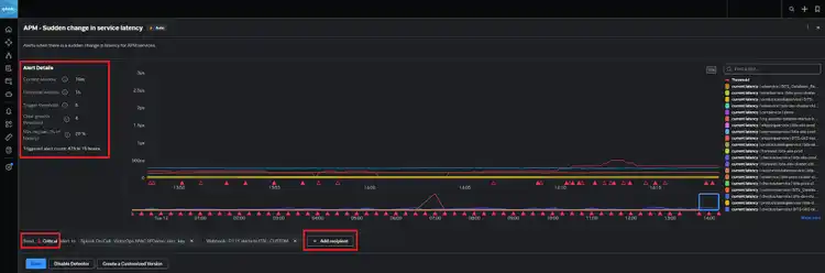

While the AutoDetect detectors will be automatically published, alerts will only be sent once a subscription is created for that particular detector. The last thing you want is alerts sneaking up on you! Subscribing to a detector is simple. First, navigate to the one you want to receive alerts from, review the OoTB conditions, and set the threshold and recipients as desired. Let’s say you wanted to subscribe to the Application Performance Monitoring (APM) Sudden Change in Service Latency detector, clicking on the detector from the list gets you into the review pane.
Subscribing to APM Sudden Change in Service Latency AutoDetect Detector
This pane details the logic and conditions, the entities in scope (services to be considered for latency changes in this case), and a preview of historical thresholds along with a simulation of how many times an alert would have been triggered.
You can see in this specific scenario though that we have quite a large number of services and that without any filtering it will be sending off alerts to the recipients listed for every service in our environment. To avoid having all alerts ignored and to reduce MTTR, we’d need to create a customised version to limit the scope down to the entities (in this instance services) that each particular person or team is responsible for.

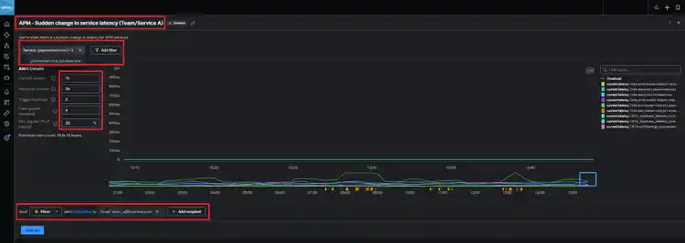

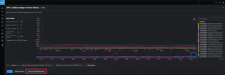

Thankfully, AutoDetect is designed for this exact situation. Users can create a customised version of an AutoDetect detector without modifying the base detector itself. This allows the customisation and tuning of alert conditions, as well as the severity and recipients for any triggered alerts, which is built on top of the query that is provided and managed by the platform. Simply put, every person or team can tune and filter it to what they need, without ever worrying about the underlying search. To start customising an AutoDetect detector, click on ‘Create a Customised Version’ from the same summary review pane we navigated to above.
Navigating to the Create a Customised Version of an AutoDetect detector configuration pane
From here, we can give it a new name so it’s easily identifiable, filter the scope down to any tags/dimensions we like, fine-tune the alert conditions, specify an appropriate severity, and add the right recipients to action alerts as per the filtering. Once the tuning and filtering have been set, a new preview is generated from historical data to simulate how many times an alert would have been triggered based on the updated conditions.
A customised AutoDetect detector with narrowed and fine-tuned configuration
Now we’d only trigger alerts when we expect them to be triggered. We can visualise which entities are included in the dataset, and alerts will only go to the recipients that need to receive them. This is just one example of how users can reduce false positives and negatives, and remove unnecessary alert noise.
