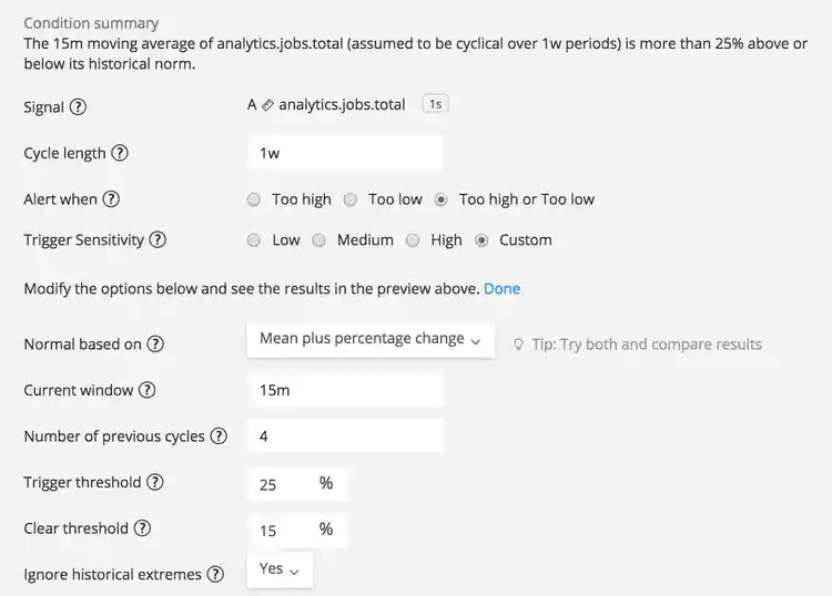

All of the built-in alert conditions require the user to select a Signal to monitor; in this case we have chosen the total number of jobs across a cluster. We must also choose whether to alert when the signal’s values are too high, too low, or either too high or too low (the Alert when parameter). Too few jobs may indicate users are having trouble accessing the application, whereas too many jobs may indicate a need to increase capacity, so in this case either extreme could pose a problem.
There is also a Trigger sensitivity parameter which roughly corresponds to the number of alerts: higher sensitivity will typically result in more alerts. The sensitivity is really a shortcut for several of the parameters which we’ll discuss shortly.
Suppose we wish to compare values recorded on Monday at 10 a.m. with the values recorded at 10 a.m. on preceding Mondays. In the alert condition, this corresponds to a value of 1w (one week) for the parameter Cycle length. The weekly cyclicity shown above is so common that one week is the default value for cycle length.
The parameters discussed so far appear immediately below the condition summary, which explains when the alert will trigger, and changes as parameters are changed.
The Details of Parameters
In addition to the cycle length, we need to specify how many previous cycles are used to generate a baseline for comparison. To compare values recorded on Monday at 10 a.m. with the values recorded at 10 a.m. on the preceding four Mondays, for example, we use the value 4 for Number of previous cycles in the alert condition.
To avoid defining a threshold based on just four values, we use windows for both current and historical data. So, for example, to compare the 9:45-10:00 a.m. windows from the preceding four Mondays to the same window on the current Monday, we use the value of 15m (15 minutes) for the parameter Current window.
To produce an alert condition, we will construct ranges of “normal” values and alert when the current signal values are outside that range. The option Mean plus percentage change for the parameter Normal based on is one of the methods of defining a range of normal values for the Historical Anomaly alert condition.
- The first step is to take the mean of the historical windows. In our example, this would give us four historical numbers, each summarizing 15-minute windows spaced one week apart, and one current number, the 15-minute rolling mean.
- The next step is to take either the mean or median of the historical numbers, depending on the value of Ignore historical extremes (Yes uses the median, No uses the mean). We choose to ignore historical extremes and will explain why in the next section.
- The final step is to construct a range of normal values; this is expressed in terms of percentage change (of the median of the four rolling means).
Choosing to Alert when the value is Too low and a value of 25% for Trigger threshold, for example, will alert when the 15-minute rolling mean is at least 25% smaller than the median of the historical means. Choosing Too high alerts when at least 25% larger, and Too high or Too low (our choice) alerts when at least 25% larger or smaller.

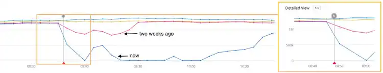

The benefit of using the median is demonstrated in the following example from one of our customers. The metric being monitored is the total number of messages sent by users of a social networking platform. Drops in this metric mean lower user activity, which may indicate trouble accessing the application.
In this chart, we can see the drop in the metric (the blue plot on the bottom) and the red triangle indicating an alert was triggered. Coincidentally, around the same time two weeks ago, the metric experienced a substantial, but less drastic, drop (the pink plot).
In the alert detail, we can see the range of normal values (defined by upper and lower thresholds) does not react to the pink plot’s sudden descent. Had this prior incident influenced the threshold, the range of normal values would have been dragged downward, and the alert would have been delayed (or failed to trigger altogether). Note the current plot is the rolling mean of the original signal.

Built-in Alert Conditions exploit this feature. In this example, if we set Clear threshold to 15%, an alert will not clear until the 15-minute rolling mean is within 15% of the historical norm. Using distinct trigger and clear thresholds gives cloud operations greater confidence that when an alert clears, a new alert will not trigger moments later.
