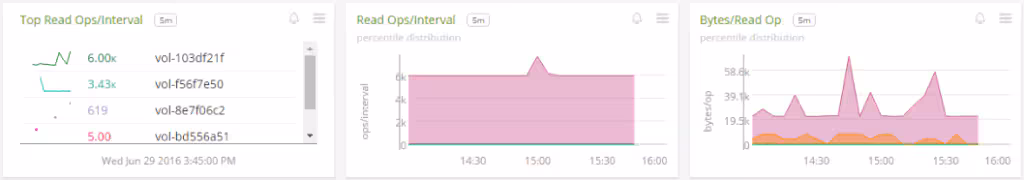

Next, we give you a breakdown of your read operations both by the top volumes and by a percentile distribution. This will help you determine which volumes are using the most read operations. Furthermore, the percentile time series chart will show you how many servers are affected and how the load changes over time.
In the example below, we see that there is a large pink area on the Read Ops/Interval chart. Pink is used for the max, and since the rest of the colors are relatively small, those servers appear to be outliers. It’s also not a temporary spike, because it is using that much capacity continuously. Looking at the top chart, we see the two volumes responsible are vol-103df21f and vol-f56f7e50. We should investigate these volumes more closely to determine that the servers are operating correctly, and if so, whether read IOPS has become a performance bottleneck.
EBS Image Read Ops
We can also see the number of bytes per read operation. This will give us a clue as to how many volumes are experiencing small reads versus large reads. If you have many small reads, you might be better served with an SSD because they have more IOPS capacity. If you hit the IOPS limit, you can get more by purchasing provisioned IOPS. HDDs have the advantage of a higher 1k maximum IO size (or block size), so you can read more data in a single operation. If you have large read operations, you might benefit from greater throughput offered by an HDD.

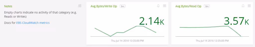

Lastly, the average bytes per read and write operation are shown. Both of these are very small, in fact smaller than a typical disk block size. If the reads are random, you might be able to increase performance by optimizing for sequential reads so that multiple read operations can be combined into a single one.

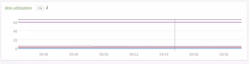

Surprisingly, CloudWatch does not offer metrics about the size of your volumes or what percent of it is used. It’s important to monitor disk size because, if your server runs out of disk space, it can become unstable or crash.
We recommend using a monitoring agent such as collectd along with the df plugin to monitor disk usage. Our plugin for collectd also computes additional metadata, making it easier to analyze. For example, disk.utilization offers a metric describing what percent of your disk is used. Below, you can see that a couple of volumes are in the 60% range, and the rest are vastly underutilized.
