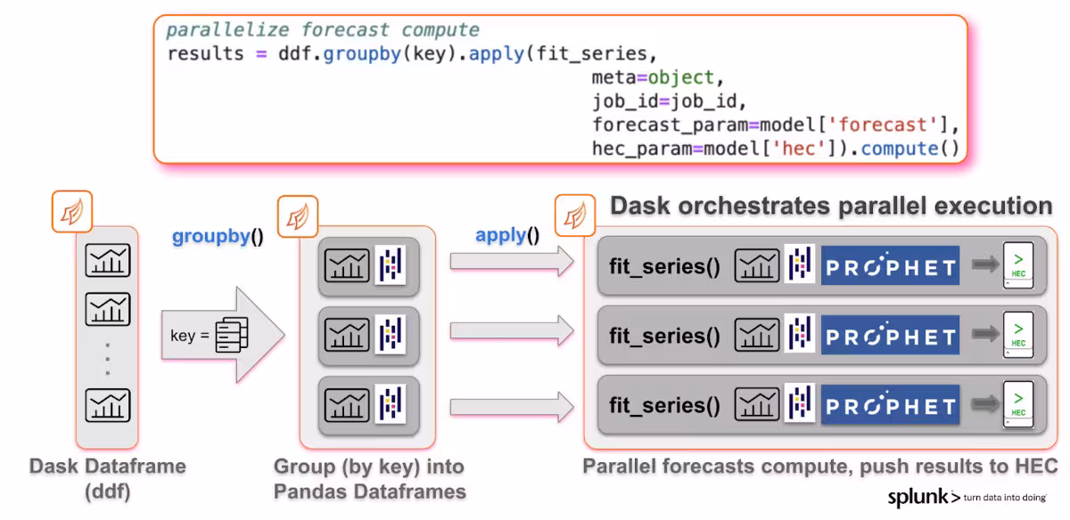

How The Parallelization Works
Typically, when you need to solve a larger or more complex problem, you try to break it down into smaller parts that work with your limitations. Assuming you need to compute forecasts of KPIs for millions of entities on a daily basis, it can be easy to run into a computational challenge. The good news is that this type of challenge can be solved using parallelization to get the job done in less than 24 hours. By splitting the time series by entity key, you can initially distribute the data and the forecast calculations across multiple cores, e.g. using a framework like DASK. Finally, you can send the results back to Splunk HTTP Event Collector (HEC). The following diagram shows the core building blocks and the main DASK python command:

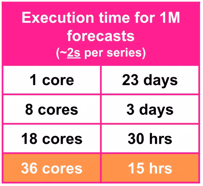

Results
