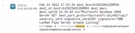

Let’s head into more modern times and look at what Splunk can do with very little effort against sample vulnerability scan data. I’ve used Nessus as the scanner in the examples, but the same principals should apply to your own favorite scanner. A sample event may look like this:
Nessus Event
It is mostly unstructured, but some of the fields will be extracted automatically by Splunk at search time as they are in key=value format. My first report may be similar to the one I described above where I want to find a count of all signatures (vulnerabilities are now called signatures) found. The Splunk search could be:

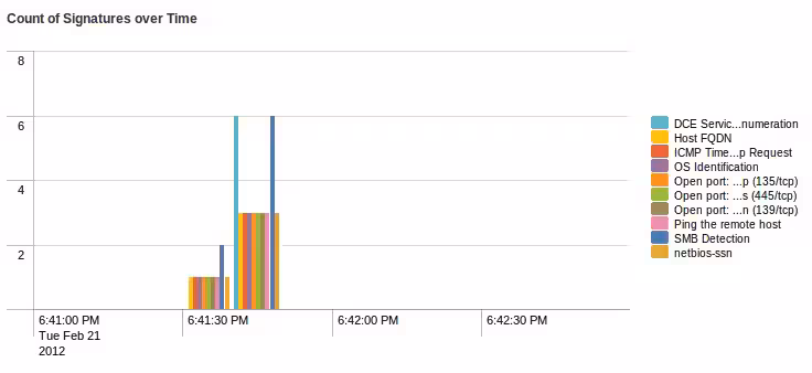

Now, let’s try something a little more graphical where I would like to see a graph of these same signatures over time using a column graph. In the old days, TCL would not have been able to do this and I would have had to spent some time learning and using the accompanying TK language for the chart. In Splunk the search is as follows using a custom time range:
sourcetype=nessus|timechart count by signature span=30s
Timechart Vulnerabilites

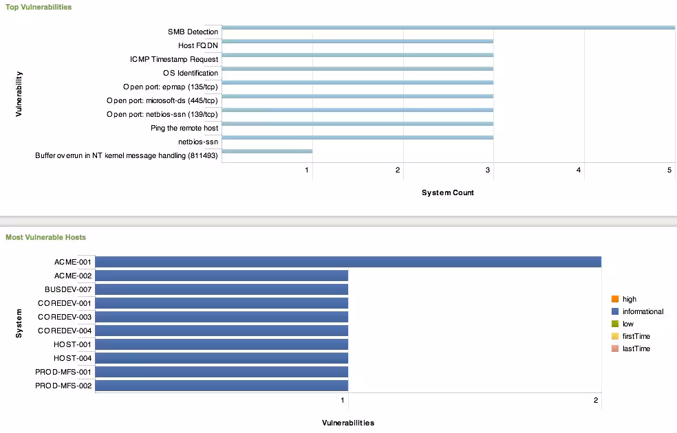

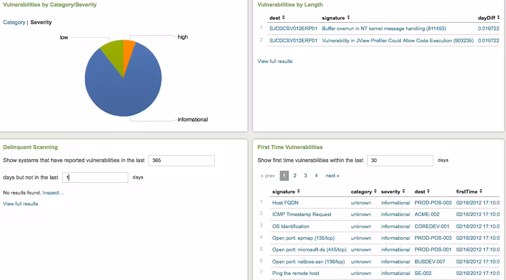

Enterprise Security 2.0
If you like the these reports for your vulnerability scanner, then you may also want to consider Splunk’s ES 2.0 offering, which has vulnerability scanner reports and related correlation searches as a sub-domain for the network portion of its monitoring. These are much more professional reports than the ones I just showed you as they take into account summary indexing to scale the aggregate reporting to massive amounts of data and also correlate the data with events from other security devices to give you a more complete security posture. For the reports to work out of the box, you will need to alias your field names to use the Splunk Common Information Model and create a few tags and eventtype definitions for your events. ES 2.0 already does this for the Nessus sourcetype. Here are some partial dashboard views:
Top Vulnerabilities
Vulnerabilities Category
