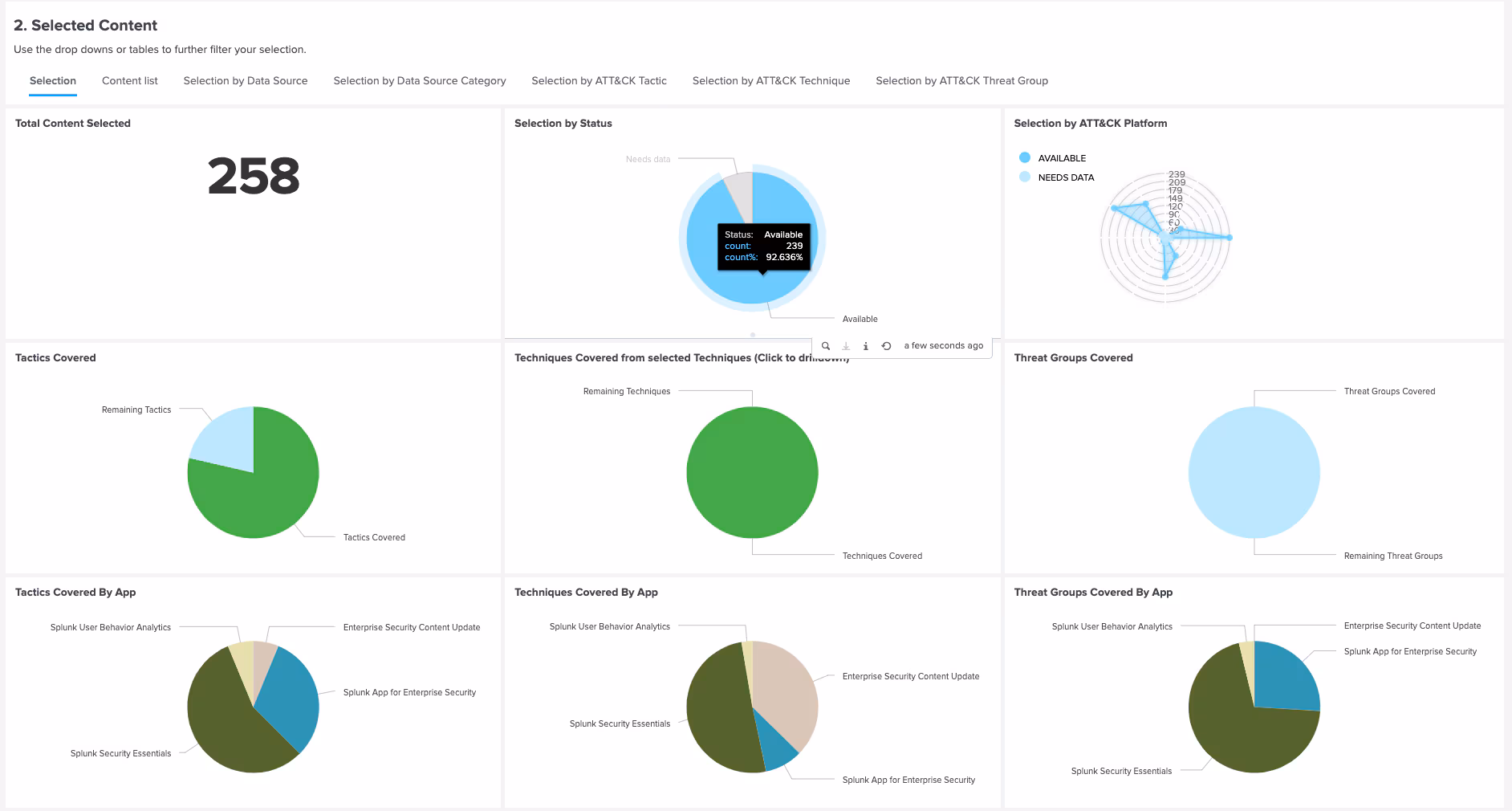

The selected techniques and the coverage metrics in the current environment

Flip between the panels and tabs to view the current coverage in the environment in different ways
The charts show 2% coverage on the ATT&CK Matrix by the six active detections

Flip between the panels and tabs to look at the current coverage in the environment in different ways.
Which source type provides the most potential detection coverage?
The chart shows 73% coverage on the ATT&CK Matrix by the 985 available detections in the environment

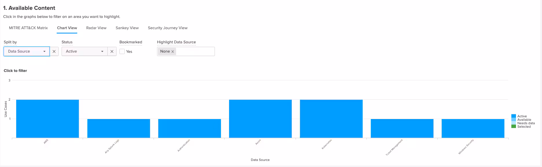

Which Data Source Is Providing Me With the Most Technique Coverage?
  1. Navigate to the Analytics Advisor -> MITRE ATT&CK Framework
  2. Select the Chart View tab
  3. Select “Data Source” in the “Split by” dropdown
  4. Select “Active” in the “Status” dropdown
  1. Click the “Selection by Data Source” tab under the “Selected Content” section further down
The number of detections and other content available in Security Essentials split by data source.
