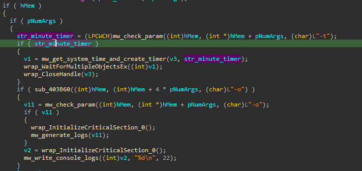

Parameter Check
The first part of its code is checking parameters that can execute some of its features related to timing and logging. Below is the code screenshot of this checking with its 2 parameters.
The first parameter is “-t” which will trigger a waiting timer relative to the current minute of the system time. For example, if your system time is 14:19:22 PM and you use this parameter with a value of 25 as the third parameter, it means it will wait 5 mins before it executes its code like the screenshot below.
While the “-o” parameter is a feature to redirect its console logs to a debug log file you inputted as the 3rd parameter.

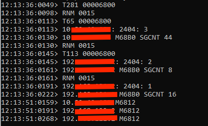

Console Logs
Upon executing this malware, it outputs some console logs with a customized code structure that tells something about what features it executes. Some of it will be discussed further in the next subheadings. Below is an example of the console logs during its execution.

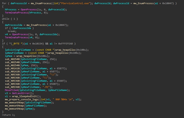

Terminate Process and Rename Process File Path
This function enumerates all running processes in the targeted host and looks for the process named “PServiceControl.exe” and also the process name stated in its config data. It will also look for the file path of that process in a specific folder that is in the config file and rename it with “.MZ” file extension.
The code screenshot below shows the process termination and renaming of process file path. We can see in the code snippet the code “RNM” plus the last error code after the call MoveFileA() function that will be displayed in its console logs after executing this part of the code. You can see that in the console log screenshot earlier.

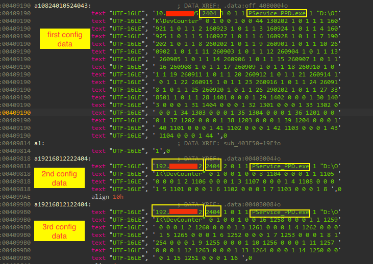

HardCoded Configuration Data
This malware contains hardcoded configuration files that will be parsed with the help of CommandLineToArgvW() function and put in a structure that will be used later in its code. Below is the screenshot of the parsing function.
The config data contains values and checks that this payload uses through its execution. We saw four main components of its three configuration data settings that are hardcoded to its data section like the screenshot below: The first component is the IP address of devices where it tries to communicate via IEC-104 protocol, the next one is the port number (2404), third is the process name (PService_PPD.exe) it tries to kill aside from “PServicecontrol.exe” and a file path (D:\OIK\DevCounter) where it locates the process file path it tries to kill to rename it with .MZ file extension.

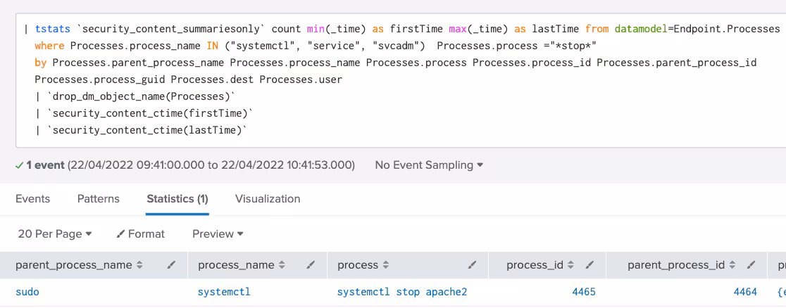

Linux Stop Services
This analytic identifies events that attempt to stop or clear a service.
This is typically identified in parallel with other instances of service enumeration of attempts to stop a service and then delete it.
| tstats `security_content_summariesonly` count min(_time) as firstTime max(_time) as lastTime from datamodel=Endpoint.Processes
  where Processes.process_name IN ("systemctl", "service", "svcadm")  Processes.process ="*stop*"
  by Processes.parent_process_name Processes.process_name Processes.process Processes.process_id Processes.parent_process_id
  Processes.process_guid Processes.dest Processes.user
  | `drop_dm_object_name(Processes)` | `security_content_ctime(firstTime)`

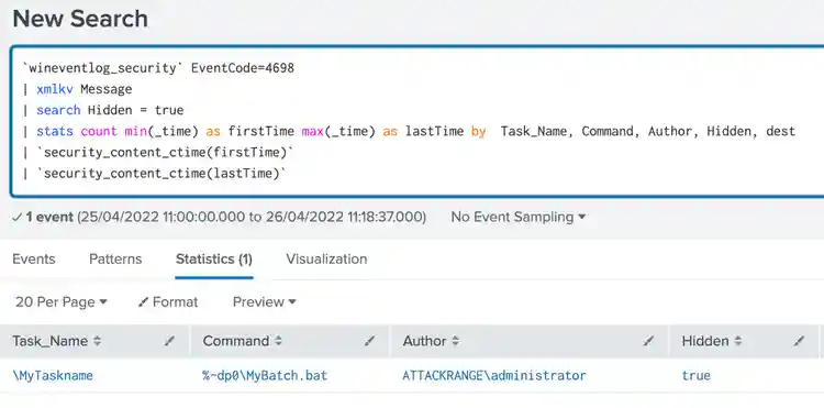

Windows Hidden Schedule Task Settings
The following query utilizes Windows Security EventCode 4698. A scheduled task was created to identify suspicious tasks registered on Windows either via schtasks.exe OR TaskService with hidden settings that are unique entry of malware like Industroyer2 or attack that uses lolbin to download other files or payload to the infected machine.
`wineventlog_security` EventCode=4698
  | xmlkv Message
  | search Hidden = true
  | stats count min(_time) as firstTime max(_time) as lastTime by  Task_Name, Command, Author, Hidden, dest
  | `security_content_ctime(firstTime)` | `security_content_ctime(lastTime)`

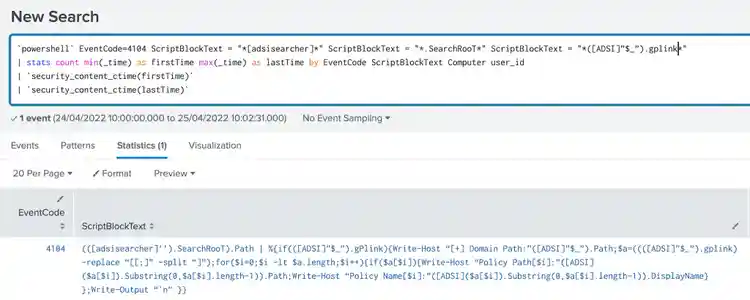

Windows Linked Policies In ADSI Discovery
This analytic utilizes PowerShell Script Block Logging (EventCode=4104) to identify the `[Adsisearcher]` type accelerator being used to query Active Directory for domain groups.
`powershell` EventCode=4104 ScriptBlockText = "*[adsisearcher]*" ScriptBlockText = "*objectcategory=organizationalunit*" ScriptBlockText = "*findAll()*"
  | stats count min(_time) as firstTime max(_time) as lastTime by EventCode ScriptBlockText Computer user_id
