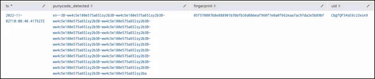

If you are now ingesting X.509 extension logs, here’s a quick search to detect the use of punycode within the Name Constraints extension.
index=main sourcetype="bro:x509_extensions:json" name="X509v3 Name Constraints"
| rex field=value "(?<punycode_detected>xn--.*)"
| search punycode_detected=*
| table  ts punycode_detected fingerprint uid
Fig 6. Detection of punycode
