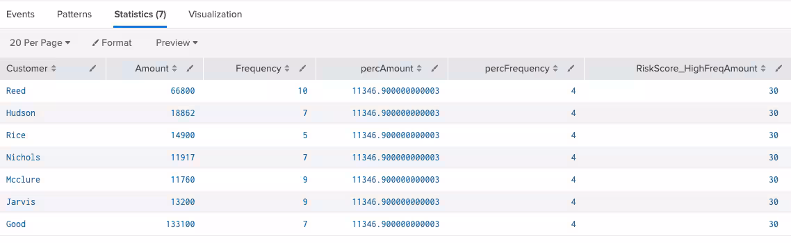

We can build upon the outlier use case and use percentiles to look for indicators of fraud. In Splunk, one can use the eventstats command to find the 90th percentile for any numerical variable for all events. In theory, if the variable’s value is in the 90th percentile, then it is an outlier. If there are two variables of interest, both within the 90th percentile of their respective dataset, then the chances of declaring the event as fraudulent increases. For example, suppose we have transaction data containing total amounts transferred and the frequency of the number of transfers done within a day. If a customer is within 90th percentile of both the total amount transferred and their frequency is also over the 90th percentile, then this looks like suspicious behavior and it should be flagged as such. In SPL, this would look like the following.
index=transactions sourcetype=transfers | eventstats perc90(Amount) as percAmount perc90(Frequency) as percFrequency|where Amount>percAmount and Frequency>percFrequency |eval RiskScore_HighFreqAmount=30 | table Customer Amount Frequency percAmount percFrequency RiskScore_HighFreqAmount

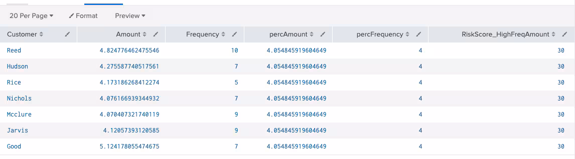

An arbitrary risk score is added to the end to send to a risk index for further processing. For the purposes of this example the risk score is arbitrary, but your risk score in real life is based on your own usage and normalization techniques according to what suits your use case. In this example, all customers who are over the 90th percentile for amount and frequency are flagged. Because the amount can be magnitudes larger than the frequency value, we can use the log function to bring the amount value within the same magnitude as the frequency. There are other ways to do this such as using a StandardScaler function in machine learning, but we will keep it simple by using log here.
index=transactions sourcetype=transfers | eval Amount=log(Amount)|eventstats perc90(Amount) as percAmount perc90(Frequency) as percFrequency|where Amount>percAmount and Frequency>percFrequency |eval RiskScore_HighFreqAmount=30 | table Customer Amount Frequency percAmount percFrequency RiskScore_HighFreqAmount
Now, the Amount field is at a more reasonable magnitude, but the results are the same. Let us move on to what could be a better way to look for an outlier.

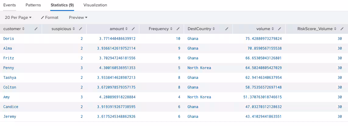

Using Cubic Volumes
What if we used three variables instead of two? We’ll use wire transfer data in the next example and add a suspicious country score. All countries will get an initial score of 1 and if they are suspicious, they will get a score of 2. A really suspicious country will get a score of 3. Our formula will now be amount * Frequency * suspicious. This will compute a virtual cubic volume. If the virtual cubic volume is over a predefined threshold, this entity should get a risk score just like we did before. In the next SPL example, we artificially provide a suspicious risk rating using a case statement for each Country in the dataset with a default rating of 1. (The assignment of 1, 2, and 3 could have been done in any way preferred by the writer of the SPL as this example is just for illustration.)
index=transactions sourcetype=wire_transfer |eval amount=log(amount) | iplocation destIP|rename Country as DestCountry|eval suspicious = case(DestCountry=="United States", 1, DestCountry=="Ghana", 2, DestCountry=="North Korea", 3, 1=1, 0) |eval volume=amount * Frequency * suspicious| where volume > 40| eval RiskScore_Volume=30| table customer, suspicious, amount, Frequency, DestCountry, volume, RiskScore_Volume |sort - volume
The new things in this search are the use of iplocation to find the country name of the destination IP address, the use of the case function to assign scores to countries, and finally using a virtual volume to look for suspicious behavior. In deployment, instead of using a case function, it is better to use a lookup to determine the risk rating as there are over 200 countries in the world. The use of 40 is an arbitrary predetermined threshold of fraud. We could have used the percentile method from above to show all events that had where Frequency>p_Frequency and suspicious>=p_suspicious and amount>p_amount to help compute the threshold, but my dataset was not aligned to the point where events had all 3 variables in the highest percentiles at the same time. That is why I arbitrarily chose 40 as the threshold after examining some of the highest values of these variables. This threshold should be fine tuned over time with more training data. One could argue that using three variables instead of two can lead to less false positives, if a proper threshold is used. Visually, this method can be shown with these sample cubes.
