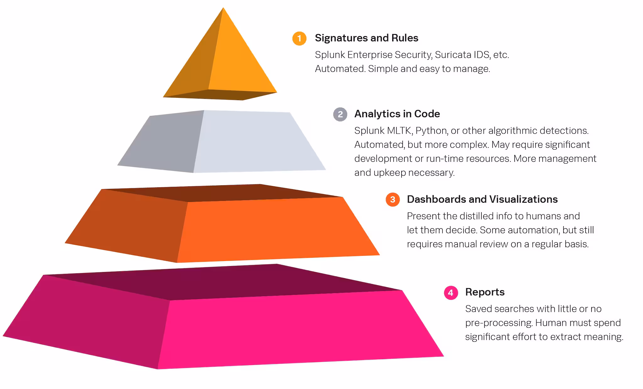

The Hierarchy of Detection Outputs
The hierarchy consists of four broad categories of detection, ordered by how much automation they offer. Or, to put it another way, ordered by how much human attention they require in order to find the bad things.
The PEAK Hierarchy of Detection Outputs
The hierarchy consists of the following levels, starting from the bottom:
Reports
Sometimes you know what you want to find, but searching for it is likely also to return a large number of irrelevant results, such as authorized benign use or other false positives. Finding relatively rare examples of true malicious intent may require analyst experience and insight. In this case, an automated report might be the best option for detection. Run it on an appropriate schedule (daily, weekly, monthly, etc) and put it into the analysts’ ticket queue or use some other mechanism to ensure that someone actually reviews it.
Reports are the lowest level of the hierarchy and thus the least desirable because they require the most human attention. They’re not ideal, but sometimes they are the best you can do. Hunts that result in report detections might make good candidates for additional detection engineering or even re-hunting in the future; once you have more experience with the reports, you might find better ways of focusing on the relevant results and climbing the hierarchy.
Dashboards & Visualizations
Moving up from reports are dashboards and visualizations, which present summarized information instead of just raw details. Unlike a report, which lists individual events, dashboards are easier for humans to consume and make sense of. They may show the systems deviating the most from their established Producer-Consumer Ratio baselines or a heatmap of failed logins across DMZ servers.
Although dashboards and visualizations still require regular human attention and probably have a fair amount of benign entries, they are designed to make it easy for analysts to pick out the important things quickly. Like reports, dashboard detections could be refined in the future to move up the hierarchy.
Analytics in Code
When you know how to find the exact activity you’re looking for, but it requires a little outside computation to make it work, you’re dealing with what we call Analytics in Code. That is, you have created a script or program to analyze the data and find the targeted activity. This is especially common with model-assisted hunts but can occur with any hunt. Ideally, the output of this code will be highly accurate and suitable for inserting into your SIEM as an alert.
Although this level in the hierarchy is perfectly respectable from the standpoint of automation and alerting, you may need to devise a mechanism to ensure that the code reliably runs on a regular basis.
Signatures & Rules
At the top of the hierarchy, you’ll find IDS signatures and SIEM rules. These require no human input to generate alerts and are easier to manage than analytics written in code. As a result, they are the preferred choice for automated detection when feasible.
