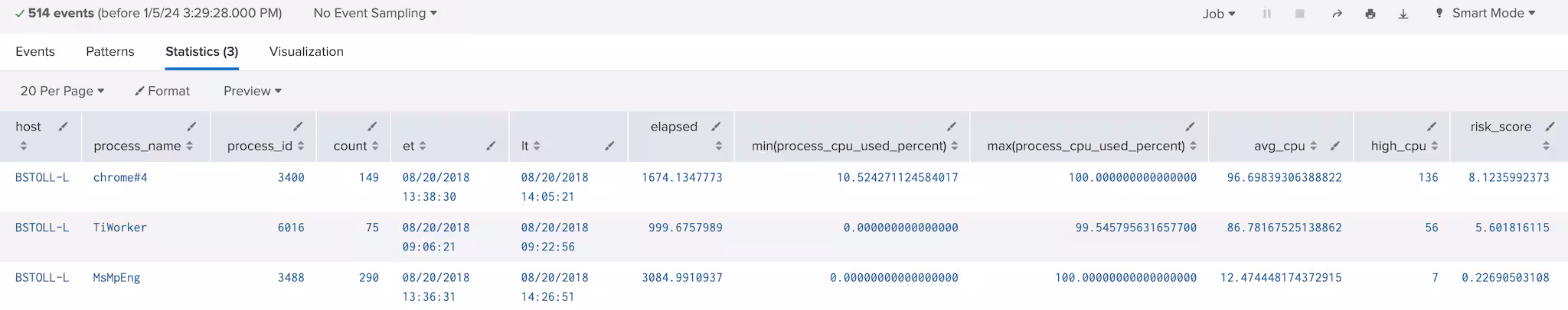

Approach 1: Sensor Health (DS0013)
According to MITRE ATT&CK, we should consider monitoring process resource usage to determine anomalous activity associated with malicious hijacking of computer resources such as CPU or GPU resources. None of our systems have much GPU power to speak of, so we’ll concentrate on long-running processes with significant, sustained CPU usage.
Our SPL searches for any process that lasts for at least five minutes and above and has a CPU utilization of 90% or more throughout its lifetime. This cutoff of 90% is arbitrary and should be set according to the threat hunter’s own risk appetite, their knowledge of their network environment, and any threat intelligence available. Additionally, there are summary statistics included to help the hunter with information such as minimum, maximum, and average CPU utilization, and also counts of CPU utilization spikes. We calculate a simple risk score based on the number of events showing high CPU usage over the process's lifetime. Processes with higher risk scores are more likely related to cryptomining activities.
``` Find all records for any process that 1) exhibited ANY high CPU usage, and 2) ran for at least five minutes. The subsearch finds the list of processes that meet these requirements, then the main search retrieves ALL the records for each of these processes across their entire run times (even if they didn’t all show high CPU).```
index=botsv3 sourcetype="perfmonmk:process"
    [search index=botsv3 sourcetype="perfmonmk:process" process_cpu_used_percent>=90 Elapsed_Time>=300
    | table host, process_name, process_id
    | dedup host, process_name, process_id]
``` Calculate some summary stats, including the number of times each process exhibited high CPU over its entire run ```
| eval high_cpu=if(process_cpu_used_percent>=90, 1, 0)
| stats count, earliest(_time) as et, latest(_time) as lt, max(Elapsed_Time) as elapsed, min(process_cpu_used_percent), max(process_cpu_used_percent), avg(process_cpu_used_percent) as avg_cpu, sum(high_cpu) as high_cpu by host, process_name, process_id
``` Convert timestamps to human-readable format ```
| convert ctime(et), ctime(lt)
``` Score each process by the ratio of high CPU instances to total run time ```
| eval risk_score=(high_cpu/elapsed)*100
``` Order by the new score ```
| sort - risk_score
Note that the five-minute threshold is an artifact of our simulated dataset. In a production computing environment, a cryptominer would probably run for far longer. If you reproduce this hunt with your own data, you’ll almost certainly want to extend this time. 30 minutes, or even longer, would probably be more useful.
Figure 3: Processes with high CPU Utilization
The search returns three processes that have sustained CPU utilization across most of their runtime, all on the host BSTOLL-L. However, the Chrome process (chrome#4) immediately stands out as it has the highest risk score and the highest number of high CPU events over the second-longest elapsed time. Also, the other two results are legitimate Windows processes and are known to use large amounts of CPU from time to time.
While high utilization from a Chrome process does not confirm the existence of cryptomining, it does suggest that if this were a cryptominer, it would most likely be browser-based. From our research, we know that families such as CoinHive, Crypto-Loot, and JSEcoin are miners that run inside browser tabs, so this Chrome process is a plausible candidate for a cryptominer. However, we can’t jump to conclusions; more investigation is required to verify that this is actually a cryptominer.
