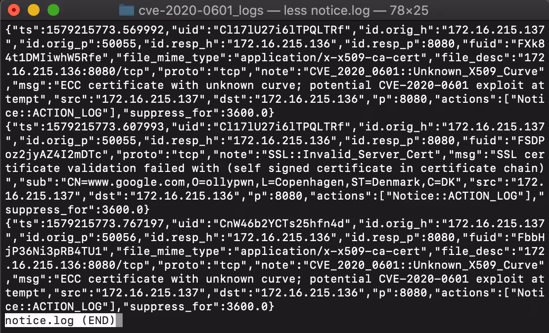

Reviewing Zeek logs with SPL is straightforward but you need to understand that there are several different log files generated and that each tells you something different. For our purposes, we are going to focus on the notice.log file, as this file contains Zeek “notices” or alerts.
If your log format looks different from mine, you’re likely using Tab Separated Value (TSV) format, which is enabled by default. As Splunk has built-in JSON syntax formatting, I’ve configured my Zeek installation to use JSON to make the event easier to view and parse, but both formats will work, you just need to adjust the SPL provided to the correct sourcetype. I have my inputs.conf configured to set sourcetype as “brojson” (if not using JSON, set sourcetype to “bro_notice”)

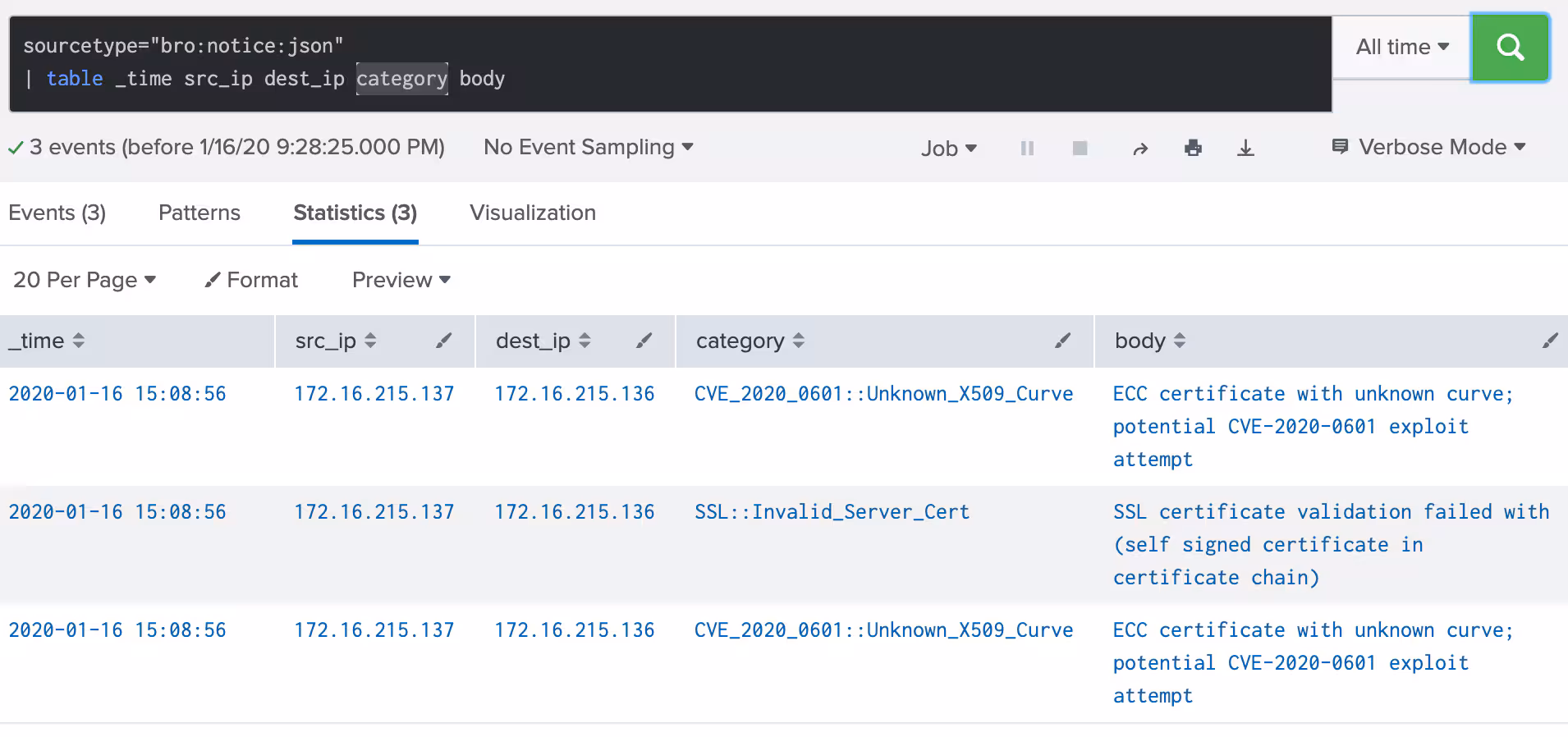

sourcetype="bro:notice:json" category="CVE_2020_0601::*"
| table _time src_ip dest_ip category body
When we run our search looking for notices with a category starting with CVE_20202_0601::, we see a few results. However, we only care about the alerts fired from the new detection script. The SPL can be modified to fit your environment as necessary (like adding your Zeek index!)
Perhaps you noticed that the data is already CIM compliant with the Alerts and Intrusion Detection data models. If you’re an Enterprise Security customer, you’re ready to develop a Correlation Search. Otherwise, now would be a great time to create an alert!

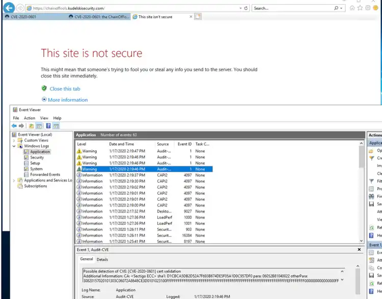

I promised you I’d give you a couple of options, in case you’re not using Zeek yet. On the same VM, I installed the patch, then restarted the system. Once again, I browsed to the fake website, but this time the certificate wasn’t valid.
Microsoft added an API call in Windows 10 and Server 2016 (or higher) to log an entry in the Application log when an exploit attempt is made against a vulnerability that has been patched. Presumably due to the criticality of this vulnerability, Microsoft made this API call in their patch for CVE-2020-0601.

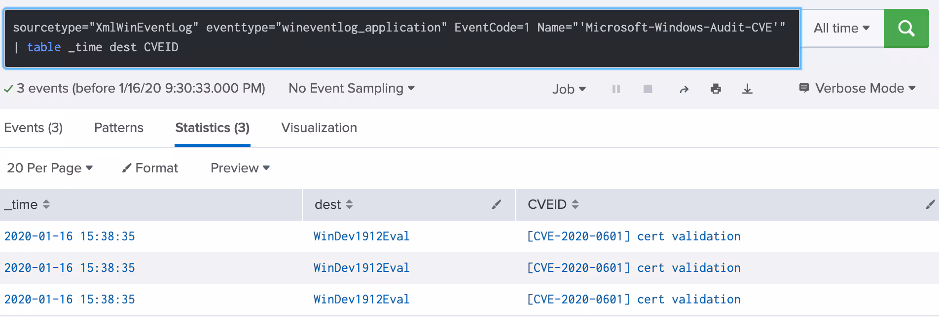

sourcetype="XmlWinEventLog" eventtype=”wineventlog_application” EventCode=1 Name="'Microsoft-Windows-Audit-CVE'"
| table _time dest CVEID
To find these events, the key fields to search for are: Name=“Microsoft-Windows-Audit-CVE” and EventCode=“1”. I love this event… what better detection mechanism than the vendor providing the patch for the vulnerability shouting “Hey! Look! Over here, something bad is happening!”
