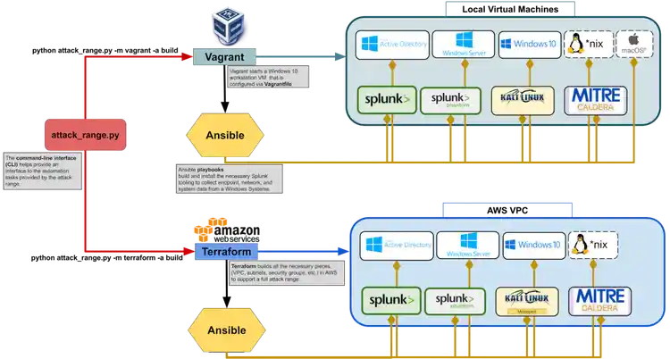

Before we dig into building a range, let's discuss some of the intents of the project and how it is wired together 🔌. More specifically talk about the difference between Vagrant and Terraform mode. The has been built with the intent to automatically 🚀 test the detections of the Splunk Threat Research team and those contributed by the community to the security-content project. The Attack Range project is mainly composed of 3 major parts.
  1. The attack_range.py CLI — used to build, destroy, test and simulate attacks
  2. A virtualization platform — right now we support Vagrant for local dev builds and Terraform for longer running sharable attack_range environments.
  3. Ansible playbooks — contains the orchestration logic that configures the built environment.
At a high level, the attack_range architecture looks like this:
We will be leveraging the Terraform mode and constructing our range on an AWS VPC. We recommend to use this mode by default for a few reasons, but primarily because you can run a more complex complete environment on AWS EC2 versus your local machine. Currently, Vagrant local execution limits the size of the environment to the number of resources your local machine has. In a typical MacBook Pro with 16GB of ram, you are limited to successfully running a range with a domain controller or windows client and a Splunk server. Adding any more instances like a kali Linux attacking server, or multiple windows domain controllers joined by a domain will cause you to run out of memory.

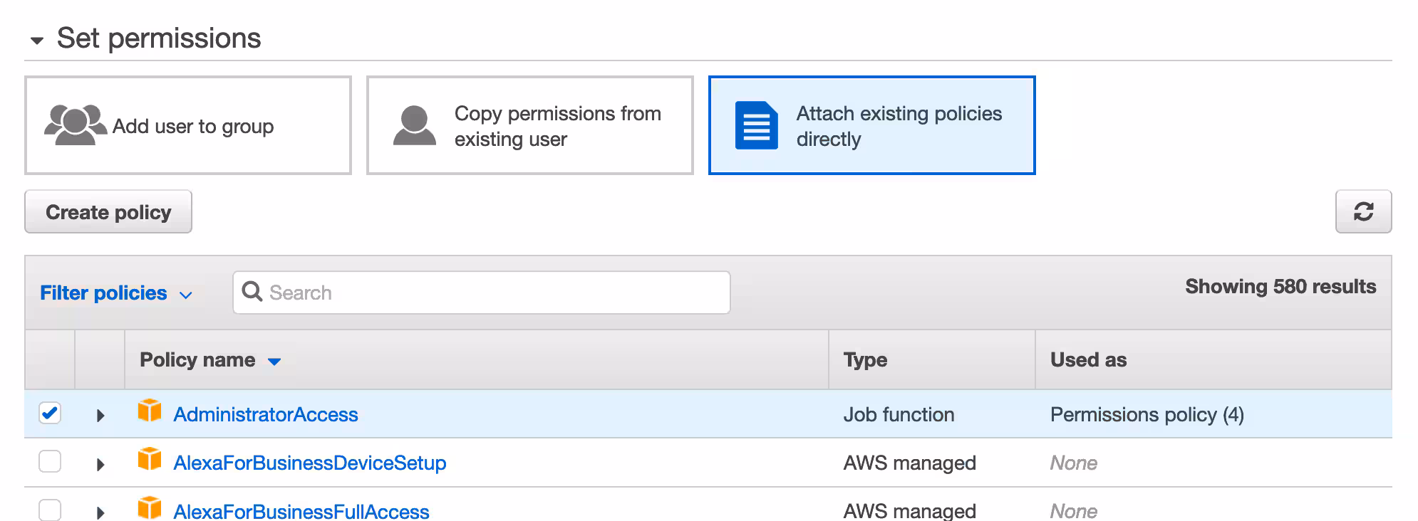

This will create two files: a private key under ~/.ssh/id_rsa and the public key ~/.ssh/id_rsa.pub next import the id_rsa.pub publike key into AWS, you can simply follow the instructions provided by AWS here to accomplish this. ⚠️ Make note of the key name you will need it in a second, in the attack_range documentation we default to attack-range-key-pair as the name. While in AWS make sure you create a user with programmatic credentials.
Provide this new user EC2 administrative access and save the access key ID and secret access key.

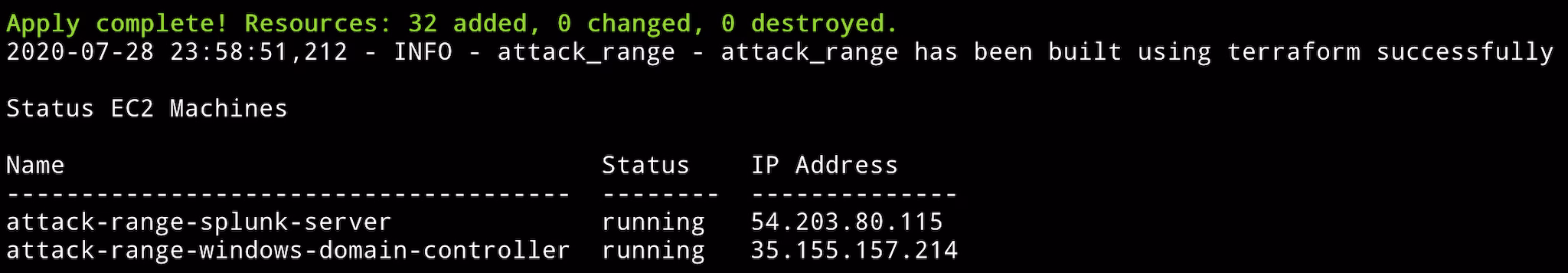

The typical build takes roughly 11-15 minutes (about 30 mins if installing Splunk Enterprise Security), this might be a good time to grab ☕️. If all went well at the end you should see a list of your machines like below:
If you have made it this far you have now built your first attack_range 🎉. Explore each machine by connecting directly to them. For Splunk use a browser and open http://<splunk_server_ip>:8000. For the windows server use an RDP client to connect to port 5389 and authenticate with the user name and password configured in attack_range.conf. Now that you have a fully running attack_range and have made yourself familiar with the environment lets launch our first attack!
