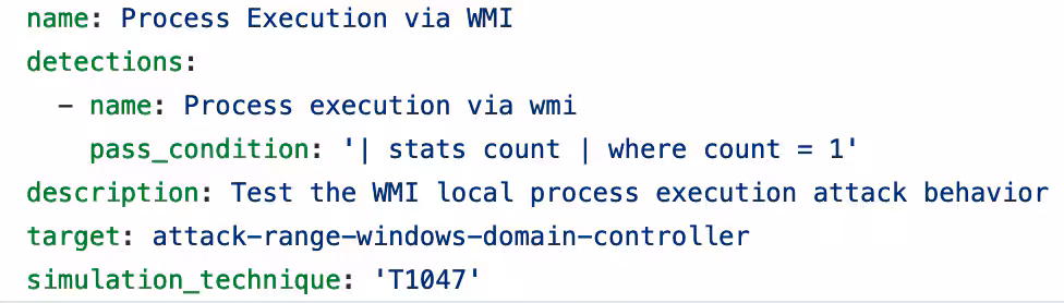

Let’s dig into how our first approach was architected. First, a new argument was added to the Attack Range that would ingest a test file that has predefined configurations. You see an example of a test file below:
The key arguments specifically are:
We created a few of these test files under their respective MITRE ATT&CK technique in the security content repo as we slowly tested them.

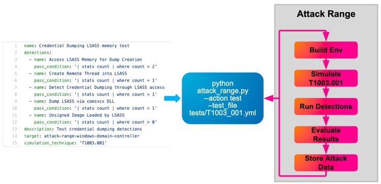

The Attack Range was modified to ingest these test files and run through the following process for testing. Build an environment, using Atomic Red Team simulate the technique associated with the detection, run the detection, evaluate its results based on the passed condition. Below is a visual representation of this process:

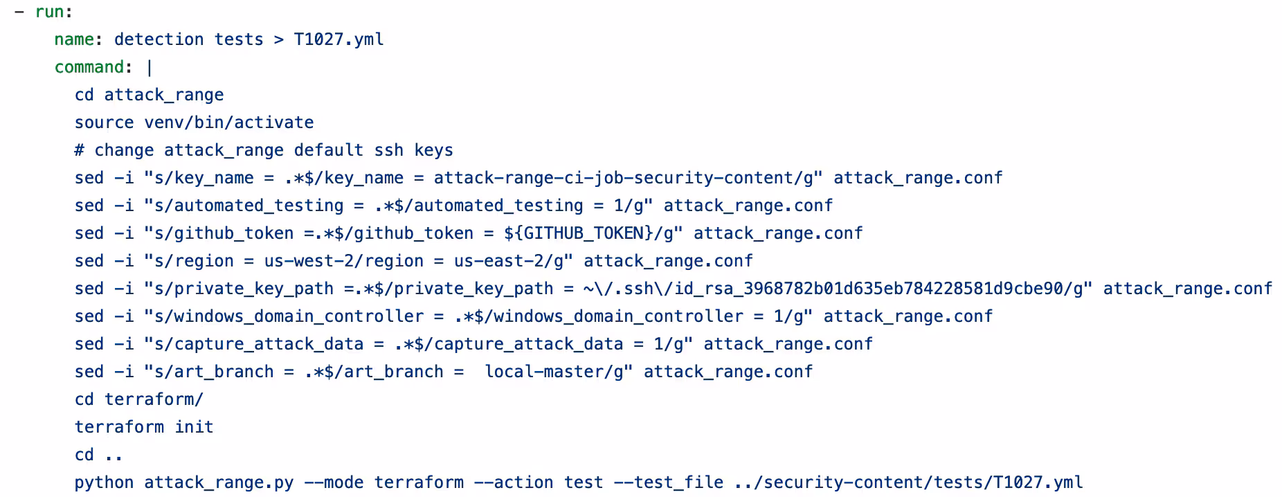

The final piece in our plans was generating CircleCI jobs for each of these test files that executed the above process. For this, we created a simple script called ci-generate.py that would read in every file under the /test folder in Security Content and create a CircleCI task from the file under the CircleCI job test-detections. The task looks like this:

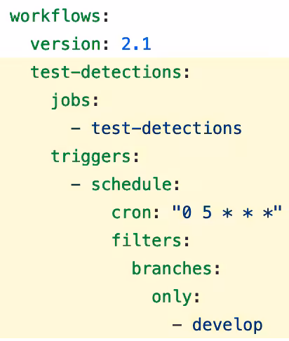

To circumvent this we first started queuing incoming jobs per PR, but it quickly became unusable as we have +10 jobs queued with a test wait time of 16 hours. On our second attempt, we decided to test the detections nightly instead of per PR. To run our detection tests daily we also added a workflow step to our CircleCI configuration file to run the detection. The workflow definition looks like this:

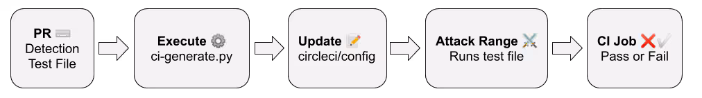

In short, we planned to have our Threat Research team (or anyone in the community) make a PR for new detections with its corresponding test files. After merging the PR we run ci-generate.py the script and update the /.circleci/config file with a new task job under the test-detections job for the corresponding test file to be executed in the nightly workflow. Note that each task is just executing our newly created Attack Range test flags. The overall logical process that we expected was:

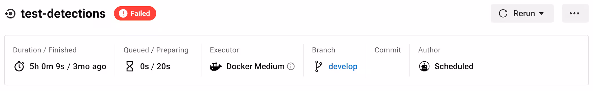

When we started building our library of tested detection it became obvious that our current approach would not scale. After 12 detection files, our nightly testing-detection CI job started failing consistently. This particular one tells the full story of why:
It took 5 full hours to run the job and only 10 detections were tested, and then the job timeouts. We learned that day that CircleCI has a maximum job time limit of 5 hours. After much analysis 🤔 at this point, I was content with calling this approach a failure, but the truth was we were not done with dealing with issues.
