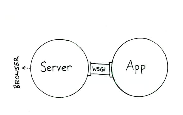

WSGI has two parts:
- The server–often high-profile web servers such as Nginx or Apache
- The web app made from a python script
The server executes the web app and sends related information and a callback function to the app. The request is processed on the app side, and a response is sent back to the server utilizing the callback function.
Sometimes there might be one or more WSGI middlewares between the server and the web app. Middleware is used to direct requests to various app objects, load balancing, content preprocessing and running several frameworks or apps alongside each other in the same process. Examples of Python frameworks that support WSGI include Django, CherryPy, Flask, TurboGears, and web2py.
Figure 1: WSGI Interface (credit: thesoftjaguar.com)
