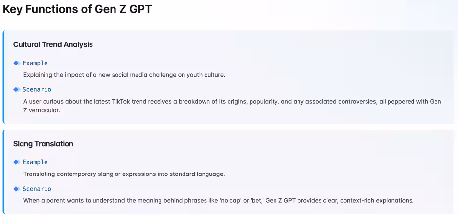

For example, an LLM may be trained on published internet content that contains language nuances and cultural trends from older age groups. An ecommerce website, previously aimed at an older audience, now wants to target a younger audience using an LLM shopping assistant. The younger audience may not relate to the language nuances or assistance provided by the LLM, because their culture, preferences, and purchase patterns are vastly different from the older audience.
This GPT focuses on using “standard” language alongside Gen Z slang, trends, and culture. (Source.)
