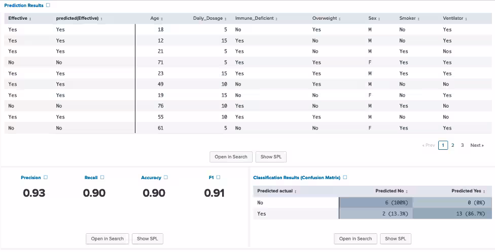

The first thing I did was use logistical regression to create a model to predict the Effective field’s value using 80 percent of the data to build the model and 20 percent of the data to test. I only have 100 records in my data set to make it easy for us to follow. Here’s the results using the experiment portion of the Splunk MLTK:
Although all the fields were used, you’ll notice that there is a 93% precision in the results because as I mentioned earlier, the results are skewed to work well with the age and the smoker field. If we run a search with our fit command to see how many times the Effective field’s value did not match the predicted(Effective) field’s value, we’ll see that it only failed 10 times, which is in line with our precision number.

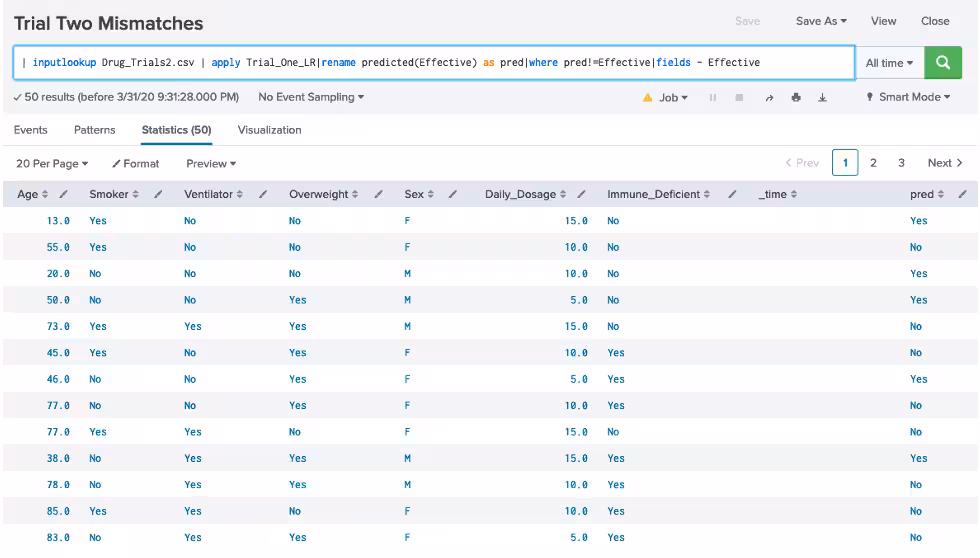

Now, let’s apply this model on a randomly generated data set with 100 records. Because there is no rhyme or reason to this new data set, the number of mismatches will be large as in 50%.
| inputlookup Drug_Trials2.csv | apply Trial_One_LR|rename predicted(Effective) as pred|where pred!=Effective|fields – Effective
Although the prediction with “non-sample” data is only 50% correct, it may still be useful in times of epidemics, when this particular drug still shows a chance that it can be effective.
