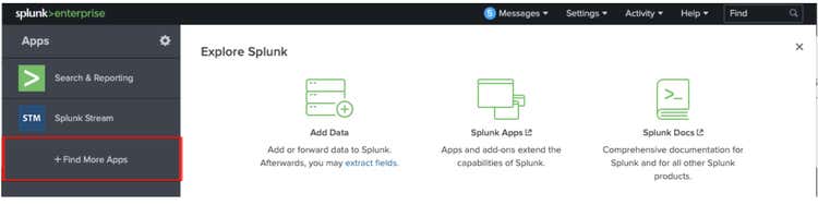

To install Splunk Sankey Diagram - Custom Visualization and Force Directed App for Splunk just download the app and unzip to $SPLUNK_HOME/etc/apps on your Search Head before restarting Splunk. You can also use the web ui at the Search Head to install both apps from Splunkbase by clicking in the “+ Find More Apps” section at the left-hand side of the landing page:

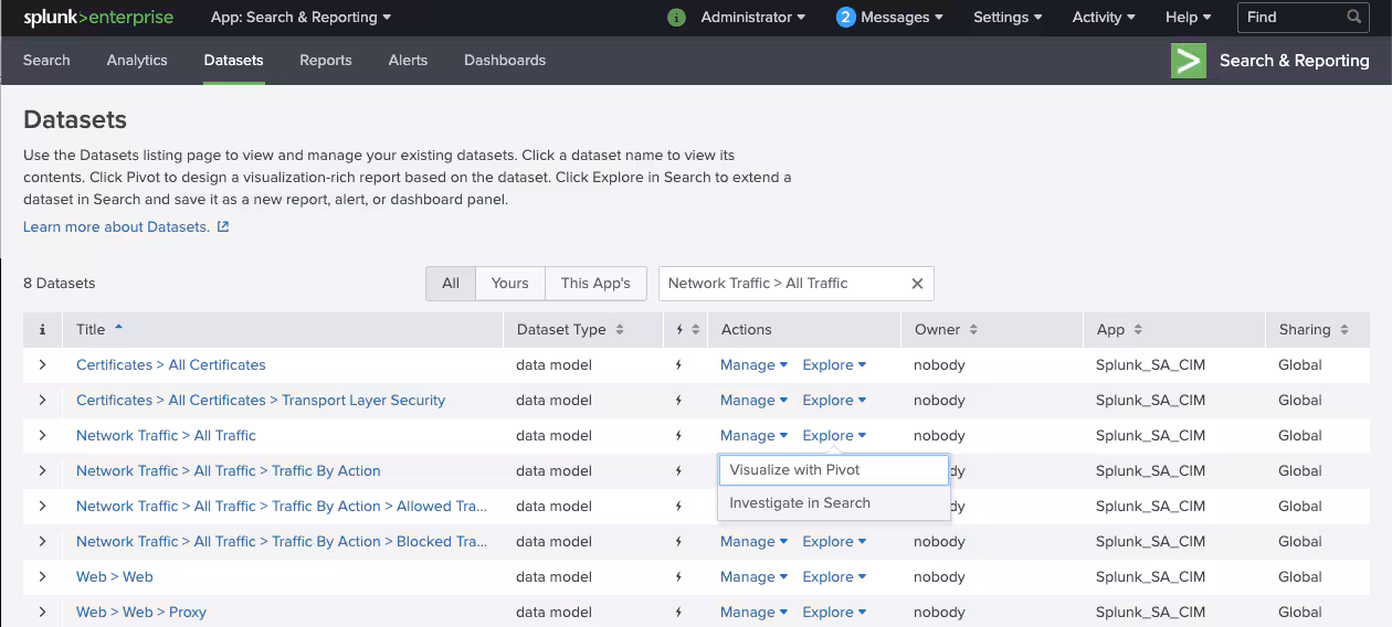

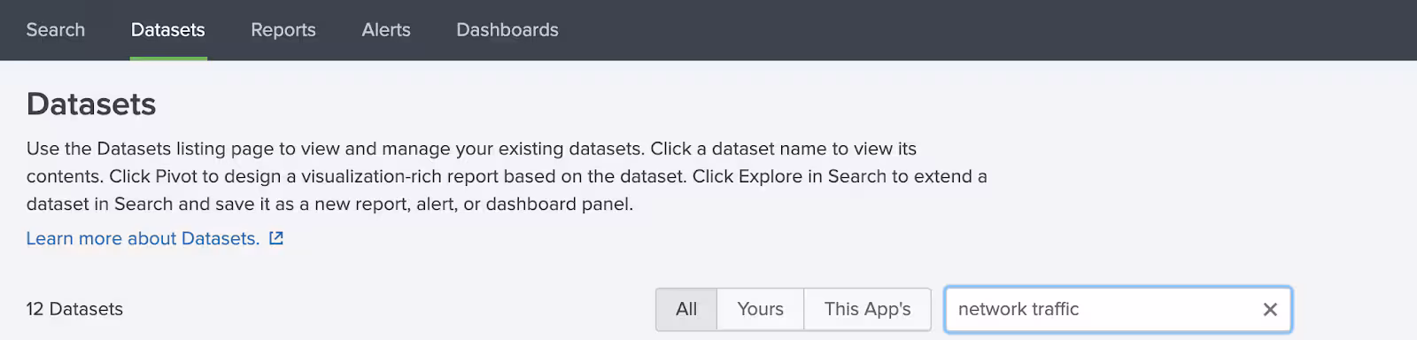

1) Click on Datasets and filter by Network traffic and choose Network Traffic > All Traffic click on Manage and select Edit Data Model

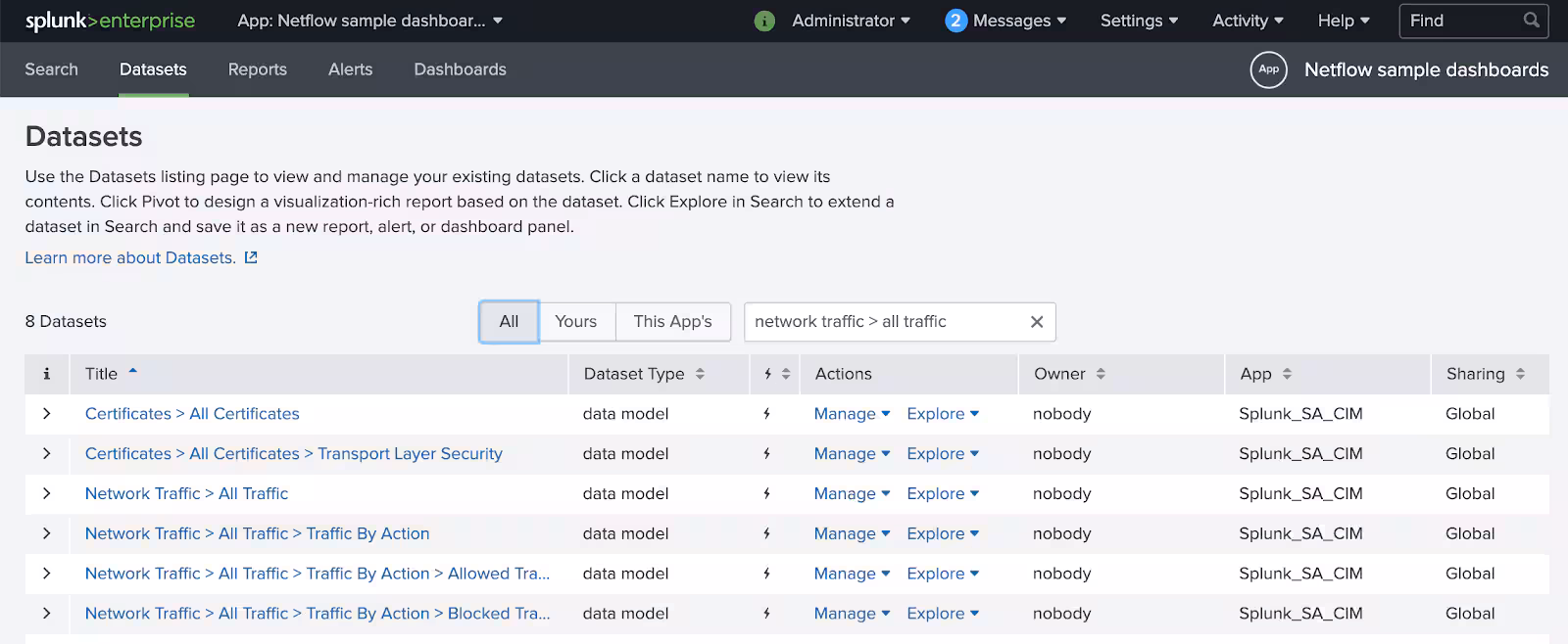

3) Now let’s review how the CIM can map NetFlow traffic fields contained at netflow_index to CIM: For that click on Datasets and filter by Network traffic: click on Network traffic > All Traffic:
4) This leads you to a table view of the Network Traffic > All Traffic mappings to the fields contained in NetFlow logs from the netflow_index index. Note that many of the fields are left blank as the Network Traffic>All Traffic model is broader than the set of fields provided by the NetFlow log.
5) Now let’s explore at search time how the CIM model extracts fields. For that, click on Datasets and filter by Network traffic: choose Network traffic > All Traffic and click on Investigate on Search. You will be redirected to Search in Splunk and you will be able to look at how a list of fields in grey have appeared after the JSON log info. Those are the list of fields that are compatible with the CIM model and that will be extracted for fast long-tail searches when it will be accelerated. The field protoid is not in the list of extracted fields but since you will need it for some of the dashboards of the 'sample dashboards for NetFlow' app, you have to manually modify the CIM data model and add it in the next step.

8) Click on Datasets and filter by Network traffic and I will choose Network Traffic > All Traffic and click on Investigate on Search to have a look at how a list of fields in grey have appeared after the json log info. See that protoid field has been included!
9) Now let’s finally set up data model acceleration. For that click on Datasets, filter by Network traffic and choose Network Traffic > All Traffic click on Manage and select Edit Data Model.

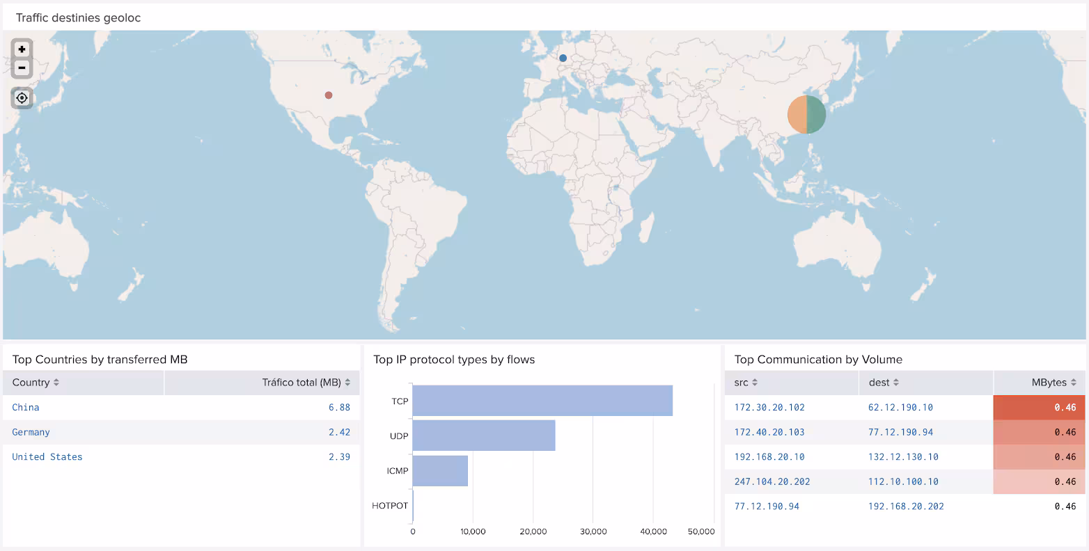

- @demo: NetFlow Dashboards: here I will have examples with long-tail data using Splunk’s tstats command that is used to exploit the accelerated data model we configured previously to obtain extremely fast results from long-tail searches. Note that tstats is used with summaries only parameter=false so that the search generates results from both summarized data and raw data. That will allow us, in one dashboard, to seamlessly enjoy the real-time experience of schema on read against raw data plus the long tail performance of the schema on write against data model accelerated data.

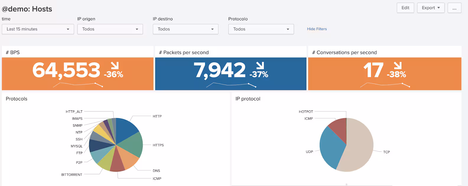

- @demo: Hosts: here I will have examples using real-time data based on Splunk’s stats command that is used to exploit the raw real-time data indexed at Splunk.

Find here some snapshots of the panels included in this dashboard:
@demo: Hosts
