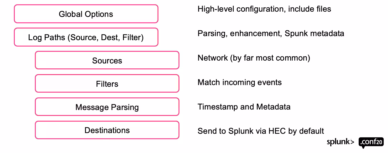

Syslog-ng config file structure
Here is the overall structure of a syslog-ng configuration file. The syslog-ng configuration file syntax, itself a programming language, offers a myriad of ways to “skin the cat." But all follow this same basic scheme:
In SC4S, most of this is abstracted via the configuration mechanisms described in Part 3, which frees the administrator from understanding the nuances of the syslog-ng syntax. But the structure of a log path will become immediately apparent when developing a new one, and an understanding of how the parts fit together is crucial.

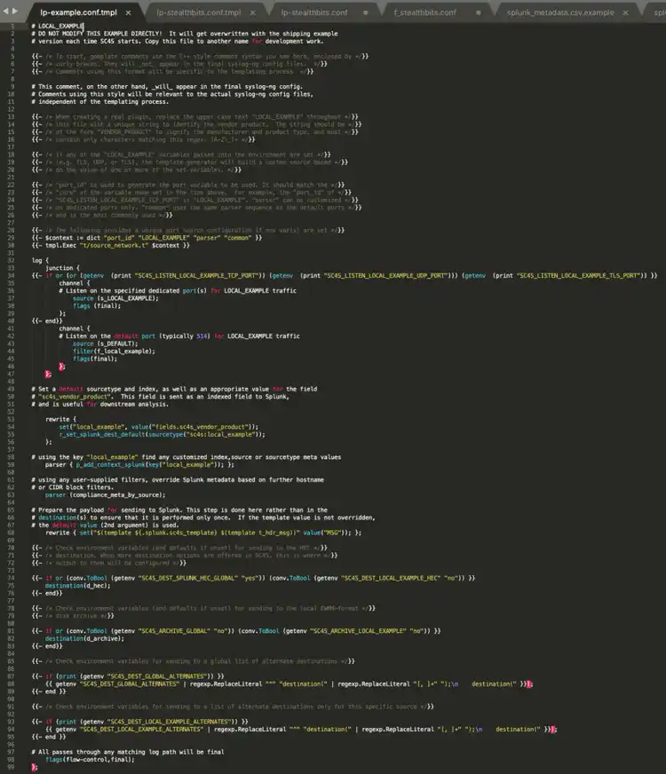

The log-path directory (along with the others in the config directory) are all "live" syslog-ng configuration files and are included in the overall configuration when the container (and underlying syslog-ng process) are run. Therefore, the syntax must be perfect or the whole affair will fail to start. For this reason, many of the .conf files are not edited directly, but rather through their .tmpl variants. In addition to variable substitution and conditional substitutions discussed in Part 3, the templating process allows us to abstract complex parts of the log path that need not be exposed (and configured) by the administrator.
Let's take a look at the lp-example.conf.tmpl file. Don't worry if the specific example file in your particular SC4S release differs from the one used for these screenshots. The example file periodically changes as SC4S is enhanced and refined, and will have indeed undergone changes to simplify the structure as you read this. Focus on the overall structure while reviewing the steps below; they will remain consistent regardless of the specifics of the file.
You will see that, first of all, the file is overly commented for instruction. The number of executable lines that result will actually be quite small. Second, though you will unlikely have a context-aware text editor (e.g. Sublime in "C" language mode) on your SC4S server, it helps to use one off-box when initially creating your template file from the example file above for help with syntax checking.
Let's walk through the steps needed to convert this "example" file into a log path that works with a real device, in this case our "Stealthbits" example. The following steps will prepare the new log path for customization specific to the device:
- The first thing to do (and this is a biggie): Copy the example file to a new template filename that will be used for your log path (e.g. lp-stealthbits.conf.tmpl). Do not edit the example file directly!
- Note the difference between "gomplate" (templating) comments, and regular syslog-ng ones (which have traditional bash-style hashtags). In most cases, you will retain the syslog-ng comments, but templating comments will rarely be used.
- The first section (lines 1-26) is largely an instructional comment block that focuses on a key aspect of how to use the example file: Key phrases (e.g. LOCAL_EXAMPLE) in this file will be replaced with a phrase that represents the vendor and product we are interested in. In accordance with the "vendor_product" convention used throughout SC4S, we will use the phrase STEALTHBITS_INTERCEPT.
- Similarly, replace all occurrences of the lower-case version of the same string (local_example) to stealthbits_intercept.
After these string replacements, we will now look at each section in turn. Careful examination of the snippets in the sections below will show the string replacements compared to the full screenshot of the unaltered example file above.
In accordance with the outline at the beginning of this section, we will dissect this file into four main sections:

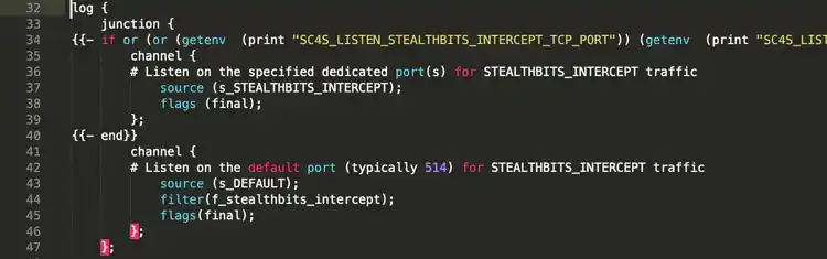

Let's start with the "Source" portion of the log path. Starting at line 28, we see:
These two templated lines do a most of the work for you, courtesy of the templating process. Just the main STEALTHBITS_INTERCEPT string, which forms the "root" of environment variables used to set unique listening ports, and a "parser" value (set to match the high-level structure of events. If you don't know, use "common") is all that is needed to create a custom source declaration for your device. Keep in mind this section will create the source declaration – i.e. the function that is called from within the log path as we'll see below.
Filter

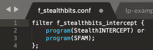

Next, we will explore the beginning of the log path itself, starting at line 32 (line 34 truncated):
You will see that each event will take two parallel pathways through a filter "junction", which then "merge" after all "channel" elements are traversed. In the top channel, the newly created source called s_STEALTHBITS_INTERCEPT is checked. If any events arrive on that source (unique port), it is passed through to the remainder of the log path with no further filtering. If, on the other hand, the event arrives over the default s_DEFAULT port (typically UDP or TCP 514) you can see that there is an additional filter (f_stealthbits_intercept) that must also match, or the event will not be "allowed in" to this log path. This filter can be declared (just like the custom source) immediately above the log{} stanza in the log path file, or it can be included in a separate file as shown below. Like the source, it is just a function with the name f_stealthbits_intercept:
Take a look at lines 2 and 3. Remember the raw message screenshot in Splunk (above)? Look for the field PROGRAM. This is an example of how the initial parsing pass of syslog-ng can be extremely useful for building filters in log paths, and lines 2 and 3 show how this field ("macro" in syslog-ng parlance) is checked to see if it matches the two values shown. You'll also see in the following section below how the same macro can be very useful when assigning sourcetypes – which the TA will expect.
