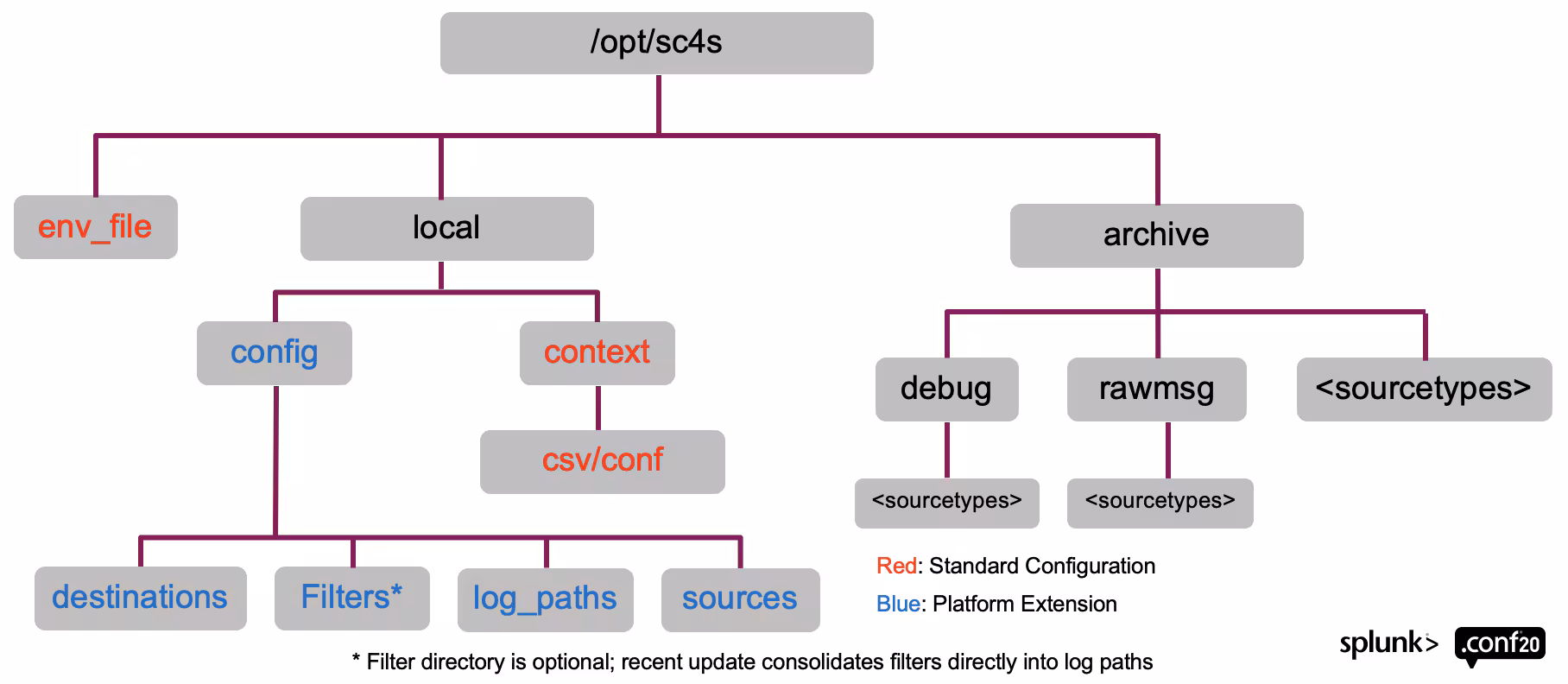

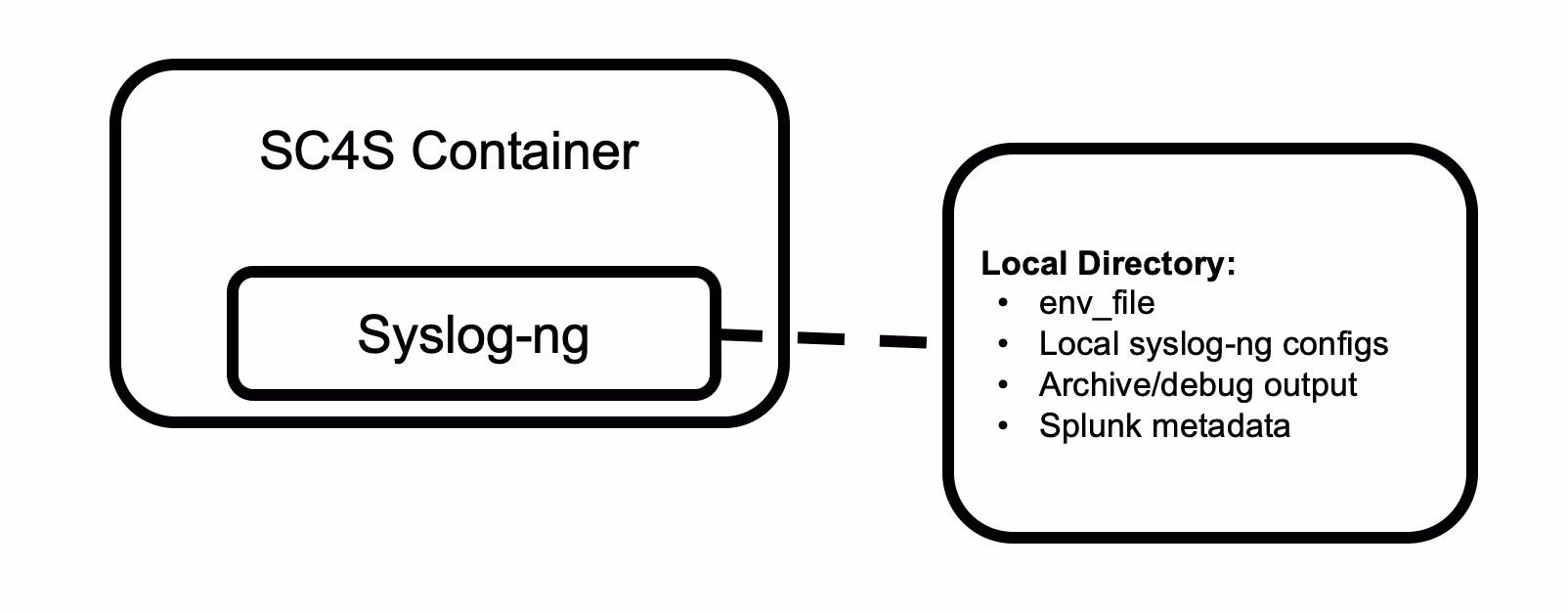

We will now look at each of these in turn, but before we do, let’s take a look at the SC4S Container architecture and configuration directory in detail.
The container is configured to mount a local set of directories so that configuration will remain persistent between SC4S restarts. This directory has the following structure:
Directories and files shown in red are part of a standard SC4S configuration and cover the required components such as the URL and Token for the Splunk HEC endpoint (which is the default destination for SC4S traffic) as well as configuration for Splunk metadata (index, etc.). Files contained in the blue directories contain configurations for locally configured collection methods (sources), output destinations and, most commonly, log paths (filters) for data sources that SC4S does not support out of the box. Creation of log paths will be covered in Part 4 of this blog series.
For the rest of this installment, we will focus on the files and directories in red above. Let’s start with the most common (and required) configuration, setting environment variables in the the env_file.

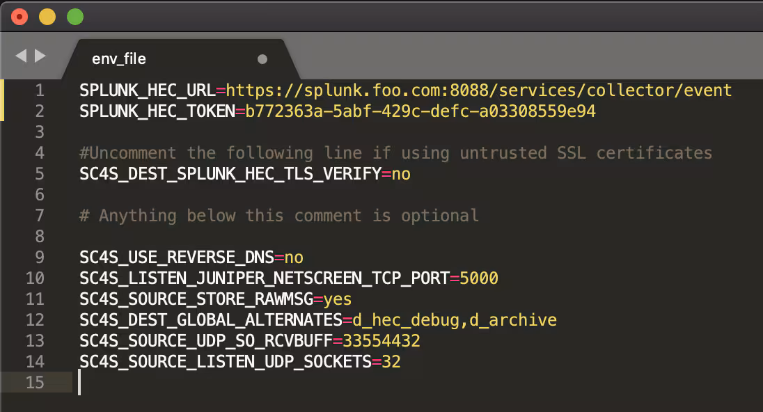

Global and Required Settings (env_file)
Configuration of SC4S begins with setting required and common optional parameters required for basic SC4S operation, which is done via the env_file. The file contains, as its name implies, environment variables that are used by the container shell at startup, and later consulted by the templating process (described in detail in Part 4 of this blog series) to create the final syslog-ng configuration that drives SC4S. Here is an example of a simple, but in many cases totally sufficient, env_file.
You will see that most of these variables make sense simply by their name. The variables here range from the required (Splunk HEC URL and token) to typical optional variables that are outlined in the documentation. The optional ones specified above are commonly used, however, and merit some explanation:
- SC4S_DEST_SPLUNK_HEC_TLS_VERIFY: This is a critical variable to get right, as the default in SC4S is for high security. If this variable is not specified (or set to “yes”), the default is to verify the server cert to the HEC endpoint. In many cases, particularly when first configuring SC4S, the required certificate file is not in the required location (this is documented here), and traffic will not flow to the HEC endpoint. In such cases, it is best to start out with this variable set to “no” and confirm that data is flowing to the HEC endpoint before tightening down the security for production.
- SC4S_USE_REVERSE_DNS: This can be very helpful for events that do not have the hostname set (or is set to an IP address) in the payload. However, ensure that your reverse DNS algorithm (caching nameserver) is fast; otherwise you’ll see events land in Splunk up to minutes after they’re collected.
- SC4S_LISTEN_JUNIPER_NETSCREEN_TCP_PORT: You may have several of these “LISTEN” variables in your file; they are documented per source or technology. They indicate to SC4S that you will be listening on a specific port (or ports) for that specific device class. Be sure not to specify the same port or overlap port ranges for multiple devices; the ports must be unique to each type. There will be a startup error if SC4S detects this.
- SC4S_SOURCE_STORE_RAWMSG: This setting is extremely useful when debugging event flow and/or developing a new log path, where a raw, “on the wire” syslog message is required. Be sure to turn this off in production, however, as it essentially doubles the resource usage throughout the pipeline (internal memory of SC4S, disk queues, and potentially the Splunk index.)
- SC4S_DEST_GLOBAL_ALTERNATES: This variable specifies a list of alternate destinations (besides HEC) for all traffic. These alternates can be specified per-source as well. SC4S-supplied (d_hec_debug and d_archive) as well as locally defined destinations can be specified in the list.
- SC4S_SOURCE_UDP_SO_RCVBUFF: This variable and the following “sockets” variable are critical for UDP buffer tuning; as a “send and forget” protocol the receiver cannot tell the sender to “back off.” Therefore, critical matching of SC4S server resources to expected traffic load is necessary to avoid dropped packets. Often, this variable (specified in bytes) must be configured to 32 MB or more. The kernel must be tuned similarly or a warning will be issued at startup.
- SC4S_SOURCE_LISTEN_UDP_SOCKETS: This is another UDP variable that instructs the kernel to set up parallel listening sockets for UDP traffic. This can be used to significantly improve the scalability of the underlying hardware for UDP traffic.
This list is by no means complete; the documentation covers the full complement of available variables that can be set in this file.

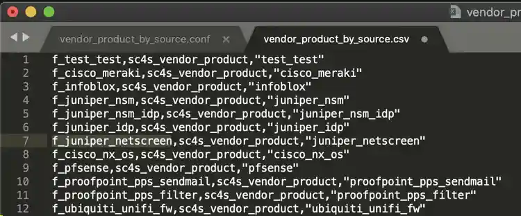

Let’s dig in. The primary context files are located in /opt/sc4s/local/context, and consist of two files:
vendor_product_by_source.conf
vendor_product_by_source.csv
The use of these files differs from the typical Splunk “default/local” convention that is used for splunk_metadata.csv. To properly use these files requires that they be complete (in other words, the “example” files are not consulted at all). Therefore, it is best to copy the example files to those with the regular extensions before you start using/editing them.

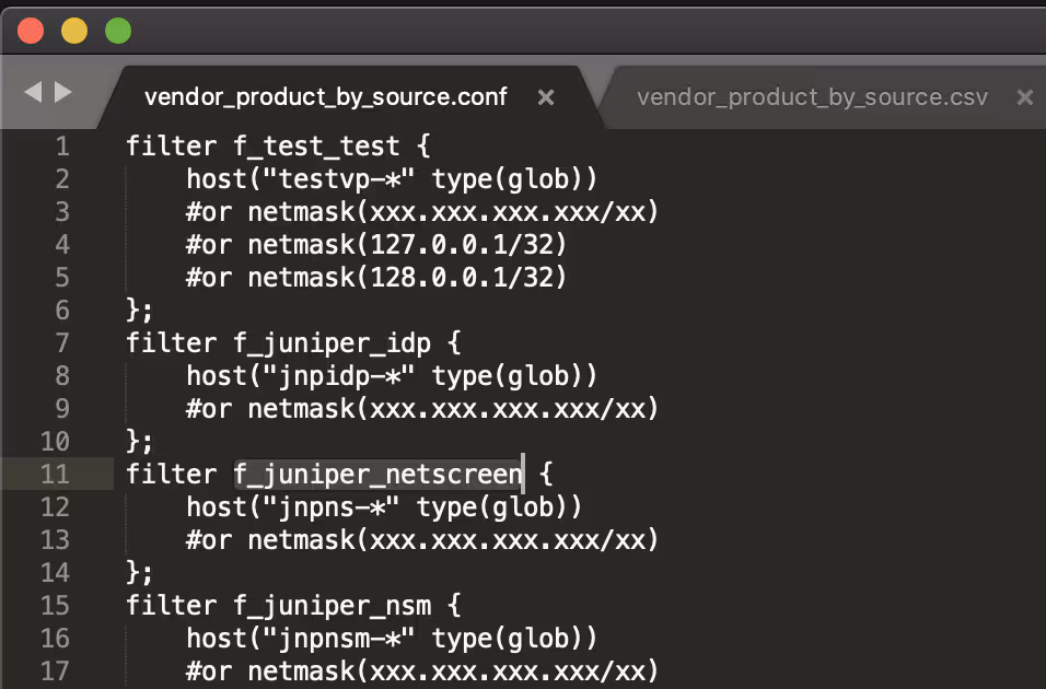

Here is the vendor_product_by_source.conf file:
You will see that it is a series of syslog-ng filters than can filter on any syslog-ng “macro” (field), but host and netmask are the only ones used because (as discussed earlier) these are the only fields which can be used with certainty before the payload is processed further. These filters (rules) are checked very early in the data path through SC4S, just after the rudimentary syslog parsers are run and before any payload filtering.
In this example, highlighted at line 11 is a filter for Juniper Netscreen devices with hostnames of jpns-* (the “glob” type indicates that this is a wildcard, and not a regex). The netmask in this case is commented out, but if it is known it can be easily applied. You will see that this file gives no indication as to what categorization should be applied — this is where the second (lookup) file, vendor_product_by_source.csv, comes in:

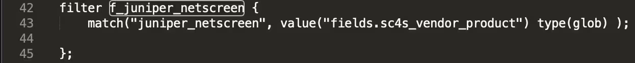

This lookup has the same 3-column structure as the splunk_metadata.csv file used for Splunk metadata, but the fields and values set are quite different and do not directly reference any Splunk metadata. The secret to these files is how the lookup key is used: you will see that the filter name in the conf file (line 11) will match one or more keys in the csv lookup (line 7). When the filter in the conf file “fires”, this link will set an internal field called fields.sc4s_vendor_product. This variable is in turn used in a simple filter that checks for the value of that variable in a log path created for that specific vendor/product combo, in this case Juniper Netscreen:
You may ask, why not just use the original filter in the main log path (shown immediately above) rather than the indirect approach using an internal field? The reason is to allow the administrator to set hostname/CIDR filters using a minimal amount of (repeatable) syslog-ng code, and more importantly to not require access to the main log path, which is inaccessible inside the container. In this case, line 43 in the main log path (hidden inside the container) never needs to change, but instead is driven by the filters and lookups in the vendor_product_by_source.* files.

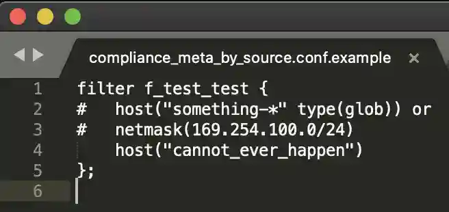

Compliance Overrides (Event Subfilters)
There is a second set of context files that are configured similarly to the primary context filters described above. The primary difference is where the filter operation takes place — deep inside a log path, long after the vendor/product combination has been determined. It allows the administrator to configure (again, primarily based on hostname/CIDR block but can also include other syslog-ng macros (fields) that might have been created internally in the log path itself. These overrides (sub-filters) can be very useful in compliance use cases, where a subset of a given device type (sourcetype) must be tagged or redirected.
Again, there are two files in the same /opt/sc4s/local/context/ directory:
compliance_meta_by_source.conf
compliance_meta_by_source.csv
As with the first set of vendor/product context files discussed above, it is best to copy over the “example” versions first before you start. This set of files typically is far shorter than the first set as well, so it may be preferable to simply use the example files as a reference.

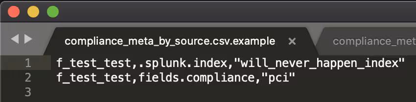

Here are the two compliance_meta_by_source files:
You will indeed see that this is dummy data, and also note one other interesting characteristic: the second column in the csv file is not limited to Splunk metadata but can be set to any syslog-ng macro. In fact, it can be used to set an arbitrary indexed field=value pair (e.g. compliance=pci) that can be sent to Splunk, which can be very useful for compliance needs. As part of this flexibility, however, Splunk metadata entries need to have the internally-used .splunk. prefix applied (e.g. .splunk.index) in order to override the index. These details are covered in the configuration section of the documentation.
