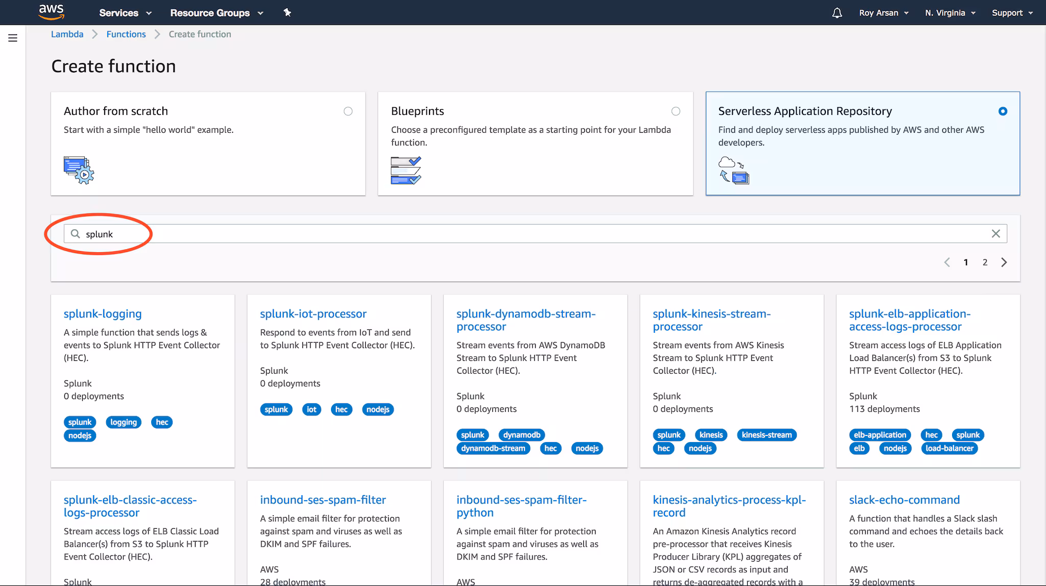

Let’s start with “dessert” first, which is deploying the serverless app and watching a scalable data streaming architecture generate while you sip on a beverage of your choice. A serverless app from the Serverless Application Repository is an AWS CloudFormation template that leverages the Serverless Application Model (SAM) to make development and readability a breeze. The Serverless Application Repository integrates with Lambda, so you can launch serverless apps from the AWS Lambda console. Just create a function and select “Serverless Application Repository” from the different template options. Then, search for “Splunk” in the search bar and select the “splunk-kinesis-stream-processor” serverless application.

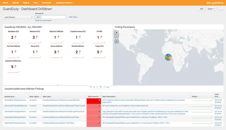

Remember how we started with “dessert?” Turns out we’re finishing up with some more dessert! Now that we have everything set up, let’s have a look at the events streaming in from GuardDuty in the Splunk GuardDuty Add-on. Other than installing the add-on and creating the HEC token, no additional configuration is required for Splunk. You can search for GuardDuty findings using Splunk search, or head over to the starter dashboards provided with the add-on.
Try generating some sample findings from the settings page in the AWS console for GuardDuty. After these sample findings are received by Splunk, you should see a nightmare dashboard in the GuardDuty Add-on warning you of rogue Bitcoin activity, communication with command & control servers, and other nefarious activity across your AWS environment. Don’t worry though, hopefully these are just the sample findings!
The Splunk GuardDuty Add-on is not fully featured without the Splunk App for AWS and Splunk Add-on for AWS installed and configured, however you will still be able to visualize and search the GuardDuty data without them.
