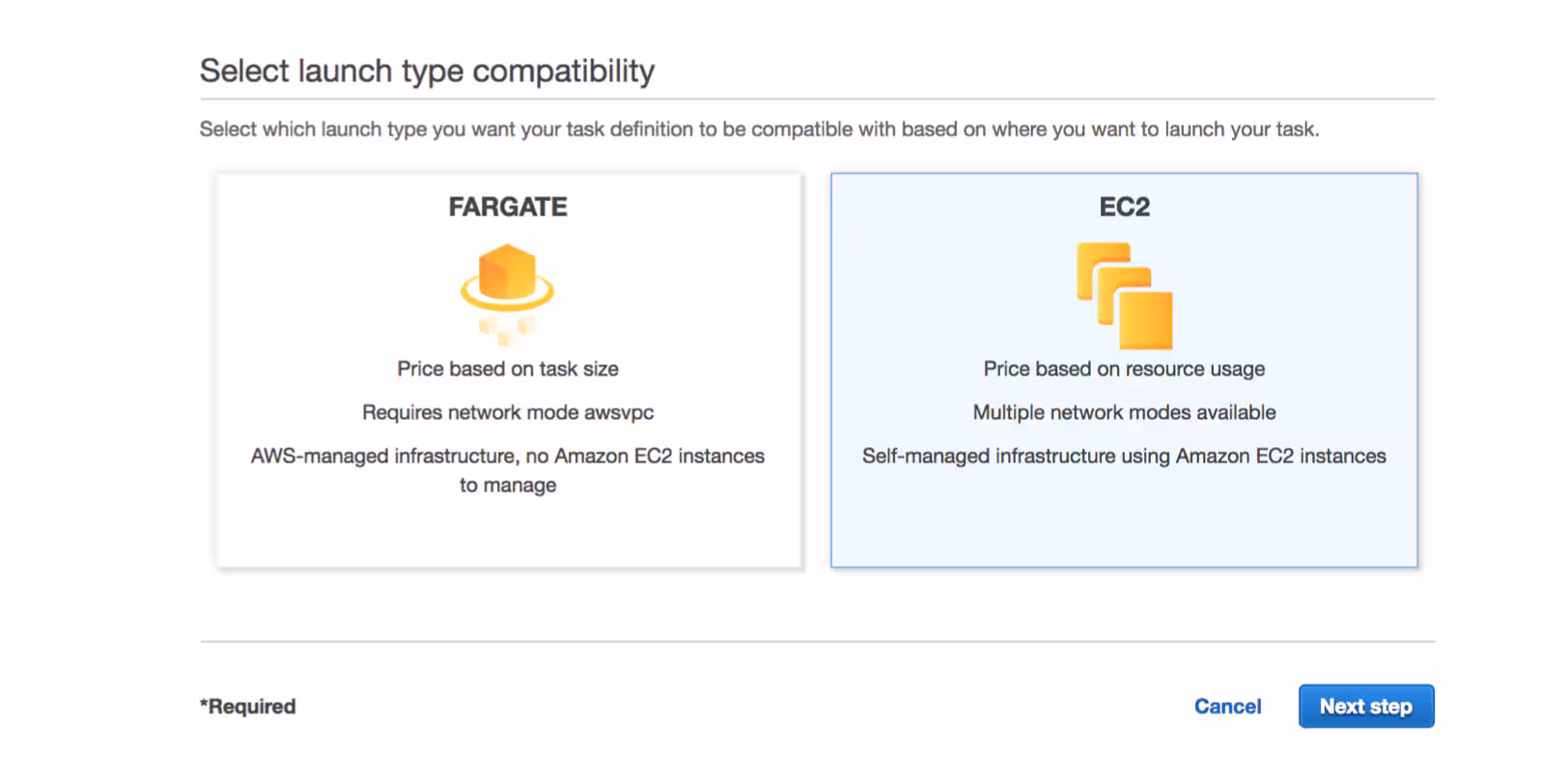

Here we will create a single server Splunk install and not a clustered deployment. Back in the main AWS ECS menu select Task Definition, and Create a new Task Definition. Select EC2 as the Launch type.
Enter a task name, and select ecsTaskExecutionRole as the Task Role. Use the default setting for the Network Mode.

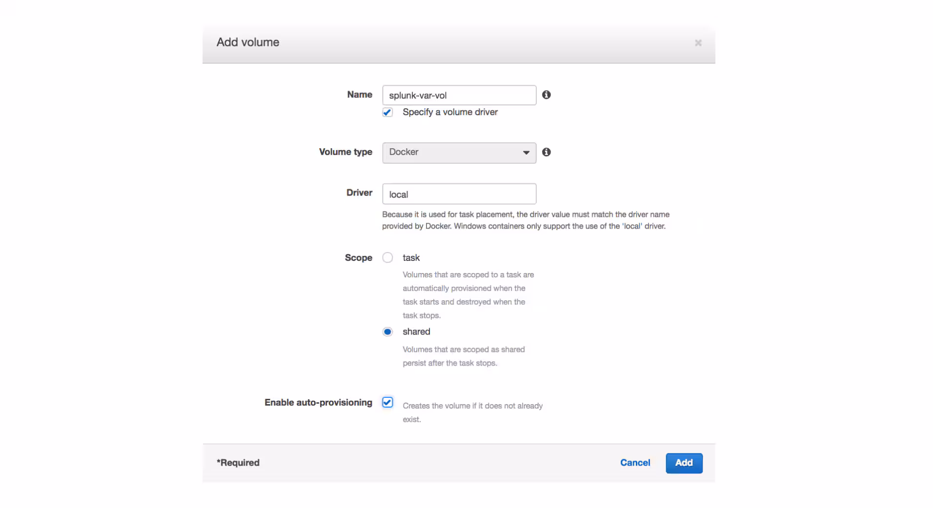

Before we add the container, we will create two volumes for $SPLUNK_HOME/etc/ and
Create a volume for both of these (for example name them splunk-etc-vol and splunk-var-vol), and click on the “Specify a volume drive” checkbox so that you can change the Scope of the volume to “shared”, and Enable auto-provisioning.

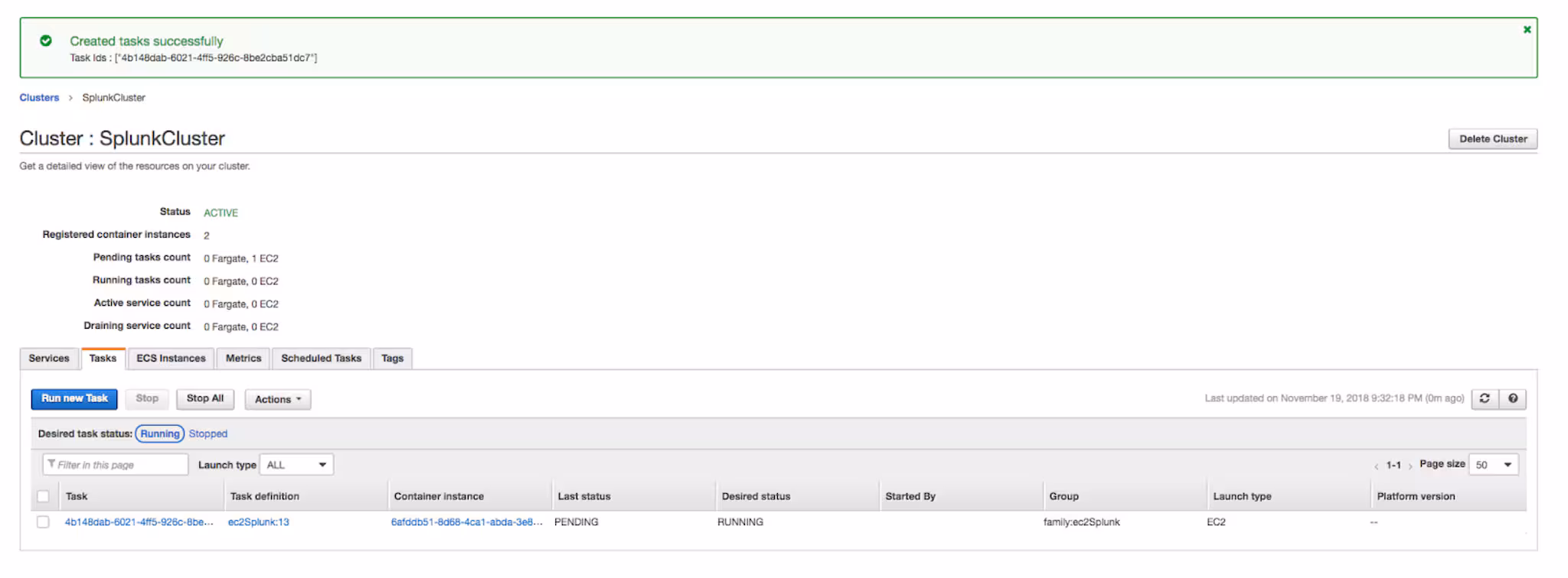

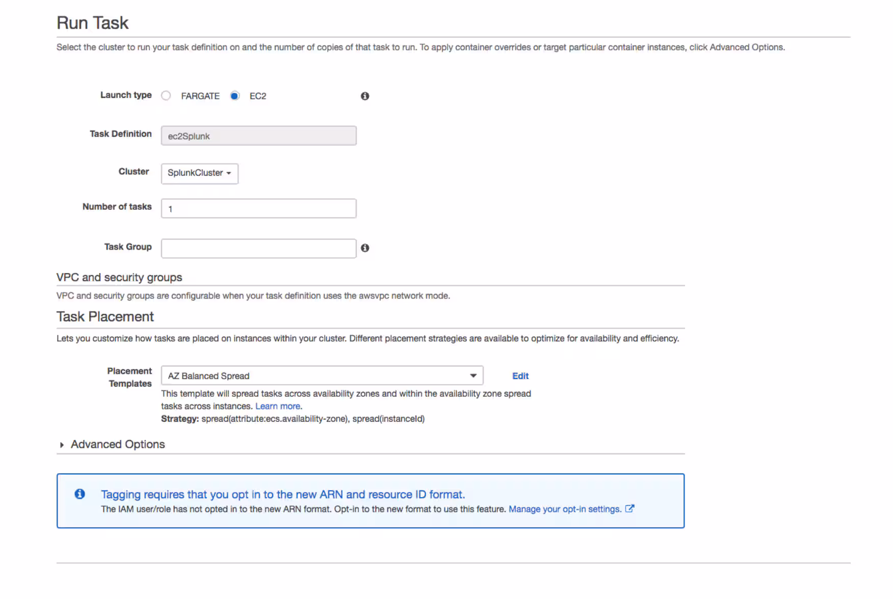

Select the Task (from the Task Definition list), and click on Actions, Run Task.
Select EC2, and the cluster you created earlier and run 1 task only. The Advanced Options lets you override some options such as the Password.
Once done, the container task will run, and Splunk will start up.
