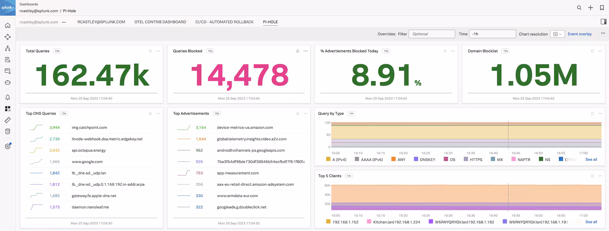

Step 3: Visualize Metrics with Splunk Observability Cloud (Optional)
Now that we've set up the Pi-hole Exporter and OpenTelemetry, we can visualize the metrics in Splunk Observability Cloud.
You can use the following dashboard to visualize the metrics collected by the Pi-hole Exporter and OpenTelemetry which is available to import into Splunk Observability Cloud which can be found here.
For more information on how to import a new dashboard into an existing dashboard group, see here.
