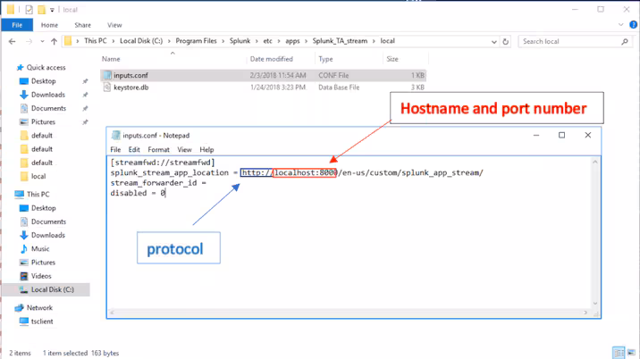

The most important step here is to define your Splunk Stream server (see point 2 above) in your TA’s inputs.conf file. The custom inputs.conf that resides in that app should point to your remote Stream server, as below.
[streamfwd://streamfwd]
splunk_stream_app_location = http://remote_stream_server:8000/en_us/custom/splunk_app_stream/
stream_forwarder_id =
disabled = 0
The following is a screenshot of an installed universal forwarder, with an example config file:
Don't forget to modify the protocol if you're using SSL/TLS on your Stream server.

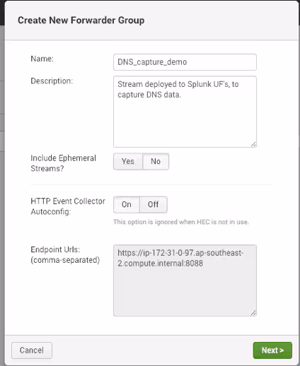

Now you have a stream configured, go to “Distributed Forwarder Management” under the configuration menu and create a new group:
Choose which forwarders to deploy to using regex to define a group, if required.
Now choose which streams to capture under this new group configuration.
