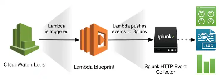

At AWS re:Invent 2016, Splunk released several AWS Lambda blueprints to help you stream logs, events and alerts from more than 15 AWS services into Splunk to gain enhanced critical security and operational insights into your AWS infrastructure & applications. In this blog post, we’ll walk you through step-by-step how to use one of these AWS Lambda blueprints, the Lambda blueprint for CloudWatch Logs, to stream AWS CloudWatch Logs via AWS Lambda and into Splunk for near real-time analysis and visualization as depicted in the diagram below. In the following example, we are interested in streaming VPC Flow logs which are stored in CloudWatch Logs. VPC Flow logs capture information about all the IP traffic going to and from network interfaces, and is therefore instrumental for security analysis and troubleshooting. With that said, the following mechanism applies to any logs stored in CloudWatch Logs.

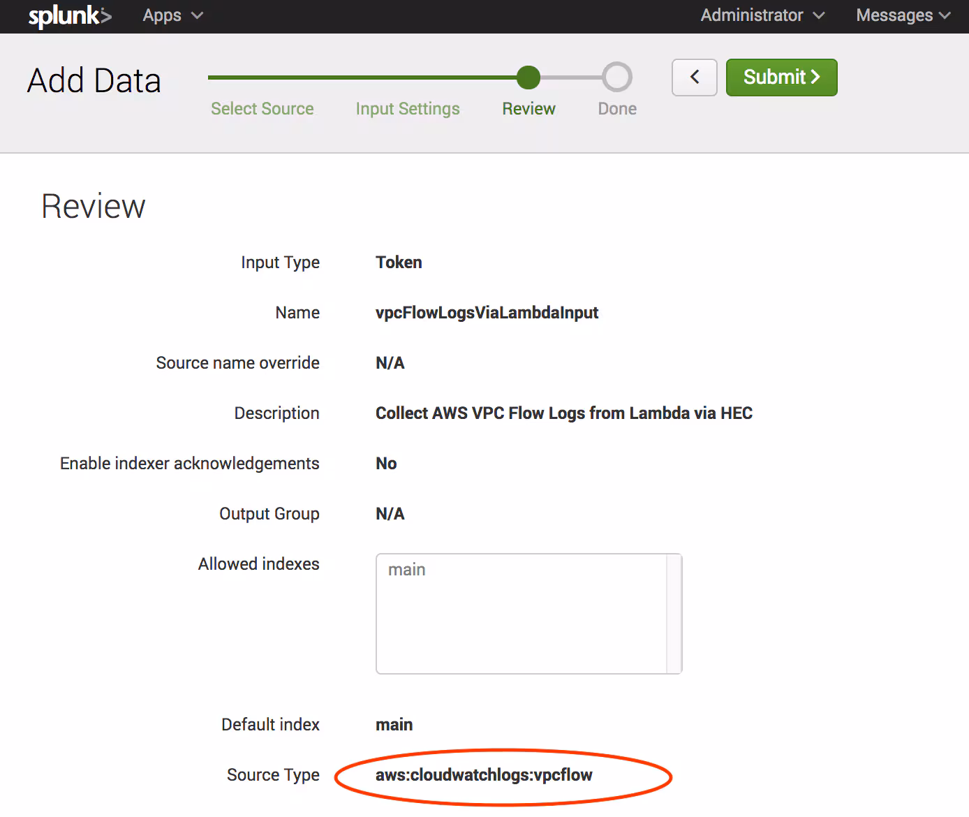

2b. Create an HEC token from Splunk Enterprise. Refer to Splunk HEC docs for detailed instructions.
When configuring the input settings, make sure to specify “awsvpcflow” as sourcetype. This is important to enable automatic fields extractions. Make sure to take note of your new HEC token value.
Note: For Splunk Cloud deployments, HEC must be enabled by Splunk Support.
Here’s how the data input settings would look like:

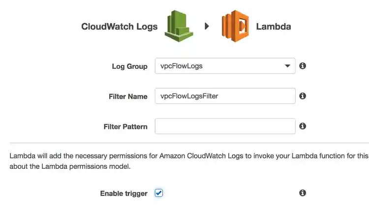

3b. Configure Lambda function trigger. Select ‘CloudWatch Logs’ as trigger if it’s not already selected. Then specify vpcFlowLogs as the log group. Enter a name for ‘Filter Name’, say vpcFlowLogsFilter. You can optionally enter a value for ‘Filter pattern’ if you want to restrict what gets delivered to Lambda. Before clicking ‘Next’, make sure ‘Enable trigger’ is checked. This is an example of how this form would look like:
This is also known as a CloudWatch Logs subscription filter which effectively creates a real-time feed of logs events from the chosen log group, in this case vpcFlowLogs.
Note that, when adding this Lambda trigger from the AWS Console, Lambda will add the required permissions for CloudWatch Logs service to invoke this particular Lambda function.

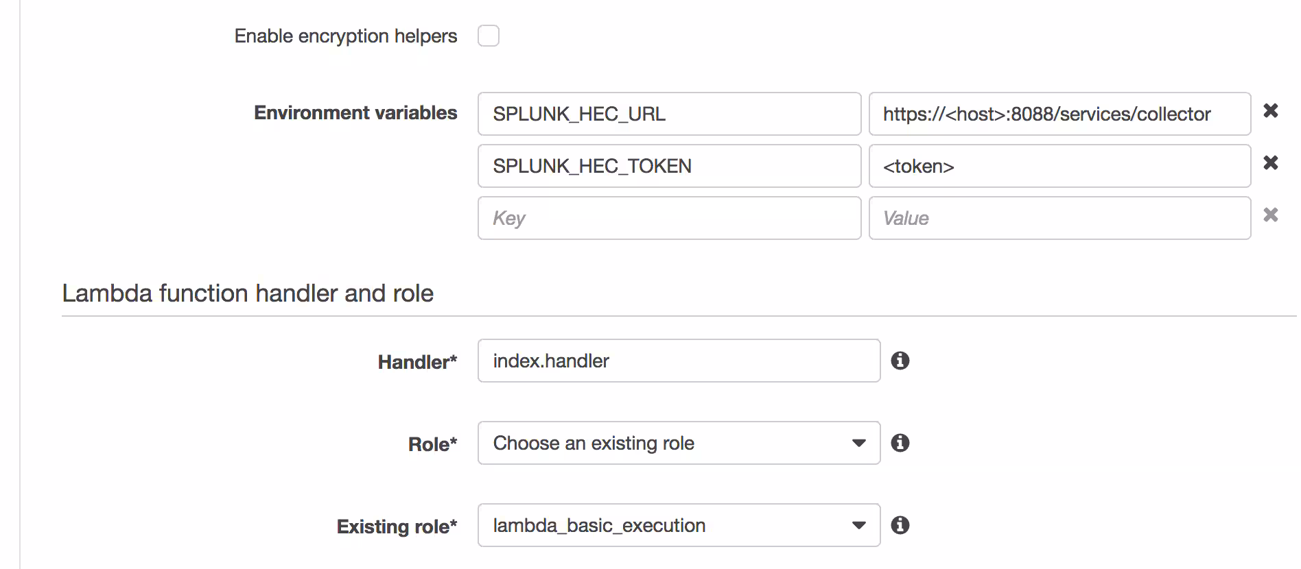

3c. Configure Lambda function. The function already implements the necessary logic to process the CloudWatch Logs data, including decoding it and decompressing it, and breaking the events before sending to Splunk HEC. You’ll need to set the following required parameters:
At the top: specify your Lambda function name, say vpcFlowLogsProcessor
Under function code: fill in Splunk settings under Environments variables as shown in screenshot below, where:
- SPLUNK_HEC_URL is the Splunk URL for HEC endpoint, e.g https://:8088/services/collector where host is your Splunk fully qualified domain name or IP address. Note that default port for HEC is 8088
- SPLUNK_HEC_TOKEN is the token value from HEC input you created earlier
Under function handler and role: in Role, select “Choose an existing role” and then for Existing role, select “lambda_basic_execution” which gives Lambda function minimum required permissions for writing its own logs to CloudWatch Logs.
Note that AWS Lambda encrypts the environment variables at rest using a Lambda service key, by default. Environments variables are decrypted automatically by AWS Lambda when the function is invoked. While not required for the purpose of this set up, you also have the option to encrypt the environment variables before deploying the Lambda function. For more information, see Create a Lambda function using Environment Variables to Store Sensitive Information.
At this point, you can click ‘Next’ after reviewing your Lambda configuration which should look as follows:

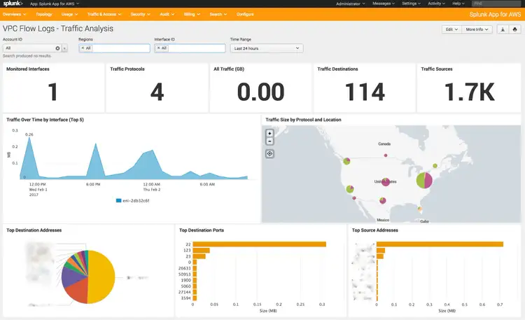

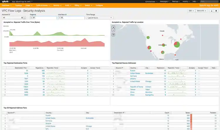

Bonus traffic & security dashboards!
By using Lambda-based data ingestion, not only you can benefit from the simple setup above, but you can also leverage the advanced dashboards & sophisticated traffic & security analysis of VPC flow logs that come with Splunk App for AWS. If you set the correct sourcetype, for example “awsvpcflow” in the case of VPC Flow logs as shown above, then you should see relevant dashboards populate automatically. Once installed, navigate to Splunk App for AWS, and view “VPC Flow Logs: Traffic Analysis” dashboard under Traffic & Access dropdown menu and “VPC Flow Logs: Security Analysis” dashboard under Security dropdown menu:
