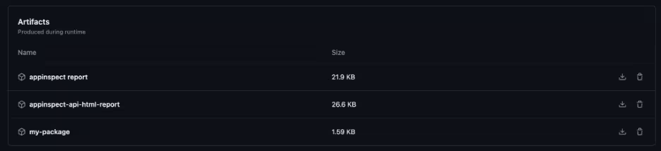

Next, save and commit your changes. After the new action successfully runs, you should have access to the new JSON Splunk AppInspect report.
You can download it, unzip it, and open the JSON file. Reports in this format are intended for code processing but are not really convenient for people to read. So, next, you can try another report format and also use the API version of Splunk AppInspect.

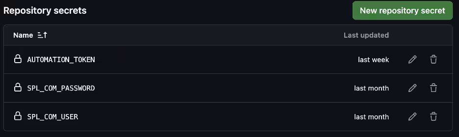

Note, there are two secret variables not yet defined: SPL_COM_USER and SPL_COM_PASSWORD. These will contain your Splunk.com (not your Splunk Enterprise) credentials; your www.splunk.com username and password, respectively.

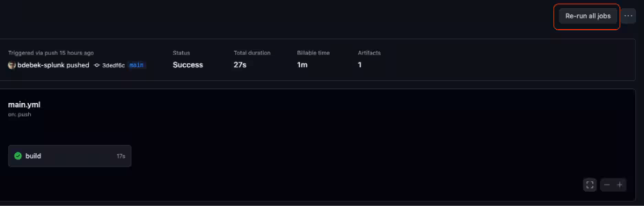

First, save and commit the changes (the job will fail because these credentials were not yet given, but don’t worry about that for now).
Next, go to repository Settings. Under the Security tab, select Secrets and variables then select Actions. On this page, add two repository secrets with corresponding values, for example: Name: SPL_COM_USER, Secret: myusername@email.com. Enter your Splunk.com email address and your password for SPL_COM_PASSWORD.

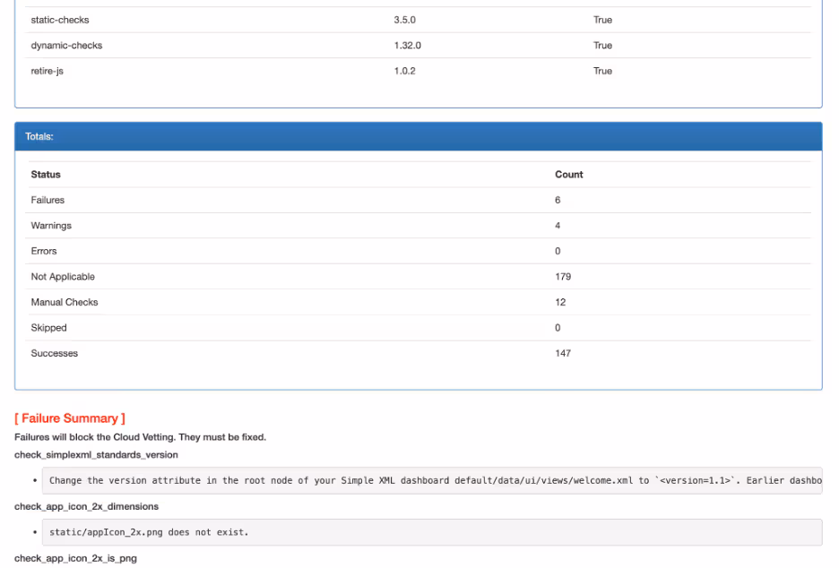

Run the action again to see the results. You should receive the HTML report, which is formatted for easy reading by people.
A workflow job will fail if it encounters an unexpected failure during a Splunk AppInspect check. To make the job ignore failures, create a file .appinspect_api.expect.yaml in the main repository directory. To do this, right-click on the left-hand panel, then select Create file… Add the following code to .appinspect_api.expect.yaml:

- Add it as a secret variable (the same as we added for Splunk username and password), this time naming it AUTOMATION_TOKEN.

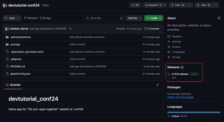

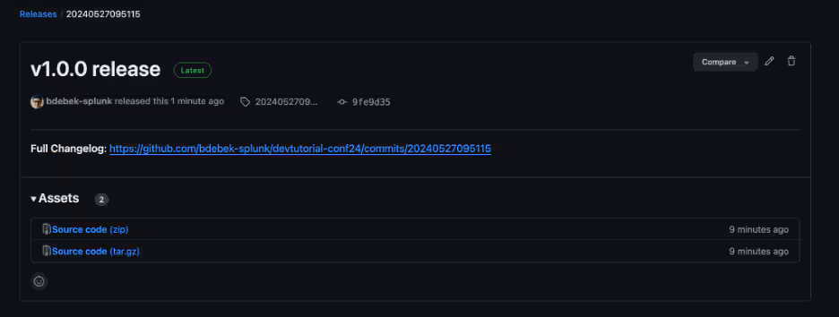

After the pipeline finishes executing, your release should be ready!
You should now see this in your Actions tab:
That's all there is to it for setting up workflows with validation, testing, and release jobs with GitHub Actions. Congratulations!
