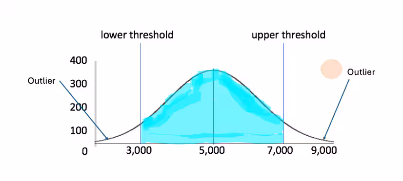

Let’s look at some simple mathematical concepts about the basics of outliers before discussing the main points for this article. The most basic question to ask about an outlier is what is the probability that it will occur? Let’s take a look at a near normal distribution using a sample bell curve.
Note: Credit for the area under the bell curve graph goes to Josh Starmer of StatQuest.
The idea is that the middle of the bell curve represents the mean of all events, while the downward curve away from the middle represents various standard deviations away from the mean. The area under the curve is the probability that an event will occur. Notice as we move away from the colorful area, there is less of a probability the event occurs. These are outliers as their probability for occuring is a small percentage compared to the higher percentage in the colorful area. If this bell curve represents possible values for fraud detection, it is the outliers that are most likely flagged as possible fraud.

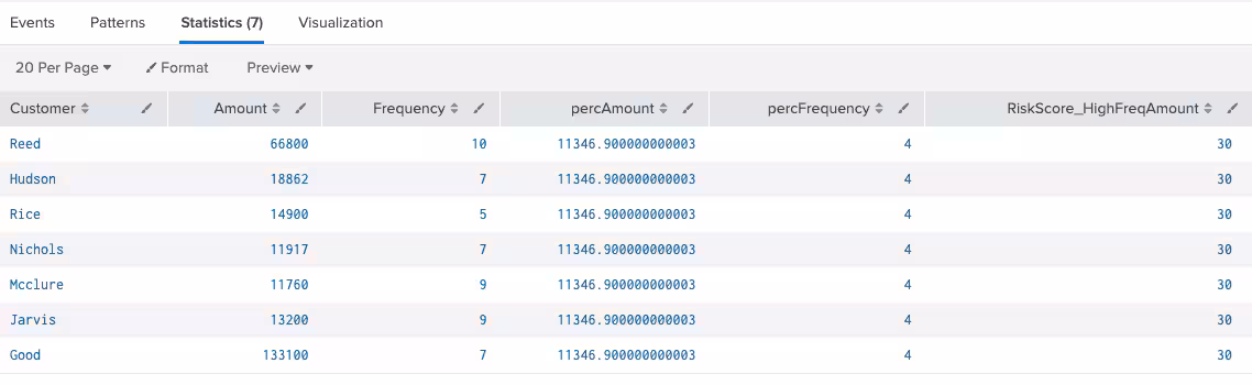

We can build upon the outlier use case and use percentiles to look for indicators of fraud. In Splunk, one can use the eventstats command to find the 90th percentile for any numerical variable for all events. In theory, if the variable’s value is in the 90th percentile, then it is an outlier. If there are two variables of interest, both within the 90th percentile of their respective dataset, then the chances of declaring the event as fraudulent increases. For example, suppose we have transaction data containing total amounts transferred and the frequency of the number of transfers done within a day. If a customer is within 90th percentile of both the total amount transferred and their frequency is also over the 90th percentile, then this looks like suspicious behavior and it should be flagged as such. In SPL, this would look like the following.
index=transactions sourcetype=transfers | eventstats perc90(Amount) as percAmount perc90(Frequency) as percFrequency|where Amount>percAmount and Frequency>percFrequency |eval RiskScore_HighFreqAmount=30 | table Customer Amount Frequency percAmount percFrequency RiskScore_HighFreqAmount
An arbitrary risk score is added to the end to send to a risk index for further processing. For the purposes of this example the risk score is arbitrary, but your risk score in real life is based on your own usage and normalization techniques according to what suits your use case. In this example, all customers who are over the 90th percentile for amount and frequency are flagged. Because the amount can be magnitudes larger than the frequency value, we can use the log function to bring the amount value within the same magnitude as the frequency. There are other ways to do this such as using a StandardScaler function in machine learning, but we will keep it simple by using log here.
index=transactions sourcetype=transfers | eval Amount=log(Amount)|eventstats perc90(Amount) as percAmount perc90(Frequency) as percFrequency|where Amount>percAmount and Frequency>percFrequency |eval RiskScore_HighFreqAmount=30 | table Customer Amount Frequency percAmount percFrequency RiskScore_HighFreqAmount
Now, the Amount field is at a more reasonable magnitude, but the results are the same. Let us move on to what could be a better way to look for an outlier.

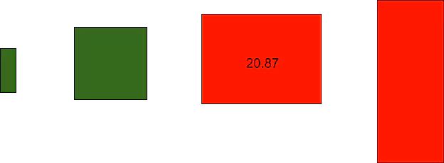

We know the area of the rectangle is length times width. What if we view our two variables as measurements and the multiplication of the two produces a virtual area? In this case, we multiply the log(Amount) by the Frequency. This produces the virtual area and we can use the lowest possible 90th percentiles to find the lowest possible area such that the two numbers multiplied stay within the virtual area, in which case this is still considered an outlier. Let’s continue this with our example to get the minimum area that uses the 90th percentile of both variables.
index=transactions sourcetype=transfers |eval Amount=log(Amount)|eventstats perc90(Amount) as percAmount perc90(Frequency) as percFrequency|where Amount>percAmount and Frequency>percFrequency |eval area = Amount * Frequency|stats min(area) as min_area
With this in mind, can we assume that any combination of Frequency * Amount that is greater than 20.87 can be considered suspicious, because our training dataset told us this involved numbers from each variable in the 90th percentile? If so, then, we no longer need to use 90th percentiles to find possible fraud. We can now say that any virtual area less than 20.87 will be dismissed, but if any combination of Frequency * Amount is greater than that number, it will lead to a risk score. This heuristic is different from the previous one, but it allows for an easier calculation such that an extreme value in just one variable will not skew the results. Our new search will be as follows.
index=transactions sourcetype=transfers | eval Amount=log(Amount)|eval area=Amount * Frequency|where area > 20.87|eval RiskScore_HighFreqAmount=30 | table Customer Amount Frequency area RiskScore_HighFreqAmount|sort - area
The first thing to notice is that the search is simpler. It’s based on any measurement greater than the virtual area is considered suspicious. The next thing to notice is one more customer (English) was listed here as their original measurements were not both above the 90th percentile, but the combination of the two variables is enough to go over our threshold.
Why bother to do this? Think about the case where one variable is almost at the highest percentile while the other variable is at the 89th percentile. If we were simply comparing to see if both variables were above the 90th percentile, which in this case they are not, we would miss the potential outlier. However, the multiplication of both variables easily surpasses our boundaries for a risk indicator. This allows us to be more flexible in discovering possible fraud as one variable may be close to a threshold, while another easily surpasses it.
Visually, any rectangular shape can be used to compute the logical area to see if it is above a threshold.
Any combination that increases the area beyond our threshold will be given a risk score.

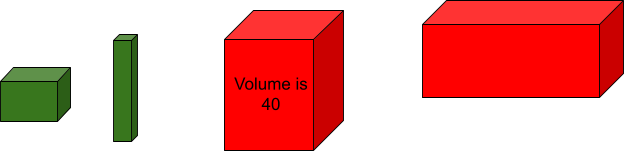

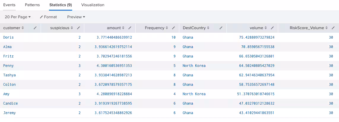

What if we used three variables instead of two? We’ll use wire transfer data in the next example and add a suspicious country score. All countries will get an initial score of 1 and if they are suspicious, they will get a score of 2. A really suspicious country will get a score of 3. Our formula will now be amount * Frequency * suspicious. This will compute a virtual cubic volume. If the virtual cubic volume is over a predefined threshold, this entity should get a risk score just like we did before. In the next SPL example, we artificially provide a suspicious risk rating using a case statement for each Country in the dataset with a default rating of 1. (The assignment of 1, 2, and 3 could have been done in any way preferred by the writer of the SPL as this example is just for illustration.)
index=transactions sourcetype=wire_transfer |eval amount=log(amount) | iplocation destIP|rename Country as DestCountry|eval suspicious = case(DestCountry=="United States", 1, DestCountry=="Ghana", 2, DestCountry=="North Korea", 3, 1=1, 0) |eval volume=amount * Frequency * suspicious| where volume > 40| eval RiskScore_Volume=30| table customer, suspicious, amount, Frequency, DestCountry, volume, RiskScore_Volume |sort - volume
The new things in this search are the use of iplocation to find the country name of the destination IP address, the use of the case function to assign scores to countries, and finally using a virtual volume to look for suspicious behavior. In deployment, instead of using a case function, it is better to use a lookup to determine the risk rating as there are over 200 countries in the world. The use of 40 is an arbitrary predetermined threshold of fraud. We could have used the percentile method from above to show all events that had where Frequency>p_Frequency and suspicious>=p_suspicious and amount>p_amount to help compute the threshold, but my dataset was not aligned to the point where events had all 3 variables in the highest percentiles at the same time. That is why I arbitrarily chose 40 as the threshold after examining some of the highest values of these variables. This threshold should be fine tuned over time with more training data. One could argue that using three variables instead of two can lead to less false positives, if a proper threshold is used. Visually, this method can be shown with these sample cubes.
