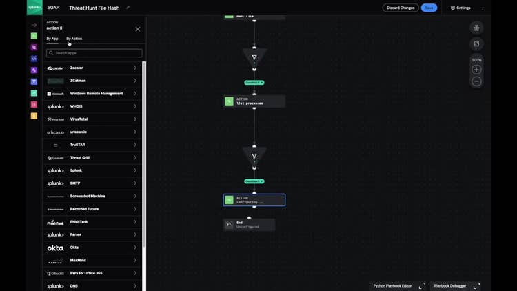

Customizing the Playbook
  1. From the Playbook screen, search for the “Hunting” prebuilt playbook and open it.
  2. Select the “Hunt File” action block and adjust The hash* field under “Inputs” to “fileHash”
  3. Add a filter block and set the parameter to hunt_file_1 > device_count. Select the “Greater than” condition and set the specified value to 0.
  4. From this filter, add an action block to “list processes” and adjust the ioc* input to “filter_1 > hash” and the id* to “filter_1 > device_id.”
  5. Add an additional filter to the previous action blog with the settings “list processes_1 > process_count. Select the “Greater than” condition and set the specified value to 0.
  6. From this filter, add an action block to “get process detail” set the process_id* value to “filter_2 > process_id.”
  7. Save this custom playbook
