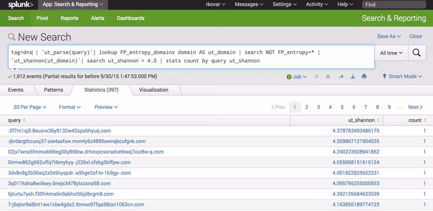

Domains:
tag=dns
| `ut_parse(query)`
| lookup FP_entropy_domains domain AS ut_domain
| search NOT FP_entropy=*
| `ut_shannon(ut_domain)`
| search ut_shannon > 4.0
| stats count by query ut_shannon
With this search we are looking at Common Information Model (CIM) compliant DNS queries via the “tag” field, but you could run this against Stream, Bro, or Host DNS sourcetypes. You could even run this against an http request from a proxy log if you wanted. Then (as discussed above) we remove any false positives by adding those domains to a “FP_entropy_domains” lookup table. Following that step, we then calculate the level of entropy in the field “ut_domain” (which is the base domain of the query that ut_parse created earlier). Finally, we tell Splunk to only display domains (ut_domain) that have an entropy score higher than 4.0. This is an arbitrary score that I created for this data set, but may need to be adjusted for your environment (lower means more false positives and higher means more false negatives). Try to find the crossover error rate (CER) that works best for your network!

This is identical to the above search but instead of looking for domains with high entropy, we are looking for SUB domains with high entropy. You could also have some fun by combining the dynamic DNS lookup table from my last blog post with this search! That would be especially good at finding APT malware that is beaconing home to dynamic DNS providers.
