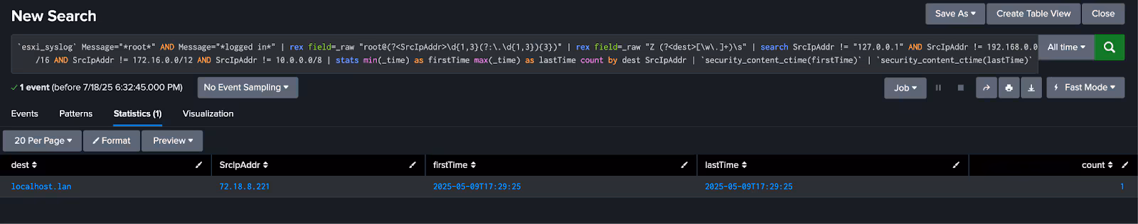

External Root Login
This identifies instances where the ESXi UI is accessed using the root account instead of a delegated administrative user. Direct root access to the UI bypasses role-based access controls and auditing practices, and may indicate risky behavior, misconfiguration, or unauthorized activity by a malicious actor using compromised credentials.
`esxi_syslog` Message="*root*" AND Message="*logged in*"
  | rex field=_raw "root@(?\d{1,3}(?:\.\d{1,3}){3})"
  | rex field=_raw "Z (?[\w\.]+)\s" | search SrcIpAddr != "127.0.0.1" AND SrcIpAddr != 192.168.0.0/16 AND SrcIpAddr != 172.16.0.0/12 AND SrcIpAddr != 10.0.0.0/8 | stats min(_time) as firstTime max(_time) as lastTime count by dest SrcIpAddr | `security_content_ctime(firstTime)` | `security_content_ctime(lastTime)`
Figure 3: External Root Login

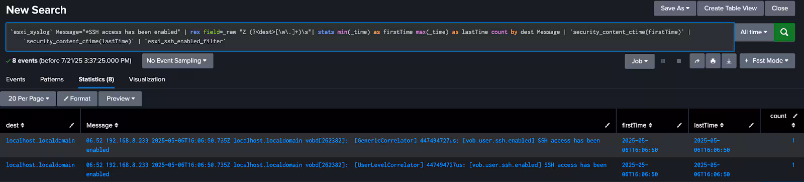

SSH Enabled
This detection identifies SSH being enabled on ESXi hosts, which can be an early indicator of malicious activity. Threat actors often use SSH to gain persistent remote access after compromising credentials or exploiting vulnerabilities.
`esxi_syslog` Message="*SSH access has been enabled"
  | stats min(_time) as firstTime max(_time) as lastTime count by dest Message
Figure 6: SSH Enabled

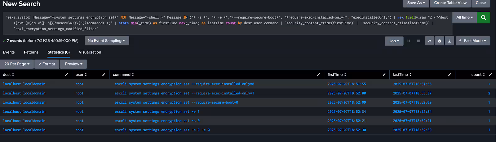

Encryption Settings Modified
This detects the disabling of critical encryption enforcement settings on an ESXi host, such as secure boot or executable verification requirements, which may indicate an attempt to weaken hypervisor integrity or allow unauthorized code execution.
`esxi_syslog` Message="*system settings encryption set*" NOT Message="*shell.*"
  Message IN ("* -s *", "* -e *","*--require-secure-boot*", "*require-exec-installed-only*", "execInstalledOnly")
  | rex field=_raw "Z (?[\w\.]*)\s.*\]: \[(?\w+)\]:(?.+)"
  | stats min(_time) as firstTime max(_time) as lastTime count by dest user command
Figure 7: Encryption Settings Modified

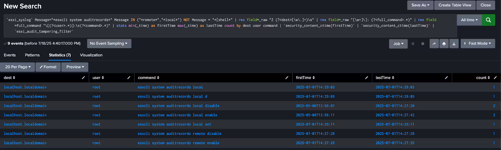

Audit Tampering
This detection looks for the use of the esxcli system auditrecords commands, which can be used to tamper with logging on an ESXi host. This action may indicate an attempt to evade detection or hinder forensic analysis by preventing the recording of system-level audit events.
`esxi_syslog` Message="*esxcli system auditrecords*" Message IN ("*remote*","*local*") NOT Message = "*[shell*"
  | rex field=_raw "[\w+]\]: (?.*)"
  | rex field=full_command "\[(?.*)]:\s(?.*)"
Figure 9: Audit Tampering

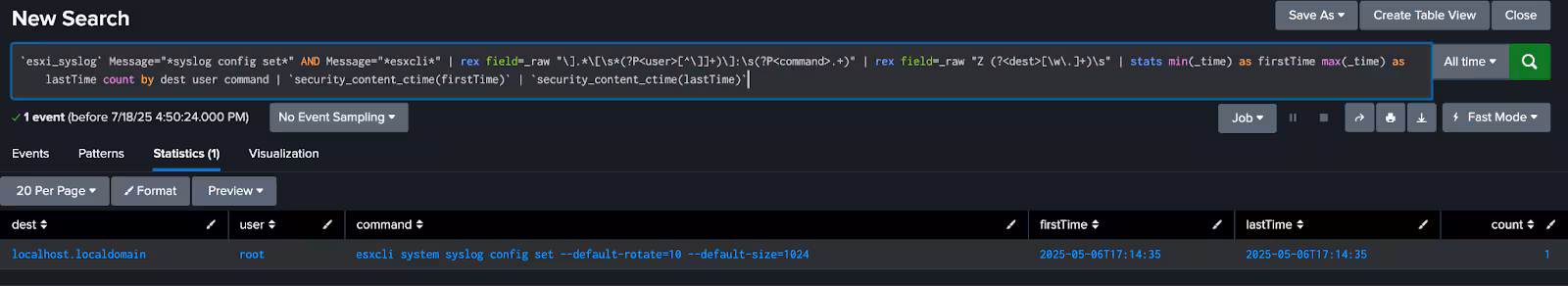

Syslog Config Change
This one detects changes to the syslog configuration on an ESXi host using esxcli, which may indicate an attempt to disrupt log collection and evade detection.
`esxi_syslog` Message="*syslog config set*" AND Message="*esxcli*"
  | rex field=_raw "\].*\[\s*(?P[^\]]+)\]:\s(?P.+)"
Figure 10: Syslog Config Change

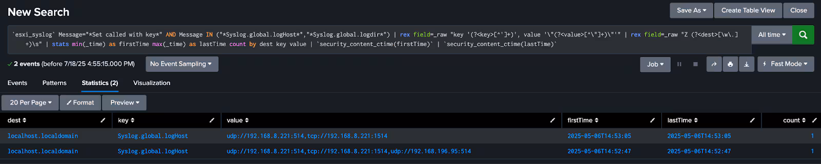

The loghost or logdir keys can also be monitored directly. This detection identifies changes to these configurations on an ESXi host, which may indicate an attempt to disrupt log forwarding and evade detection.
`esxi_syslog` Message="*Set called with key*" AND Message IN ("*Syslog.global.logHost*","*Syslog.global.logdir*")
  | rex field=_raw "key ''(?[^'']+)'', value ''\"(?[^\"]+)\"''"
  | stats min(_time) as firstTime max(_time) as lastTime count by dest key value
Figure 11: Loghost Key Monitoring
