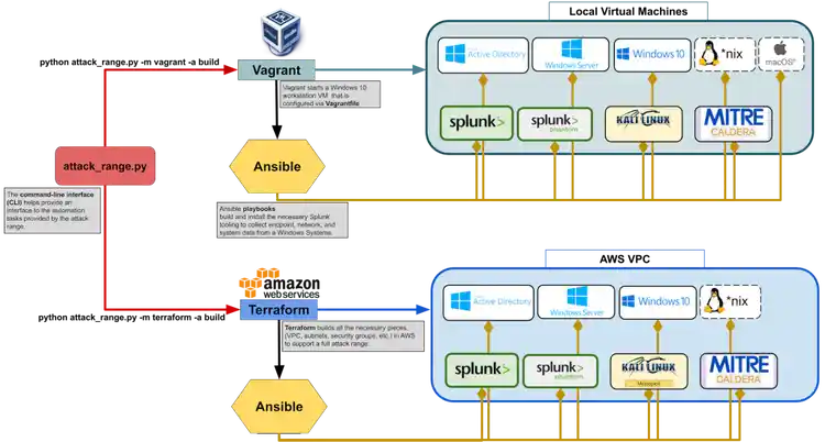

Before we dig into building a range, let's discuss some of the intents of the project and how it is wired together 🔌. More specifically talk about the difference between Vagrant and Terraform mode. The has been built with the intent to automatically 🚀 test the detections of the Splunk Threat Research team and those contributed by the community to the security-content project. The Attack Range project is mainly composed of 3 major parts.
  1. The attack_range.py CLI — used to build, destroy, test and simulate attacks
  2. A virtualization platform — right now we support Vagrant for local dev builds and Terraform for longer running sharable attack_range environments.
  3. Ansible playbooks — contains the orchestration logic that configures the built environment.
At a high level, the attack_range architecture looks like this:
We will be leveraging the Terraform mode and constructing our range on an AWS VPC. We recommend to use this mode by default for a few reasons, but primarily because you can run a more complex complete environment on AWS EC2 versus your local machine. Currently, Vagrant local execution limits the size of the environment to the number of resources your local machine has. In a typical MacBook Pro with 16GB of ram, you are limited to successfully running a range with a domain controller or windows client and a Splunk server. Adding any more instances like a kali Linux attacking server, or multiple windows domain controllers joined by a domain will cause you to run out of memory.

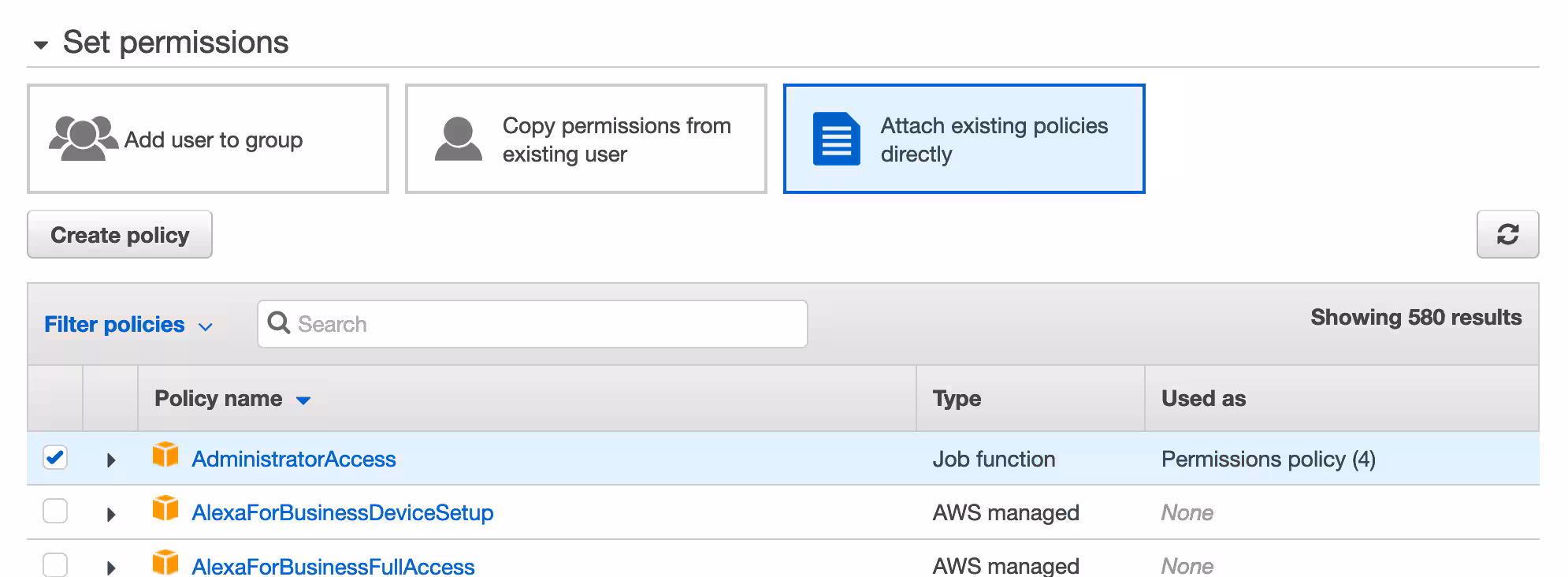

After all the dependencies are installed we need to generate an AWS Key Pair in your desired region. To do this run the following command:
ssh-keygen
This will create two files: a private key under ~/.ssh/id_rsa and the public key ~/.ssh/id_rsa.pub next import the id_rsa.pub publike key into AWS, you can simply follow the instructions provided by AWS here to accomplish this. ⚠️ Make note of the key name you will need it in a second, in the attack_range documentation we default to attack-range-key-pair as the name. While in AWS make sure you create a user with programmatic credentials.
Provide this new user EC2 administrative access and save the access key ID and secret access key.
Next back in the Ubuntu server to configure our newly created AWS credentials run:
aws configure
You will be prompted to provide the access key ID and secret access key as well as your default region, make sure all these match your previous choices. You are doing awesome! We are almost done 😁. Finally, edit attack_range.conf and set your key name, region, and verify your private key path. It is worth reviewing some of the major configurable parts 🧰 of the attack range. The attack range allows you to:

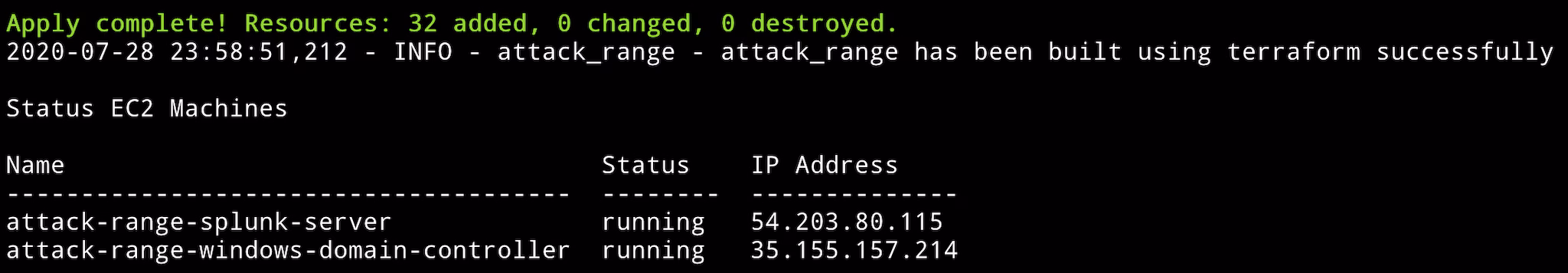

Once you are happy with the configuration run the build command:
python attack_range.py --mode terraform --action build
The typical build takes roughly 11-15 minutes (about 30 mins if installing Splunk Enterprise Security), this might be a good time to grab ☕️. If all went well at the end you should see a list of your machines like below:
If you have made it this far you have now built your first attack_range 🎉. Explore each machine by connecting directly to them. For Splunk use a browser and open http://<splunk_server_ip>:8000. For the windows server use an RDP client to connect to port 5389 and authenticate with the user name and password configured in attack_range.conf. Now that you have a fully running attack_range and have made yourself familiar with the environment lets launch our first attack!

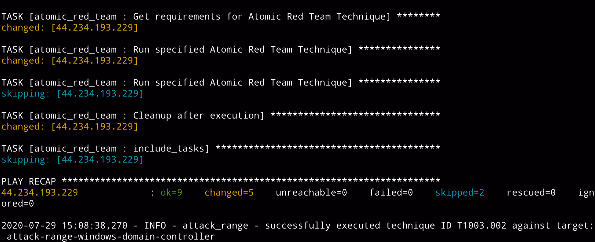

python attack_range.py -m terraform -a simulate -st T1003.002 -t attack-range-windows-domain-controller
A few things happen when simulating a technique under the hood. The attack_range installs the Atomic Red Team execution framework to the target machine. It grabs all the available attacks AKA “atomics” that correspond to a specific MITRE Technique from the Splunk fork. By default, the attack_range is configured to download the atomics from our Splunk fork 🍴. There are three atomics under T1003.002 Security Account Manager:
Each of these three different ways of obtaining the “credential material from the Security Account Manager” is executed on the target host. Once the simulation is completed you should see the following output:
You have executed an attack simulation against a windows domain controller 😈 ! Now let's review what kind of data we gathered from this attack and specifically how to detect it. First, we need to go back to the Splunk server. If you ever need to see what machines are running just execute:
