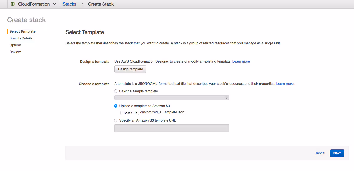

From the AWS CloudFormation console, create a new stack and upload the auto_hec_conf_website_template.json. Click “Next”.

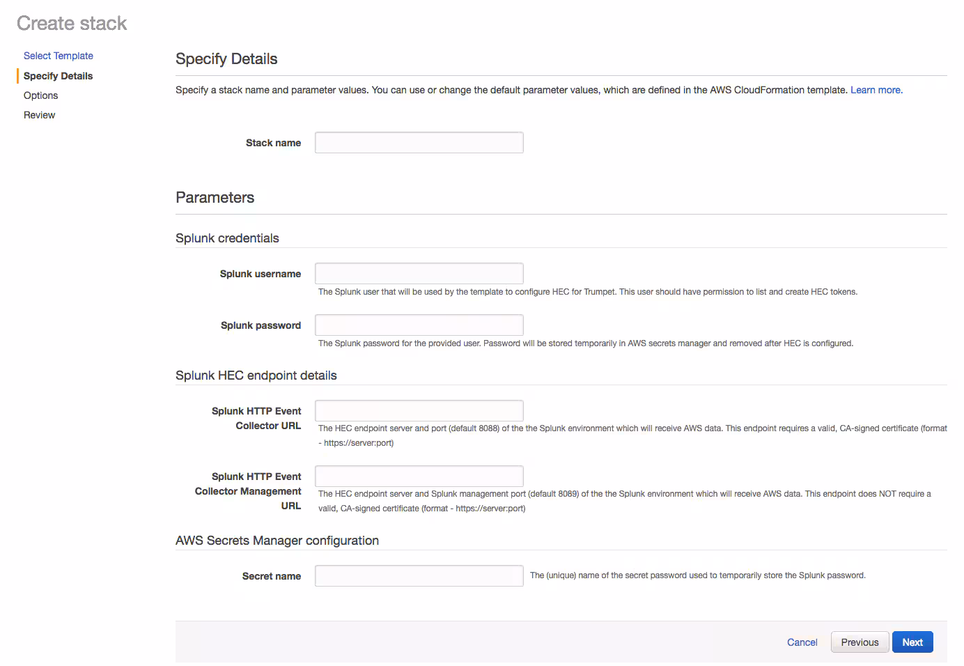

On the “Specify Details” page, you should provide the requested parameters. Provide a CloudFormation “Stack name” of your choice. As mentioned previously, the Splunk HEC endpoint must have a valid (not-self signed) certificate installed for the HEC port. The management URL may be the same as the HEC URL, but the port will be different. As a workaround, the HEC endpoint can be an AWS ELB (with a valid certificate), or other load balancer that terminates SSL and forwards to the HEC endpoint. Note that the Management URL can use a self-signed certificate.
You will need to provide a valid username/password combination for the Splunk endpoint, as well as secret name of your choice for the AWS Secrets Manager configuration.
If providing Splunk authentication details and/or having the the Splunk management port open while the template runs isn't possible, the manual HEC token version of the template is also an option. If using this alternative, you'll create HEC tokens on the Splunk endpoint manually and then provide those tokens to the template later on. This option does not remove the requirement for a valid certificate on the HEC endpoint mentioned earlier—this requirement comes from the AWS Kinesis Data Firehose integration.

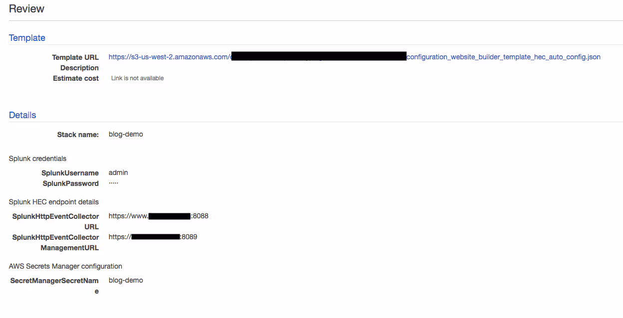

Once you have provided all the parameters, click “Next” to continue.
You will not need to configure any Tags, Permissions, Rollback Triggers, or any options from the Advanced Settings. Click “Next” to review.
Acknowledge that AWS CloudFormation might create IAM resources while deploying this stack, then click “Create.”

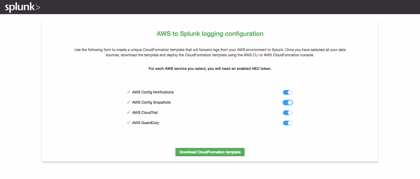

In this configuration site, select each AWS service that you'd like to send data from to Splunk. Once done, click “Download CloudFormation template”—this will create and download a customized CloudFormation template with your selected settings that is ready to deploy.
The AWS to Splunk logging configuration site runs entirely local to your browser, so there's no outbound communication other than the loading of static resources. Creation and download of the customized CloudFormation template is handled with browser-side JavaScript.

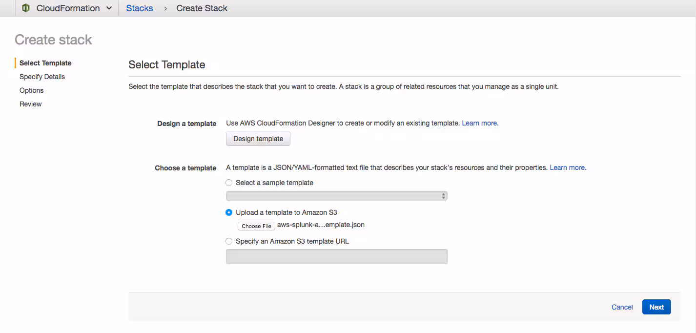

To deploy the downloaded custom template from the AWS CloudFormation console, click “Create Stack,” and upload the downloaded template. Then click “Next.”
Click “Next” and name your stack. Click “Next” again. You won't need to configure any Tags, Permissions, Rollback Triggers, or any options from the Advanced Settings. Click “Next” to review, then acknowledge that AWS CloudFormation might create IAM resources while deploying this stack.
