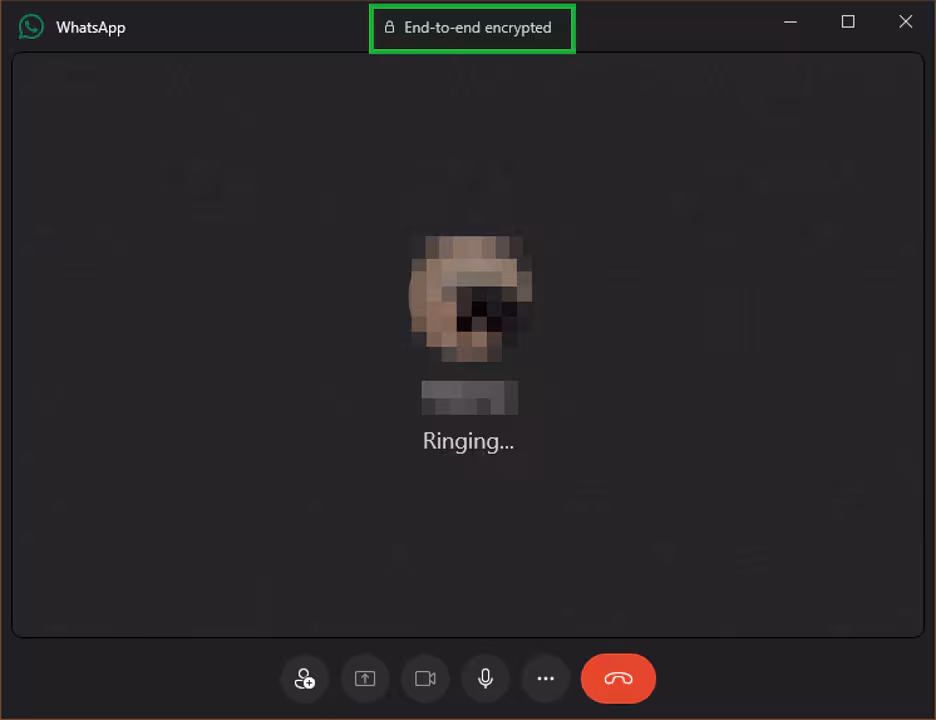

You’ve probably seen the end-to-end encryption option on WhatsApp. That means that only you and the person you’re talking to can read the messages. Not even WhatsApp can see them.

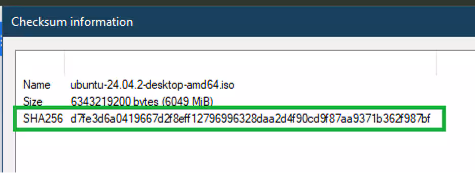

For example, I used 7-Zip to calculate the SHA-256 hash of a file named ubuntu-24.04.2-desktop-amd64.iso. Here’s how:
- Open the 7-Zip File Manager from the start menu
- Right-click on the file you want to hash
- Choose CRC. Then I click on SHA-256 options
7-Zip scanned the file and created this unique code:
This feature is not built into the file. The tool reads the file’s contents and generates the hash for you.
You can now compare this hash with the one published on Ubuntu’s official website. If they match, the file is safe. If not, the file may have been damaged or altered.

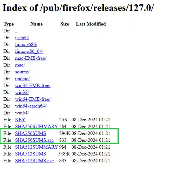

For example, when you download Firefox from Mozilla’s official archive, you’ll find two extra files in the same folder as the installer:
- SHA256SUMS file contains hash values for the installer files.
- SHA256SUMS.asc files has the digital signature of that hash file.
These files help users verify the integrity of the download. If someone tampered with the installer (like adding malware), the hash would no longer match. The digital signature confirms that the hash file itself hasn't been tampered with.
This process makes sure that what you downloaded is safe, unchanged, and really from Mozilla not from a hacker or a fake copy of the site.

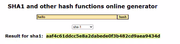

I used an online tool to create the SHA-1 hash code for the string “hello.” Here’s how it looks:
Git also used SHA-1 to identify commits and track changes in code repositories. But it has now been updated to a more secure algorithm (SHA-256).
