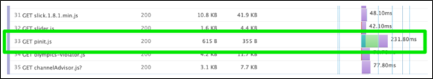

Let’s see an example. The browser is loading a page and needs to request the resource https://stats.example.com/js/pinit.js. To do this, it first must make an HTTP connection to the domain stats.example.com. If the browser already has an HTTP connection to the domain, the existing connection can be used, otherwise a new connection is created.
To do this, the browser first makes a DNS lookup for stats.example.com. In the screenshot below, you can see the request for pinit.js:
This resource was discovered later in the waterfall and the JavaScript file is located on another domain, separate from the domain of the base HTML page. An existing HTTP connection does not exist, so a DNS lookup occurs, shown as the dark green section of the resource bar in the waterfall. This takes approximately 40ms, though DNS lookups can take tens or even hundreds of milliseconds, depending on circumstances like network connection or the number of DNS servers that need to be contacted.

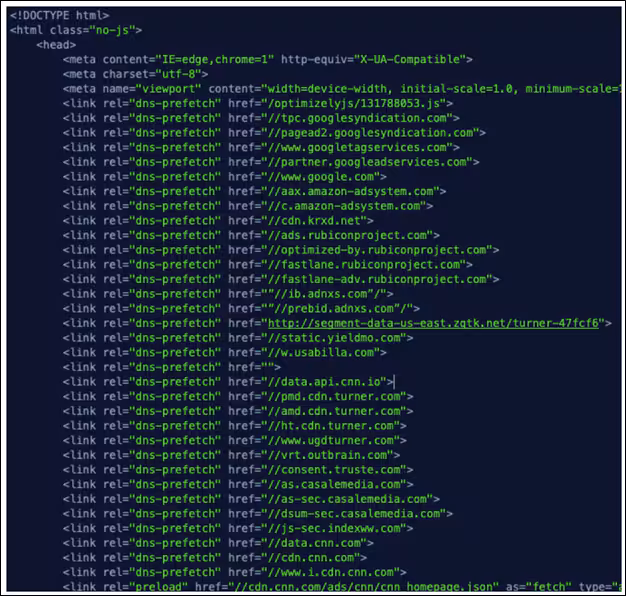

You can see this thinking in the wild. For example, here is a major news site, making 33 DNS prefetches:
Remember that each type of resource hint asks the browser to override which tasks it would normally perform. Using an excessive number of DNS prefetches can lead to performance issues since browsers place limits on the number of outstanding DNS requests they will maintain. Using DNS prefetch to force a DNS lookup is “using up” an available slot that the browser could otherwise use for a DNS lookup the browser knows it needs. Making too many DNS prefetches, or doing a DNS prefetch for a domain that ultimately is not used, creates resource contention and can make the browser operate inefficiently.
