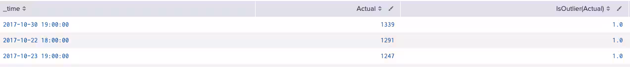

Before you can use the density function, you must fit the density function algorithm against your traffic volume field (i.e. “Actual”) to create the model.
The model acts as a relationship mapper, and it needs to be applied against unseen datasets in order to determine anomalous behavior. You can use a model that has already been built by using the apply command.
The apply command will generate a new field called “IsOutlier(Actual),” which will determine whether the model believes that the “Actual” value is anomalous at that point in time.

False alerting can be one of the biggest drawbacks of using the density function to create adaptive thresholds. These false alerts may not be statistically false, but they may be too sensitive for the general business use case, and it may be alerting too much to provide any real value. Luckily, this can be adjusted by changing the sensitivity of your model.
For example, when you apply the model, you will get a new field called “IsOutlier(Actual),” which will have a binary 1/0 value. You can change the sensitivity by modifying the limits that create this value, which will maintain the integrity of the model while reducing the false alerts associated with it.
