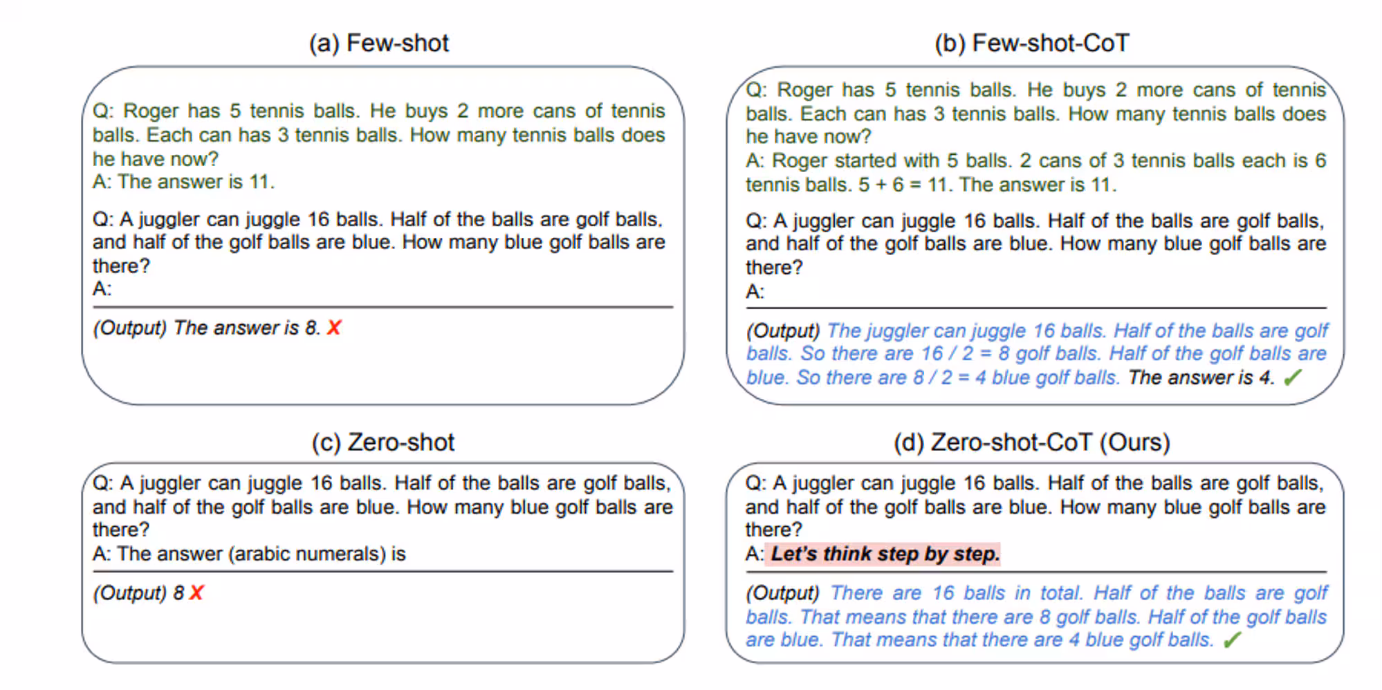

In this case, you may simply need to ask the LLM to follow a step-by-step chain of thought prompting process. Ultimately, this is similar to zero-shot prompting but following a CoT approach.
An example of this is shown below, where researchers simply ask the model to “think step by step” as part of the zero shot prompt query in Box C, on the lower-left side:
