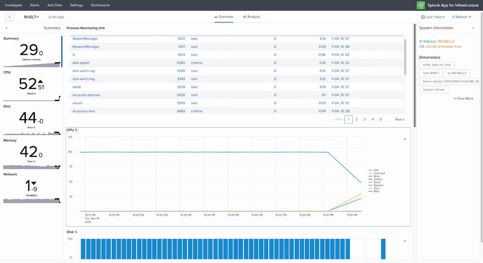

If all goes well, you will see new entities appear within about 5 minutes. You can keep an eye on the bottom of the Add Data page, which will refresh every minute.
Or you can go to the Investigate menu option at the top of the screen and look for new entities in the list. You can also see the current status, last time data was collected from each entity, and the dimensions for each entity.
